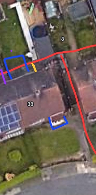

See attached diagram. The purple shows next doors extension. The blue shows our proposed extensions - front and back. The yellow is the proposed branch from the blue lead pipe. Clearly if I were to replace the whole pipe to the pavement it's gonna get costly, and the extension is maxing our budget out as it stands. And would we be obliged to also replace our neighbors pipes on the same main going right? Or could I just put a lead connector on there and leave theirs in situ? I believe the main runs under next doors side alley to get to the front - the pavement stop tap is over to his side. So I might be faced with digging his path up? He's in his late 80s and I'd rather not do this!
It's a crap situation!

probably not so bad if you have hard water, I believe that coats everything with limescale and will help limit lead leaching into the tap water. still far from ideal.
is the whole pipe from the street lead ? it would be very costly getting all that dug out and replaced and trying to do it with neighbours would be a nightmare - goodluck
Cost should not be great we have always moved them as footings are dug so just the cost of a length of mdpe.
What happens under your neighbours is not your problem.
