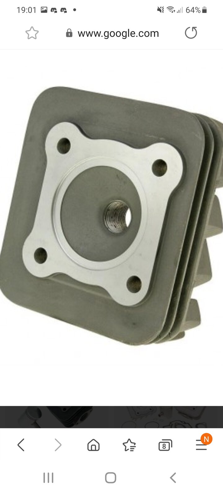

I've built a few engines with no head gasket by design, all were 2 strokes.
Very odd but that's how they were made!.
Did they have a raised flange on the block and a mating groove in the head ?
The barrels are flat, the PX has a raise sealing surface but the Zip just has a flat machined surface (no exhaust gasket either!).

Usually for high performance engines, maybe? The only one I've seen was on a racing JLO and that was ages ago......lapping the faces in with fine valve grinding compound was the order of the day.
John :)
I genuinely don't know why they chose not to use a head gasket, can't cost that much.
The PX 125/ 200 is quite a unique engine to be fair so probably did it just because they could!, that's Italians for you.
Just my own thoughts and based on no facts or research whatsoever.....
The head gasket is obviously the weakest part of cylinder head design and taking it out removes this item for failure. As high performance engines often run on a maximum ignition advance (and didn't used to be adjustable over a certain RPM) the inclination to 'pink' would put the gasket under even higher stress so leaving it out may improve reliability.
John :)
This is a PX, in all the high performance watercooled motorcycles I've worked on (200+ bhp per litre) they all have MLS headgaskets. I just think it's a quirk with some older designs.
Weirdly all the none head gasket engines all have base gaskets!.
