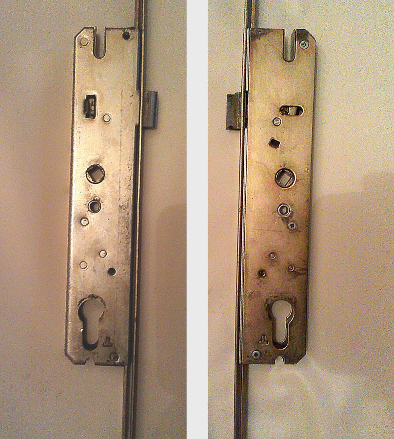

I'm having a real headache with the Multipoint door lock on my UPVC external door. The Multipoint door lock has failed and I need to replace it.
However. It seems it's so old, the mechanism that needs to be replaced is now obsolete.
The locking strip states MACO but there is no serial number.
Rather than have a new door fitted I would like to try and replace the Multipoint Gearbox mechanism. Just the Gearbox if I can help it.
Please see attached :
MACO_MULTIPOINT_DOOR_GEARBOX_28_92.pdf
This is the gearbox with the strip that runs up and sown the door removed. If you want details of this strip all I can say is that it is 16mm and has x4 rollers. i can get pictures if needed. I think I only need the gearbox since that is what has failed but it may be that I need the whole kit.
I have been in touch with quite a few online specialist stockists and a couple of gearbox types have been suggested but I am unsure if they would be suitable because they are not exactly the same. I'm worried that if I spend out on the gearbox online I will only have the problem of having to send it back and I dont want that hassle if i can help it.
If anyone has any ideas please let me know. I would be very grateful for any advice.

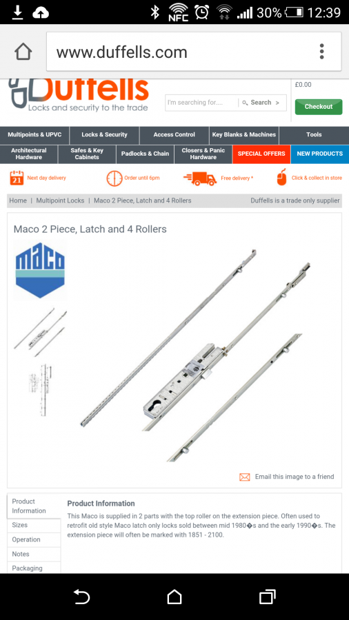

Thanks for your reply.
After an extensive search and some research I ended up actually buying that very lock kit. I havnt fitted it yet. I hope it works out.
Since you have also recommended this kit I have hope.

The Maco 2 Piece, Latch and 4 Rollers (MA1003)
http://www.duffells.com/products/Maco-2-Piece-Latch-and-4-Rollers-28524.aspx
...worked a treat. Looks like my re-assembling the lock worked out ok (after 'the opening it up' and turning the latch round - almost ruining the lock) and cutting the strip down to the right size also went well. The Keeps on the door frame had to be moved around and for some reason the actual hole in the door where the barrel lock goes through had to be modified a bit so that it lined up properly with the gearbox. Probably because of a few slight differences in the gearbox (old vs new).
