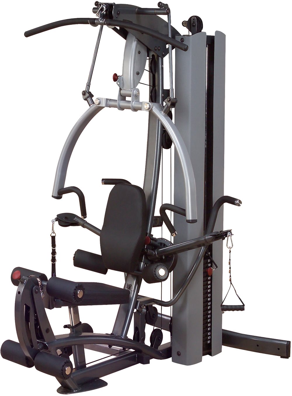

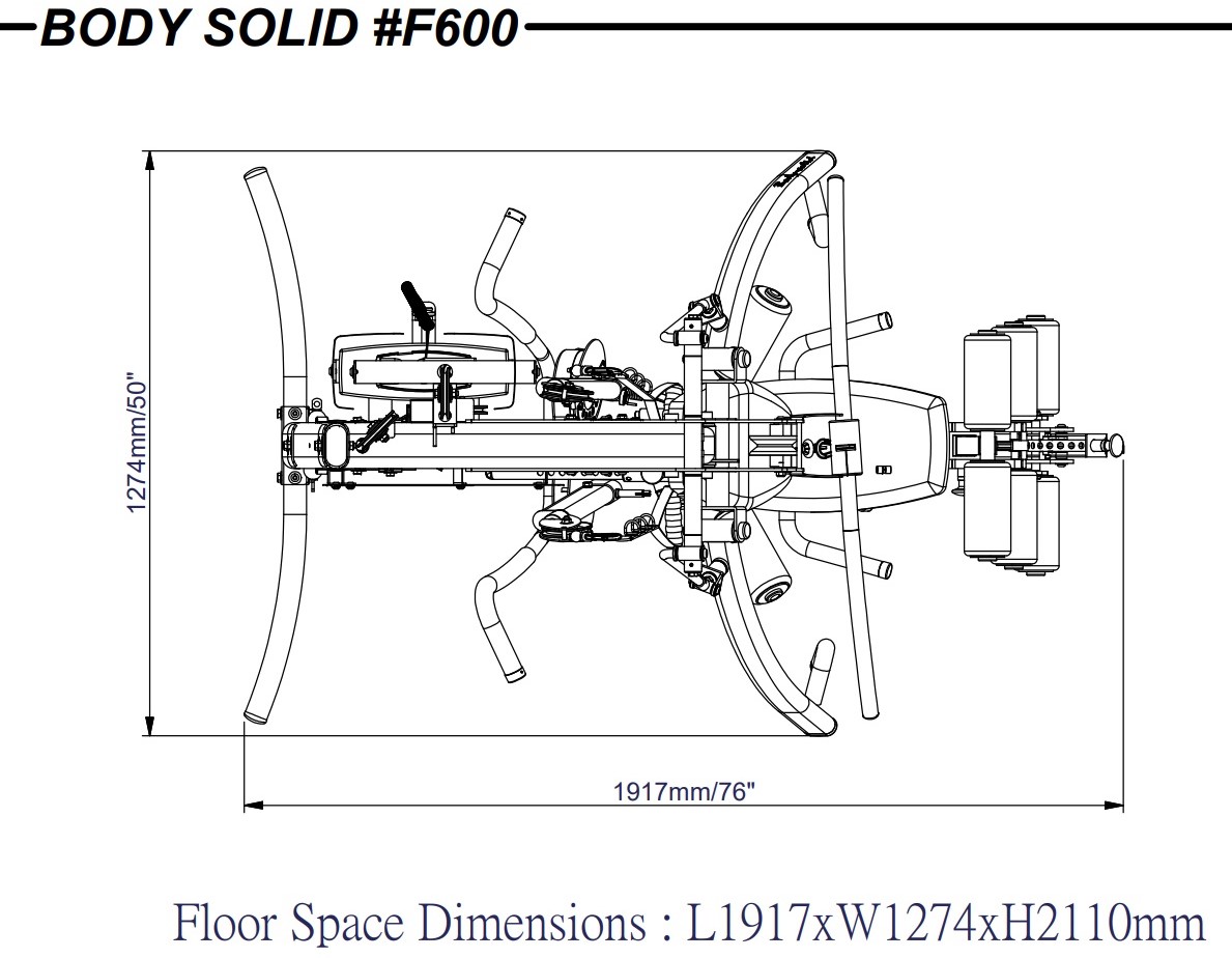

Hi I'm putting a multi gym in my little box room. I've read as much as I can on this and other forums, as well as the Building regs.
I understand the basic 1.5Kn/m2.
But still wanted to be sure as after buying it, I've found the specs didn't include the correct weight, seems like they missed out the weight stack!
The multi gym is 240KG, I weigh 140Kg (Trying to lose 50KG). So the total is 380KG.
The footprint of the gym is a tripod form, with the rear taking about 170kg at centre and 1 rubber stopper feet either side approx 60cm, so a span/distribution of 120cm. The front centre leg seems to be approx 1m from the rear middle directly below the seat, so is taking the remaining 70KG and will take my 140KG.
The House is a 2007 new build and the room is 2m by 3.6m. The room's corner is 2 external walls and the gym will be at these walls.
I can't find which way the joists run, I can only guess width ways across the house as it's a tiny 2 bedroom. I can't get any other info other than it was built using pre 2008 building regs.
Using geometery the triangular formation still means the footprint is approx 1m2. but in real world terms it means it should span 4 joists any direction I place it due to the tripod form.
I have read other post about 700KG fish tanks that are only using 2-3 joists as they are long and thin and totalling 2m2. But it's been a bit scary to buy it and find the specs were 90KG out.

I had half a ton of plaster in the room for 3 months, nothing untoward has happened. Try spreading the weight over as many joists as possible maybe a sheet of osb

Your room is about 6 sq m so can theoretically take a load of 900kg evenly distributed.
As above, sitting it on a big sheet of 18 or 22 or 25mm of OSB or ply will help, or a couple of scaff planks.
What you have to be very aware of is any dynamic loads- presumably the weight stack is at the back? Is there any sort of shock absorbtion when the stack hits bottom? If not then it'll be really annoying for anyone in the room below (and next door) and could cause some damage if it happens frequently.

The weight stack is centre back, the tripod formation means it's feet hit about 1.2m apart. you can't really see in that picture but only the 3 feet touch the ground.
I'm gonna do that with the OSB, although it'll be about 4m2 (2m x 2m) or I can't close the door.
Some people on YouTube are saying that 2 layers of 9mm OSB rather than 1 layer 18mm. Don't know if that makes any difference.
I already had 2 sheets of 11mm, so 22mm in total. but don't know if it's still best to get a single 18mm.

2 x 11 will do fine. Laser tape measure is always a handy thing to have, if you can measure the preload and postload figures it'll help put your mind at rest- on a span of 2 metres if there's 2mm or less difference then no worries.
