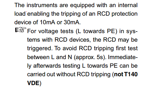

I did read earlier that with some multimeters you should test between L&N first before testing between L&E but I’m not quite sure why. I’m just baffled as I’ve tested many boilers in the same way and never had this happen before.

The Fluke T100 etc. two-pole testers (not a multimeter) act like the OP has mentioned.
That, though, does not explain why it happens only on one appliance.
That's because it has an 'internal load' (to preventing it picking up 'stray voltages'), but that should not be true of any multimeter in its normal voltage measuring configuration, when it should present an input impedance of megohms.
Having said that, some multimeters (usually only quite sophisticated/expensive ones) do have a facility (e.g. 'a button to press') to apply a load across the voltage measuring probes (again, to eliminate the pick up of induced etc. voltages).
