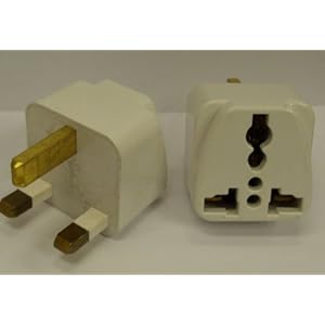

In the main I use these converters
They have been gathered over the years I think
http://www.powerconnections.co.uk/converters.htm
are main people to market them but I have just gathered them from equipment I have changed the plug on.
Some like these are rather dangerous
so one does have to be careful. You need the type with a fuse.
But RS components who are not cheap offer pack of 5 at £1.47 each. also Farnell and many more.
