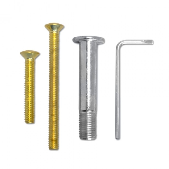

I ordered the Hoppe Atlanta PAS24 handle with 215mm screw centres. Unfortunately the bottom screw is a two part arrangement:
http://www.randrsecurity.com/image/...Upvc Handles/Accessories/L23966qb-700x700.jpg
The fat silver bolt in the above picture screws into the outer handle, then the shorter screw goes into that to secure the outer and inner handle. In practice this meant the fat bolt negated the extra 4mm (211mm v 215mm) clearance for the bottom screw.

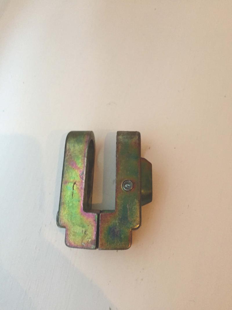

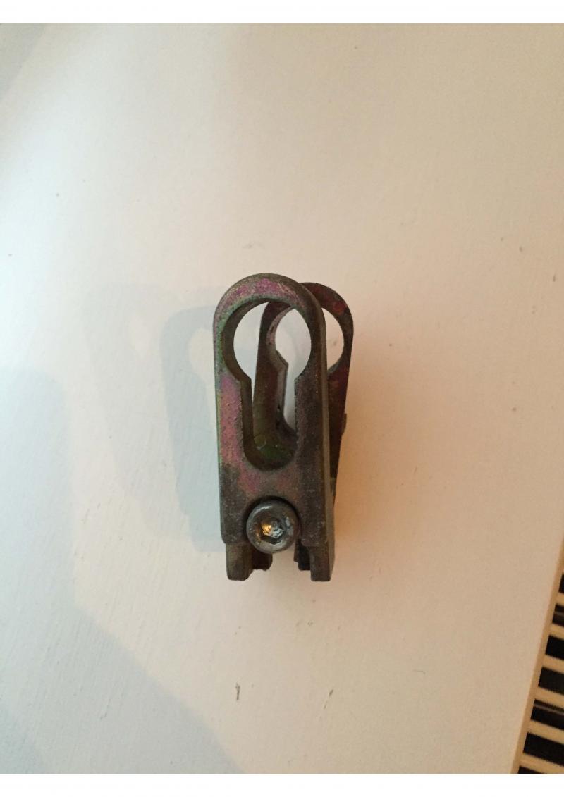

So now I thought I'd take apart the offending cylinder holder and try to buy a shorter one, but it turns out it may not be the cylinder holder after all:
The cylinder sits in the multilock bar and the fixing screw goes through that. This appears to be some sort of cylinder protector, essentially sandwiching the cylinder from both sides. As it was installed it was pointless as the fixing bolt was on the outside (so could just be opened :/).
In any case I removed it and now either handle fits :) (although :( because if I'd done this sooner I wouldn't have had to buy the second handle).
The only difference I've noticed is when opening the lock the key will now spin past the open point. This is not a major problem for me as I need to push the handle down to disengage the multipoint locks anyway (if it was just a single point the key could open the latch previously). When closing the key stops turning when locked.
So my questions are:
1) Am I correct that this is some sort of cylinder protection?
2) Do I need it (I have an anti snap lock and PAS24 handle)
3) Is there any need to worry that when opening the key keeps spinning past the point where the door latch is opened?
4) If I do need it, is it possible to get a shorter one (I don't want to buy yet another handle)? What should I search for when looking for an alternative?

Some more reading and I've found the answer to question 1 & 4. It is cylinder protection and its called a cylinder guard. Not sure about questions 2 & 3 though:
