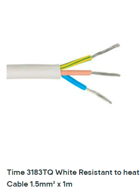

I need to replace the cables to my 3kw Immersion heaters. Toolstation sell two different heat resistant flex cable:
1) Pitacs 3 Core Heat Resistant Flex Cable (3093Y) 1.5mm2
• PVC insulated
• Resistant to 90°C
• BS6500
2) Pitacs Immersion Heater Cable (3183TQ) 1.5mm2
• Heat, oil resistant -20 to +85°C
• BSEN 50525-2-21
Can I use cable 1), or do I have to use cable 2)?

3183TQ is a Butyl rubber sheathed cable.
3093Y is a PVC sheathed cable.
Both would be suitable for the load & the temperature. My personal preference would be the butyl sheathed cable
Yes. Being an old-fashioned beast, I would use butyl too.
Probably because when I started, the HR flex was not as commonly available.
