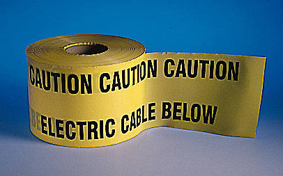

Hello, I need to know how is the typical section of buried cables in UK, I need a picture, or a drawing or a link where I can find this enquiry, because I am working in a project for this country and I am from Spain and I do not know if it is like in Spain or different.
well, guide is an 18 inch trench, bottom filled with a couple inches of sand, then cable, then a couple of inches of sand, then about 6-8inches of back fill, then warning tape, then remaining back fill.

The National Joint Utilities Group (NJUG) publication number 4 covers the colours of ducts, pipes and marker/warning tapes. Generally the duct is black (perhaps with orange bands) or orange with marker tape above the duct or able run. The marker tape is yellow with black legend:

Well, we are doing a Project Management in Cardiff. I have 33 kV cables, and for example Iberdrola (one of the electrical companies in Spain) have standards trenchs and they give its drawings. And in this case, in Spain (33 kV buried cables) the trench more or less is similar like Lectrician said, whit sand, warning tape... So I´m looking for is this trench's drawing in UK.
