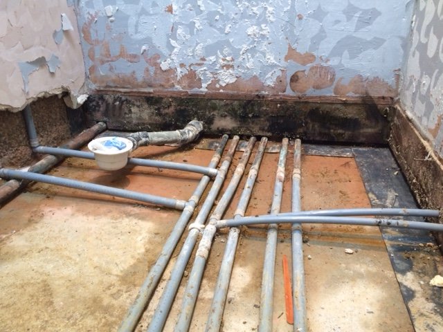

This lot needs replacing for a second time.
Quoting to do it in copper. Properly.
Heating system dumping its guts under a wet room floor.
Quality.
