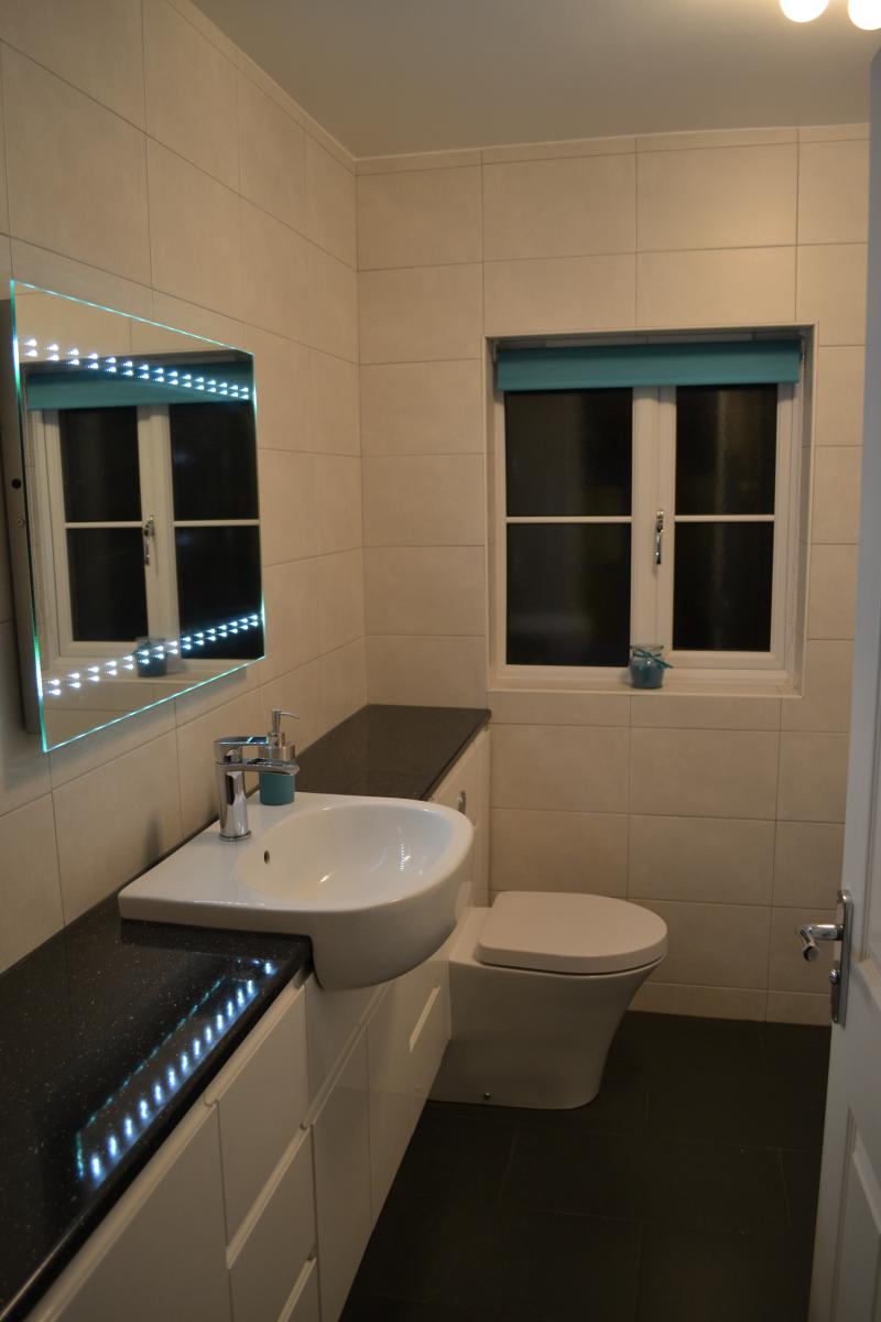

My first DIY attempt at a bathroom, just a basic rip out and replace really.
Porcelain tiled floor with underfloor heating, digital timer in airing cupboard at back of shower. Radiator was moved from below window to behind the door by professionals whilst they were replacing central heating system, the rest of the work is my own......quite pleased with the result.

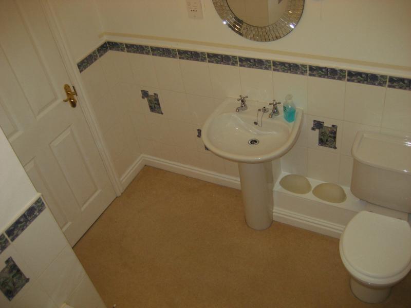

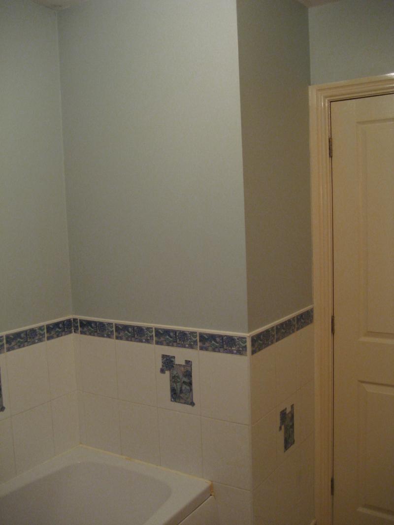

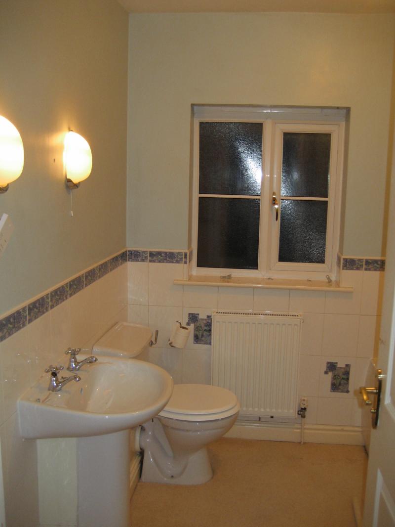

Before....

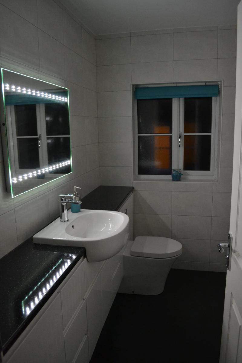

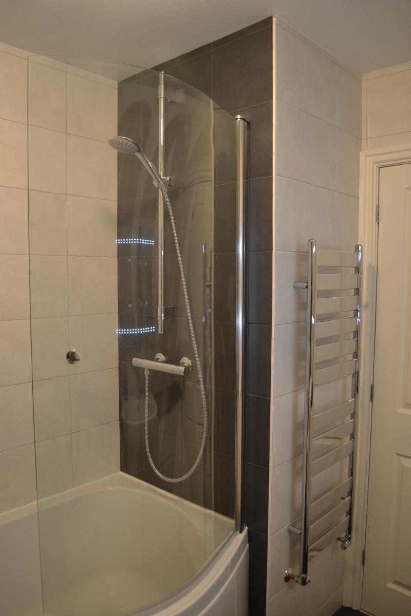

After....
Would really like some feedback as I am considering a complete career change and bathrooms may be the way forward.
Bit of constructive criticism for you: your tiling could have been planned out better. You've left yourself with a thin strip just at ceiling level which could have easily been avoided.
Thanks for the feedback, I'm glad someone noticed that. I did sit their for a while trying to weigh up all the options as it had been over 10 years since I did any tiling.
The way it is now gives me a full tile above the bath and virtually a full tile (give or take a few mm) above the worktop.
I did consider cutting a tile in half when starting over the bath but thought the eye would be drawn more to worktop or bath area rather than ceiling....and it was less cutting haha
Do you think it would be better starting with half a tile above bath leaving 3/4 of tile near the ceiling?

yes but would you have got rid of the small tile at floor level, saving on cuts or maybe be left with another small cut down there? bathrooms ain,t easy are they?i think a lot of folks would be well pleased with that tiling job and no matter what you do , somewhere you will get some narrow cuts

I'm no tiling expert but personally I think I would have used a half tile at bath level and a half tile at the top.
It's just a small criticism though and one that someone who's never tiled wouldn't probably notice, your bathroom looks great I think.
I'm planning to gut my en-suite soon so any criticism/advice really will be constructive!
Planning the layout is a very important part of the process & there are standard layout procedures but sometimes these have to be modified to get the look right; what’s important is to get it right where the eyes fall as you enter the room as this will form the overall impression. Job looks nice from where I’m sitting but I agree with the thin tile sliver comment. Hope you’ve got some decent waterproof tile backer board or tanking around that shower/bath, it can make a huge difference t how long it stays looking like that.

Use chrome plated copper to your towel rail next time.

But in your second "before" pic - are those implants on the side next to the toilet?
