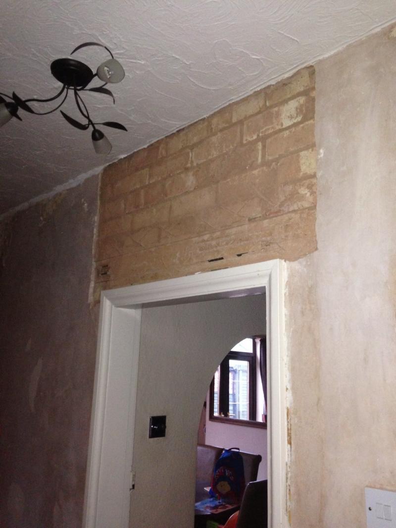

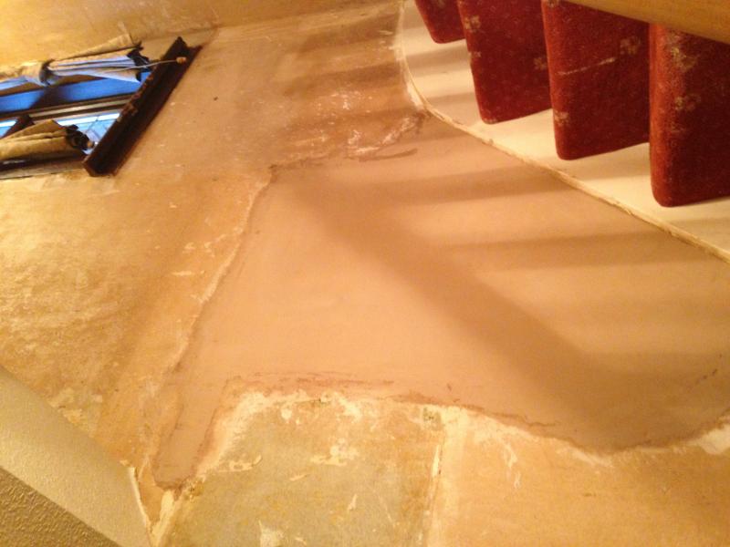

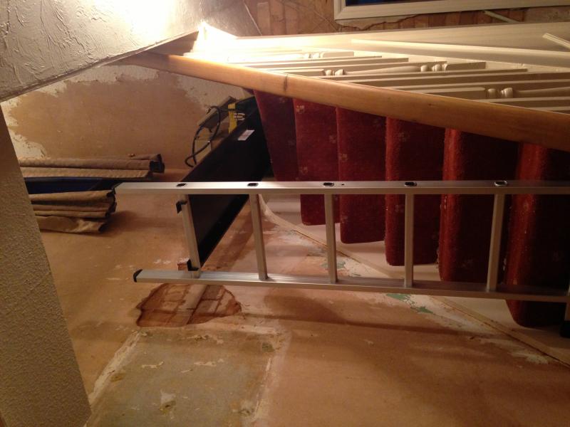

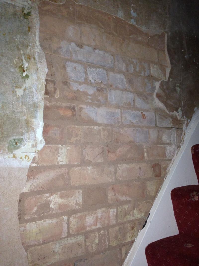

Hi,
Weve decided to decorate the hall/stairs and landing and upon stripping the paper have noticed a fair amount of plaster thats come away from the wall back to brick.
Iv taken of most of the shot plaster and am now left with plaster thats seems sound.
Me and my friend are planning on plastering these sections but im a little stuck on what type of plaster to use. For the bigger sections (pretty much a whole wall) should i go for hardwall and then finish coat skim? or toughcoat and then finish plaster? and the smaller sections (around 2mx2m sections) just a one coat filler of somekind?
iv uploaded some pictures so you can see what im working with

Thanks for the reply :)
Iv never done plastering before but iv done alot of research and watched alot of videos ha ha
Iv not thought about pre-painting surfaces. Do you mean the surface I plan to plaster? If so I planned to apply a pva mix however today I found out hardwall/toughcoat doesn't need a pva coat.
As for the smaller patches iv took the plaster back to where it seems solid, should I use the same hardwall/toughcoat base then skim method?

Browning and gypsum finish will do fine as powders. Or perhaps you would be happier with this one-coat stuff.

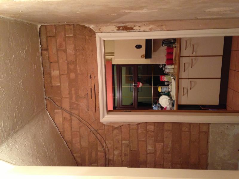

Give yourself as many clean, non-ragged edges to work to as possible - Cut back all your edges to straight undercut lines. Knock-off that bit at the door architrave.
PVA is not req'd, simply wet down the brickwork before floating.
Why not practice on a low accessible spot, knock-off and practice again and again.

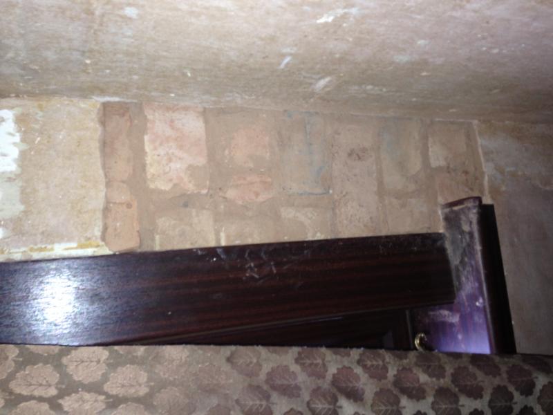

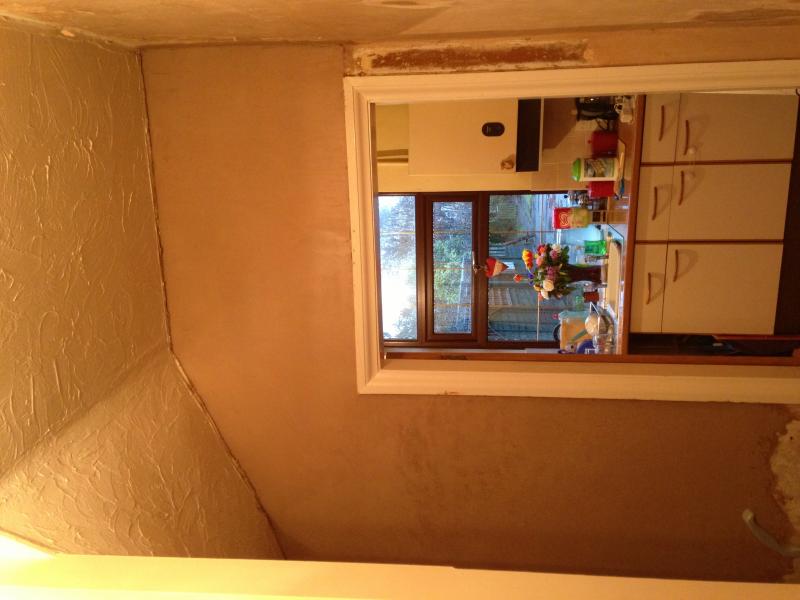

I'm gonna take all that plaster away around the door, I might take the architrave off aswell for an easier life around the door. I will update with pictures later :)
Leave it exposed like that, it looks funky lol
Regards to painting surrounding areas first, don't bother.
You will notice the newer bit of paint. Plus you are going to have to mist coat the new plaster anyway.
wet brick work,bonding coat to brick work out to excisting plaster.leave a day and then skim over the lot,easy,i would leave the bit down the side of the door way and skim over with thin paint scrapper.

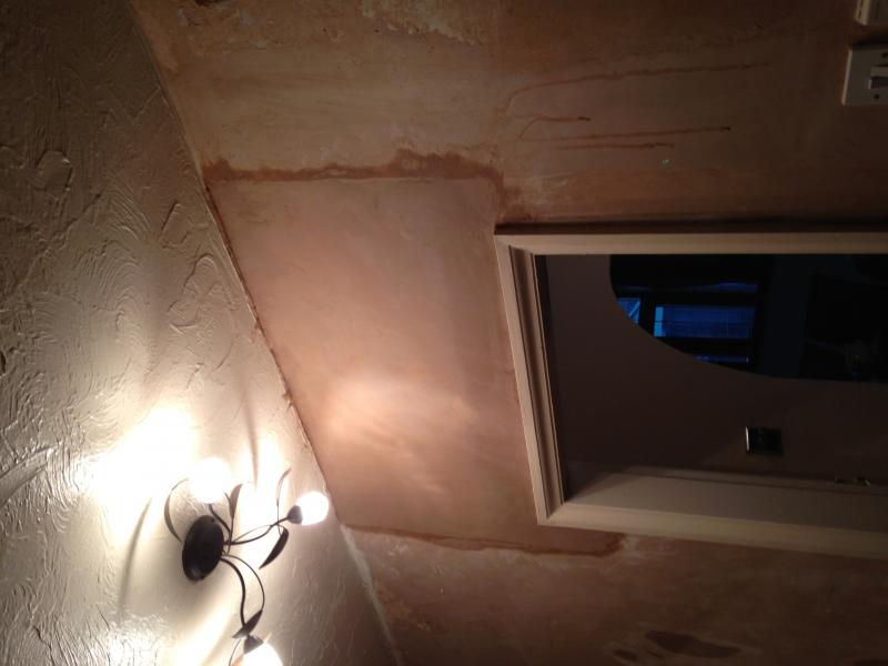

Well i think it went pretty well.
When the bounding coat was drying it started to show hairline cracks which made me feel nervous (not sure if that's normal or not) I scoured lines in it and then did the skim finish.
I actually enjoyed doing it and I think it looks pretty good for a complete beginner. Once it's dried I'll sand some of the rough edges and it should be good to go :)
