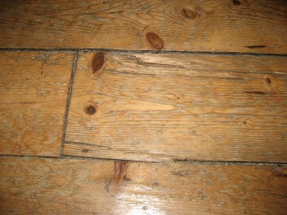

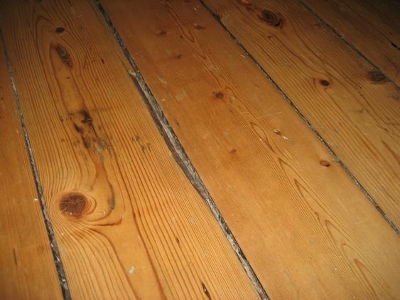

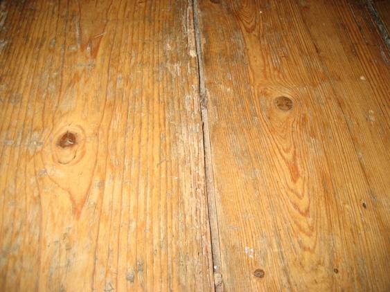

My kitchen has a suspended wooden floor (not 100% sure on wood type), of Victorian age, thick planks in tongue and groove fixing. Room is about 7m x 4m.
Thing is, it's a bit of a mess. It has had quite a few planks attacked by woodworm, some are split or cracked and most have next to no varnish left on them.
So my question is, what should I do to fix this?
Getting it sanded and varnished would be the cheapest option, but that wouldn't sort the splits or other damage. Could I fill these bits before sanding? The gaps between the boards would obviously still exist and let in drafts.
I guess I could put a new floor over the existing one, probably using engineered wood flooring of about 14mm thickness, I think my doors could cope with that extra depth of floor.
Or, is it possible to lift the boards and lay new ones? I imagine these would also need to be sanded and varnished. I have no idea how much new floor boards would cost.

To be honest looking at the pictures you have posted the wood worm problem and other issues do not seem to warrent that much work, certainly not replacing or overboarding.

Wee update
Went for the sanding and filling option.
Finished just over a week ago. Extremely pleased with the result. The floor has come up so much better than I thought it would.
