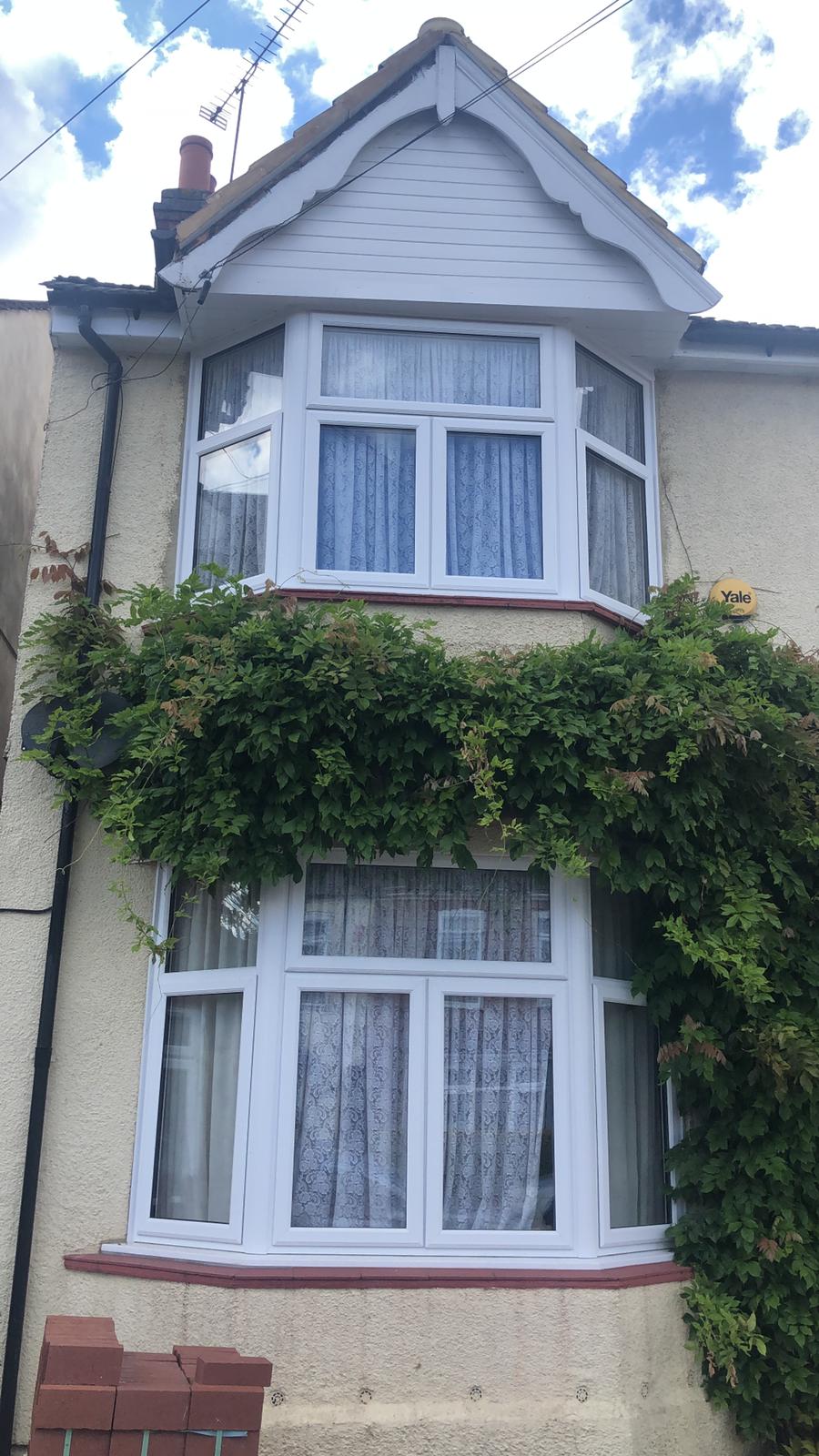

Hello Experts!
I bought a new house about 2 years now, My full building survey did not mention anything about this, but the front Gabel and my front Bay window has dipped down and leaned towards front since we have moved in we have noticed.
I recently changed windows and they also mentioned there is a problem fitting in my front bay due to this reason and some how fitted them and completed.

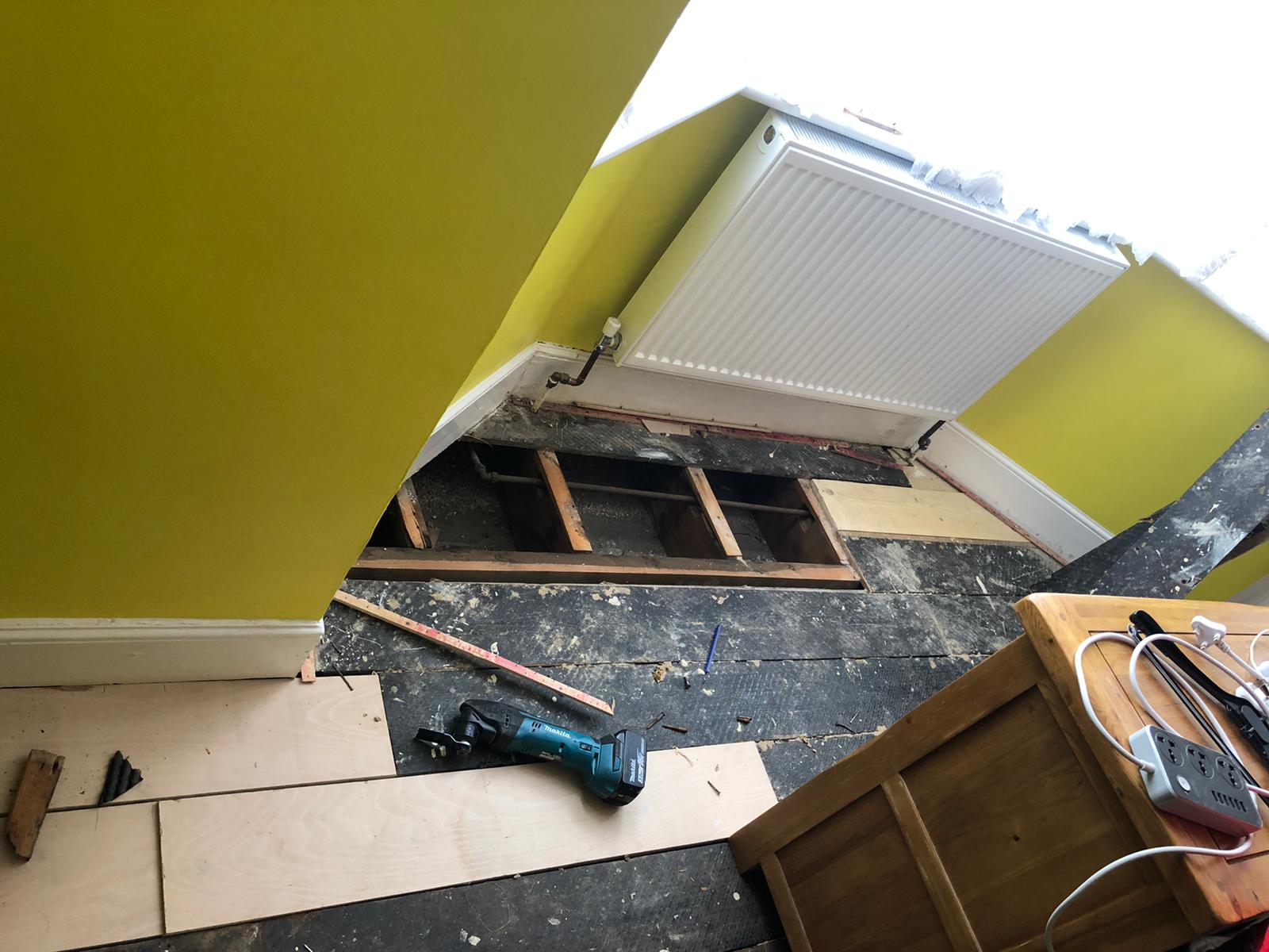

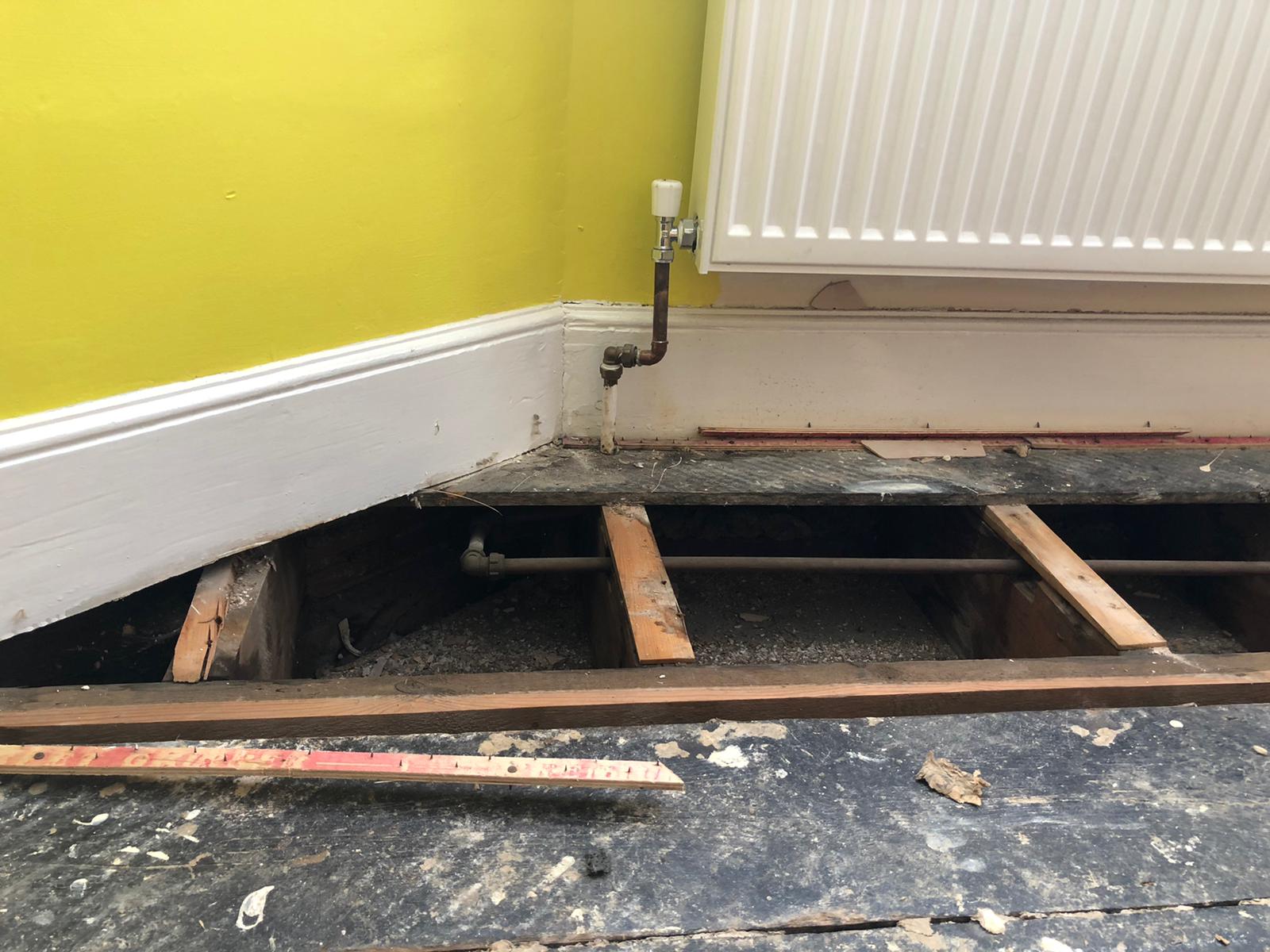

I now had chance to lift floor boards in the top room and can easily identify the dip ness towards the front bay. Joists actually run from rear to front and stops just before the Bay window half hexagon starts. From there a new joists starts to complete the bay which is now coming off and dipped down as you may see in picture. I have over periods noticed some cracks on Bay window and have filled pollyfilla and have not evidenced any new cracks since then.

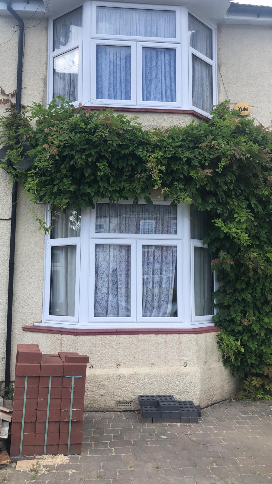

At the front of Bay equally I have noticed one main crack but didnot notice much also my wisteria is covered.
Point is that my Lender had a valuation carried and they did not mention any, My seller did not mention any and neither Building survey I carried out. Equally window company that did the bay windows though they mentioned the top Gabel is leaned forward that is causing problem 8n erecting the window they did not mention the floor level is dipped. I am now wondering if the window company has added more pressure and even dipped more?
Please can some one advise me where should I go from now? What needs to be done?

Premkumar_prem, good evening.
I notice that your information appears to indicate you are based in India??
Are there any cracks between the bay window and the main front elevation? if so how wide are they??
likewise are there any internal cracks in the same location??
When the "new" windows were fitted, can you recall if the installer fitted some steel reinforcing stantions at the external corners?
Ken.
I'm guessing part of the problem is removing the old windows which were a structural element and replacing them with plastic windows.
Hi ya
Yes I am from India but based in London. So the house i am referring to is based in London.
Outside the house Bay there is one small crack at the corner and one small crack in the middle
inside the house bay, there were few cracks on either side of the bay at the time of lifting windows. I have now lolly filled the cracks and cannot see any cracks coming up.
My Replacement of floor boards are now stopped at the bay window. Because it is impossible to fit a floor board to keep the level straight
And I am not sure whom to seek for advise and where the problem could be
I suspect the changing of the windows has caused the problem, as the new frames are not strong enough to support the floor and gable.
Were the previous windows plastic? If so the damage could have been done because they did not use structural bay poles. Hopefully the company who fitted the latest windows (and highlighted the issue) used the correct structural bay poles with jacks - which while unlikely to "lift" anything back to where it was before will prevent any further movement, I would check with them - if not, you may have have some recourse through FENSA.
If you're satisfied that it's now stopped moving then put some timber fillets on your joists to level up the floorboards.
