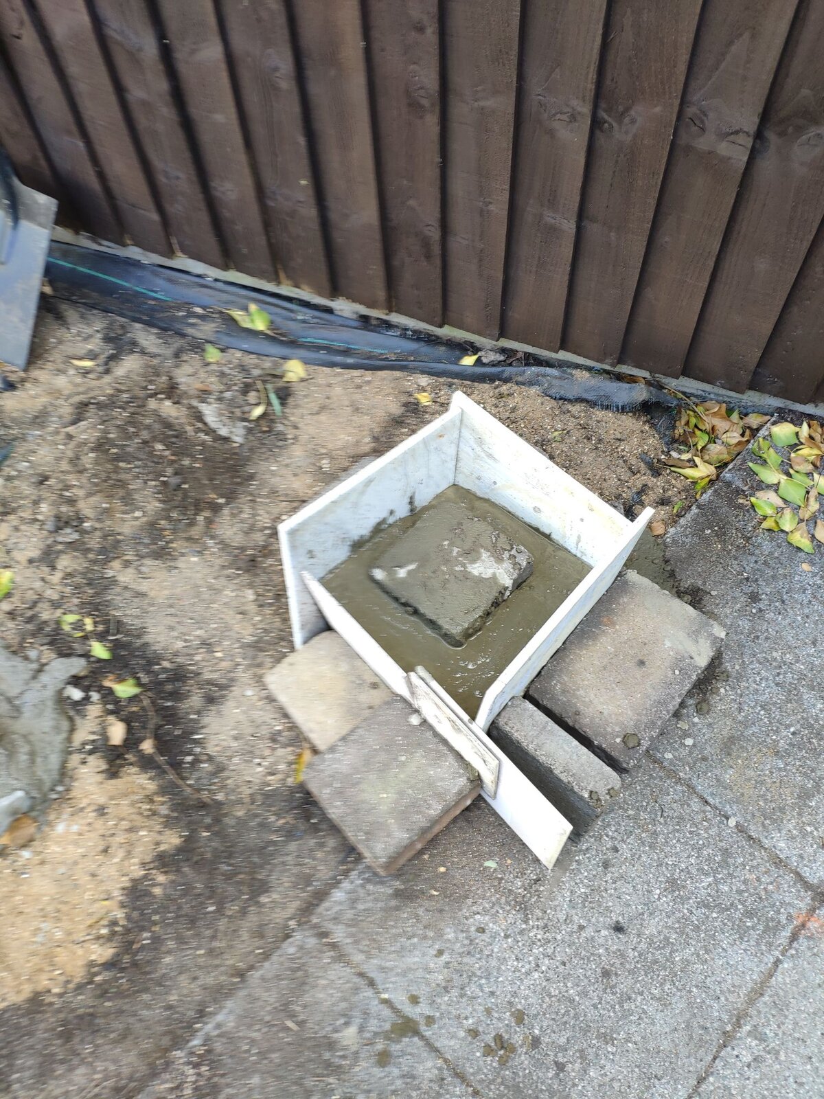

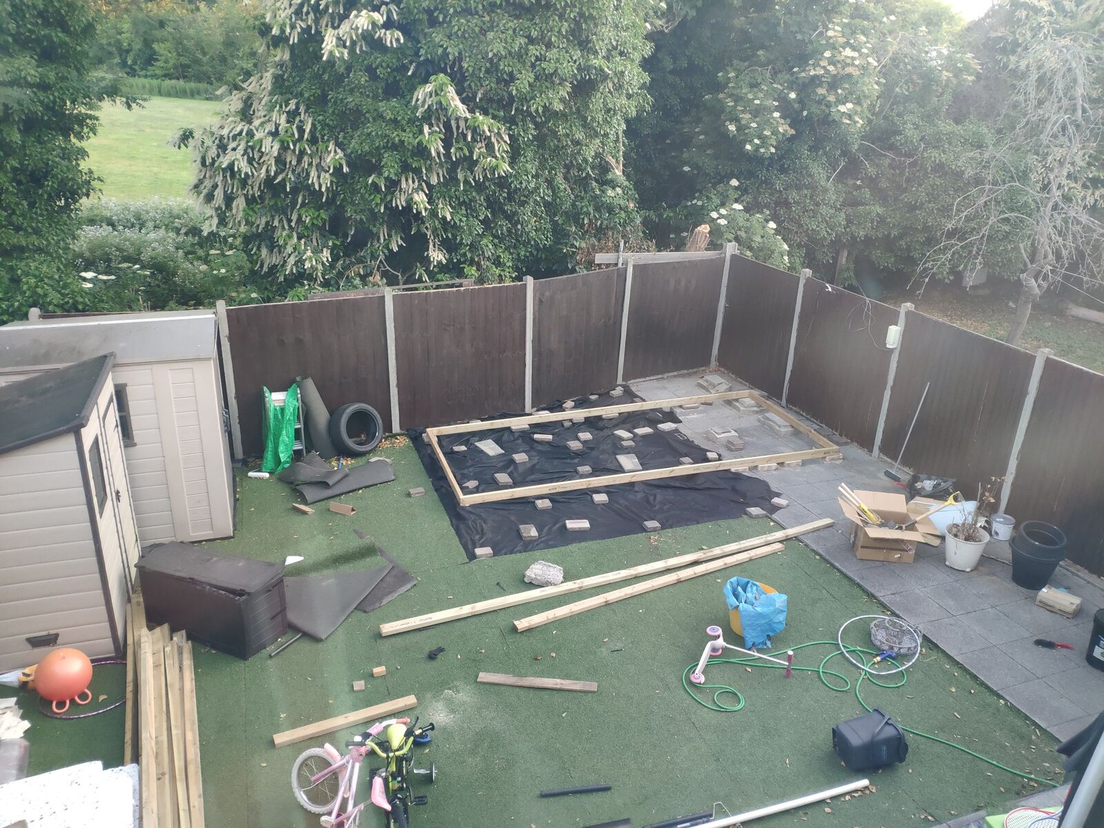

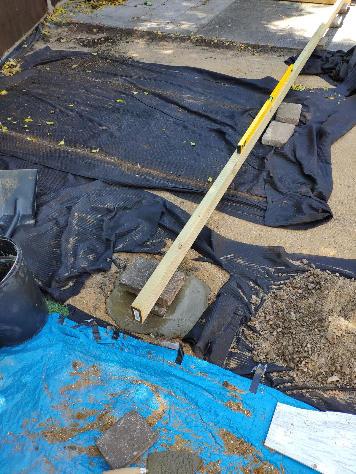

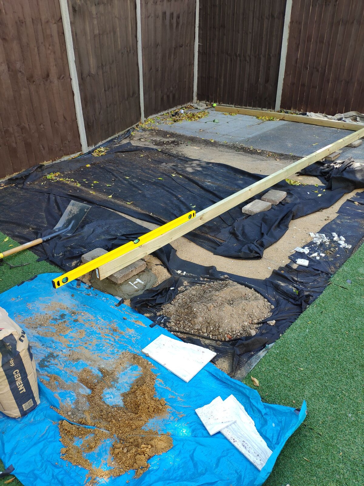

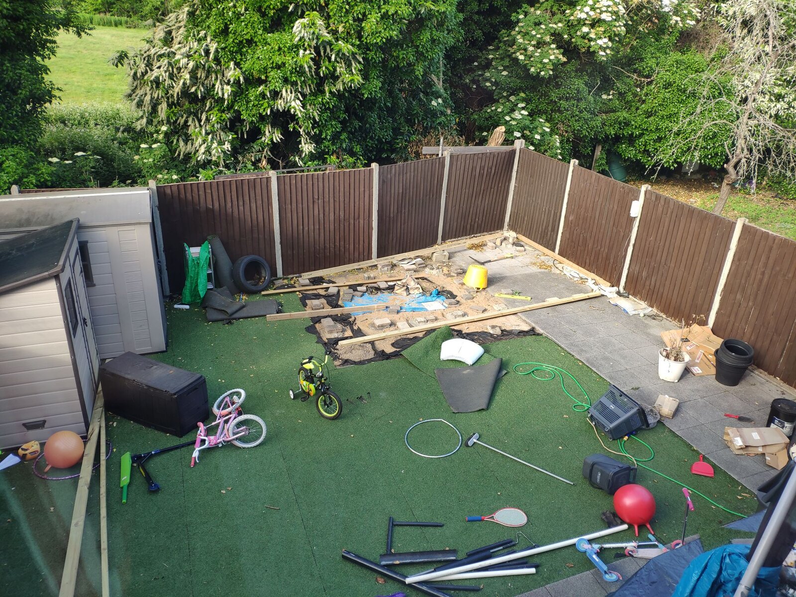

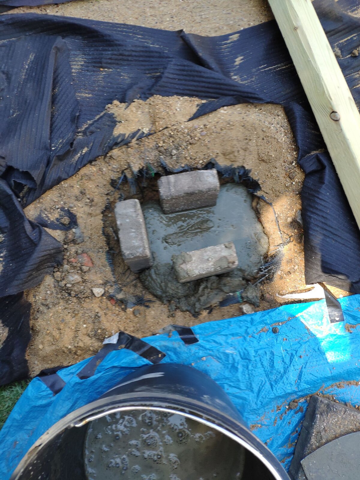

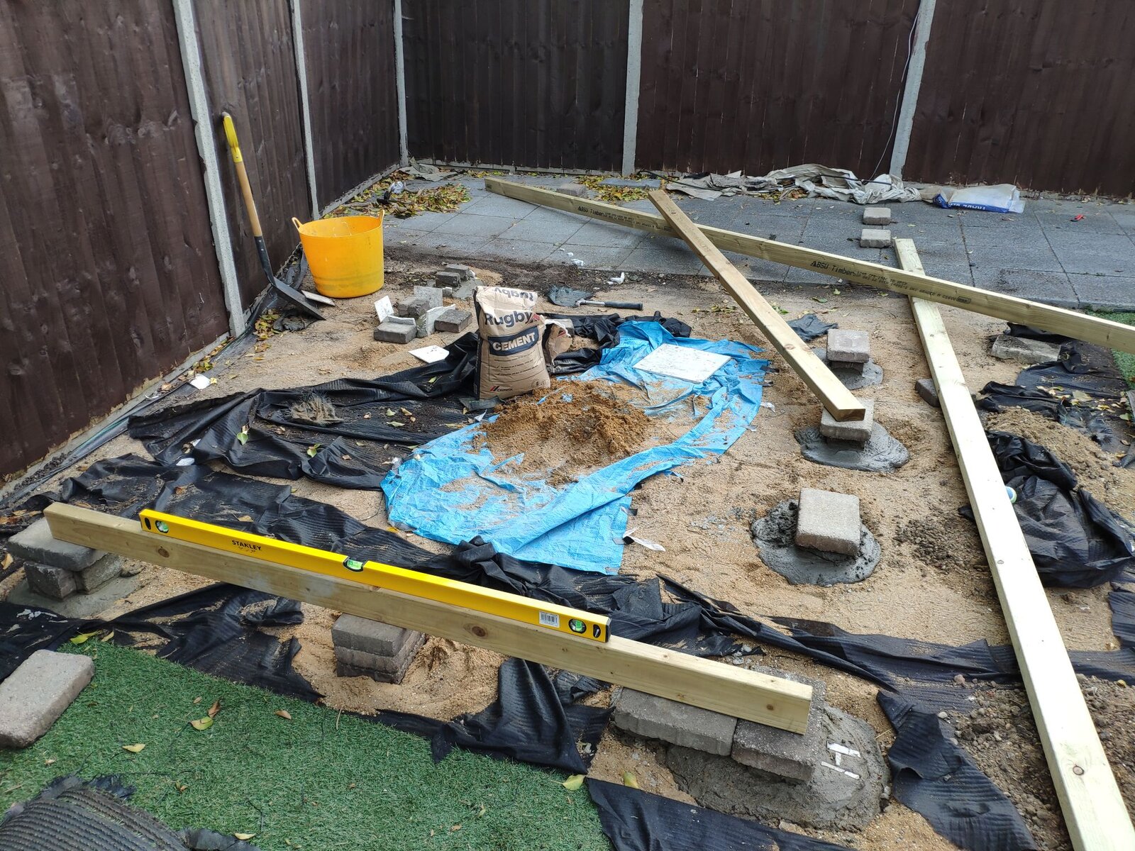

Step 1: Prepare the terrain - i focused on building concrete pillars myself, so used free bricks and paving slabs i got off the internet (collection) and rubble - to create a number of pillars that would support the base

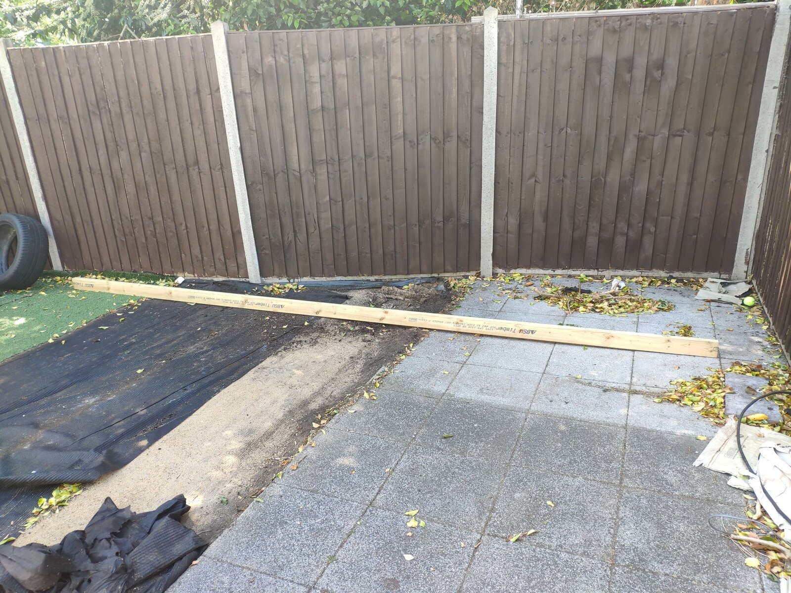

Step 2: created the base
this is probably the one where you want to take the most time, as any uneven surface will just create issues in the future - so DO not rush this part
make sure the base is completely straight - use a level in all directions - check it again 3x if needed.... because otherwise you will regret it once the structure is up and you feel a slight slunt

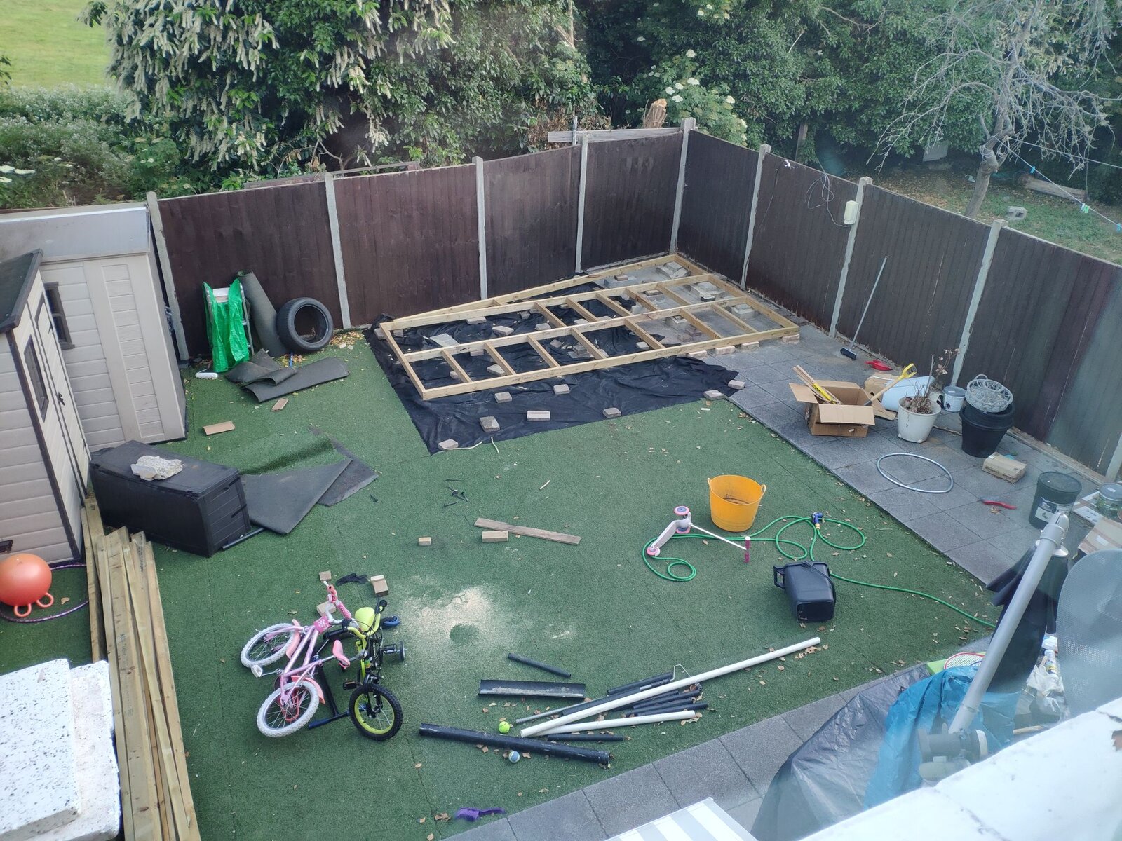

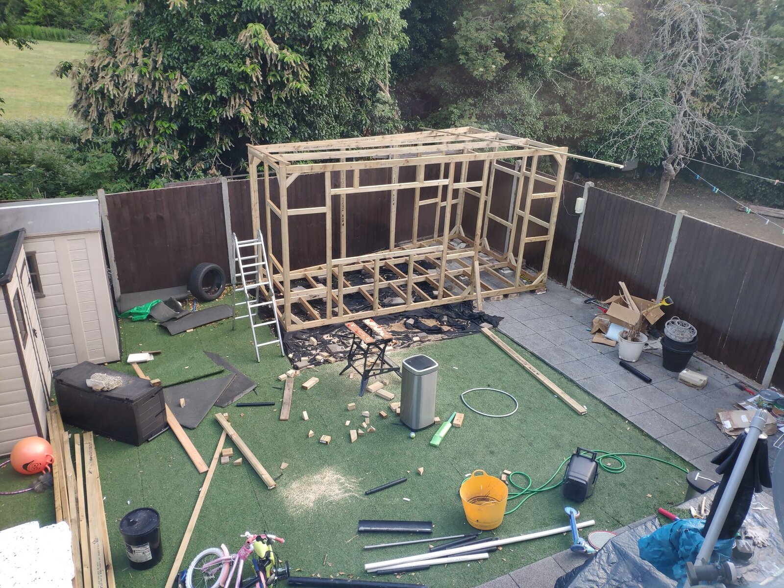

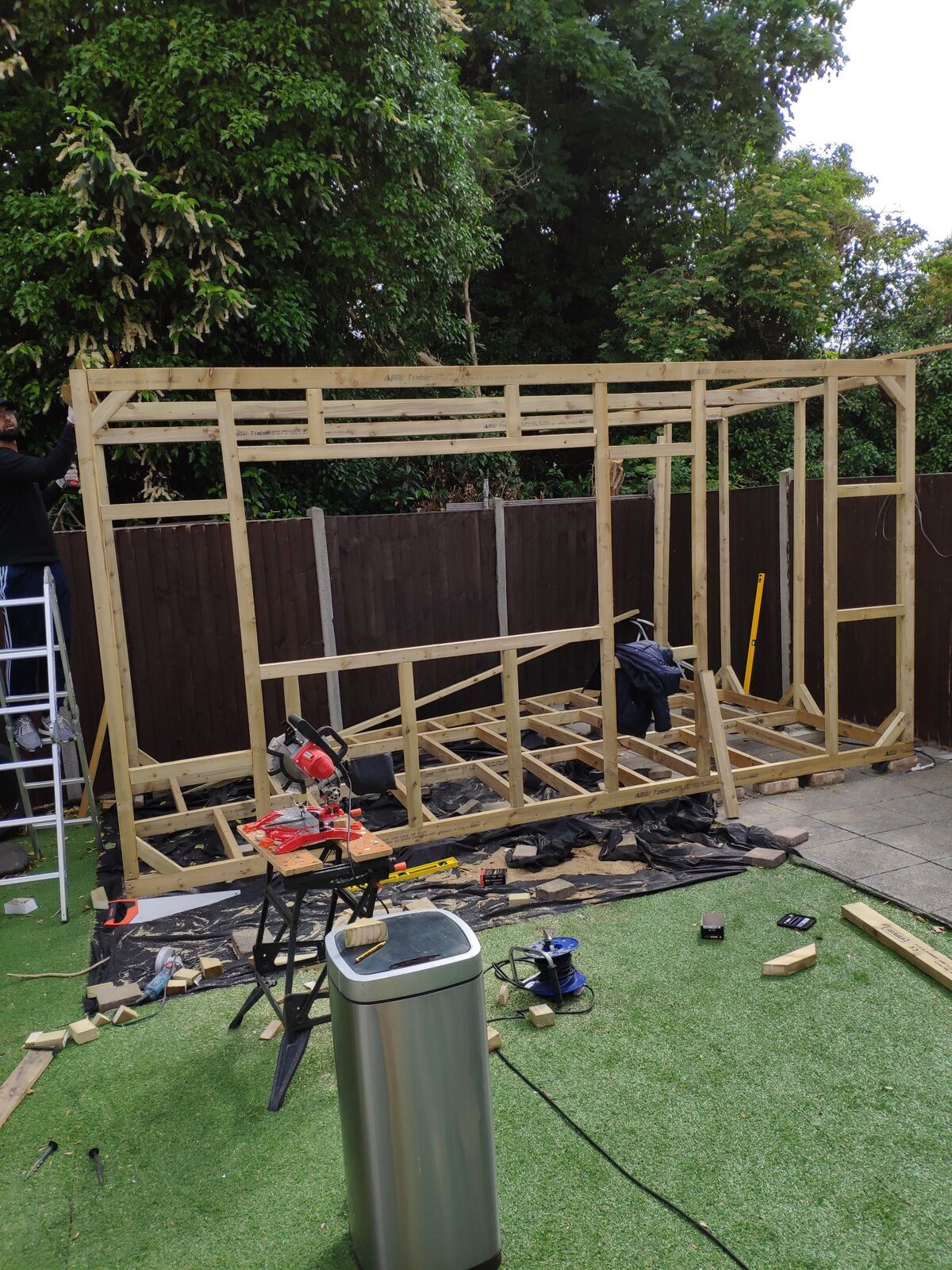

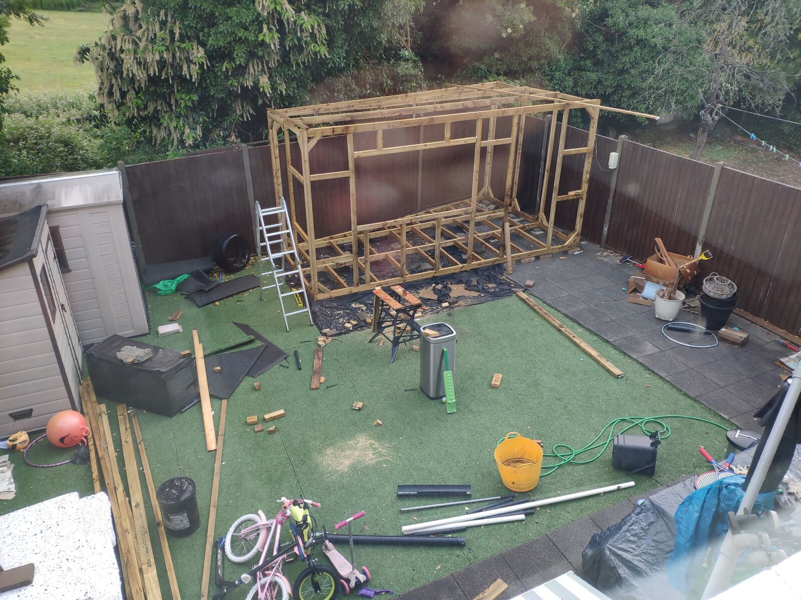

Step 3: Structure up
The hard part is done - now its just easy and fun - screwing the structure together is probably the most awarding part of the build - and the easiest too

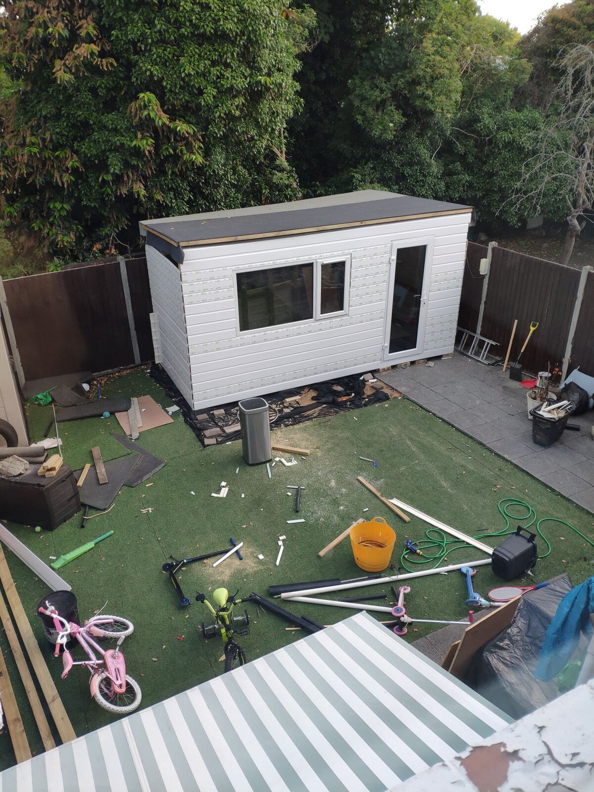

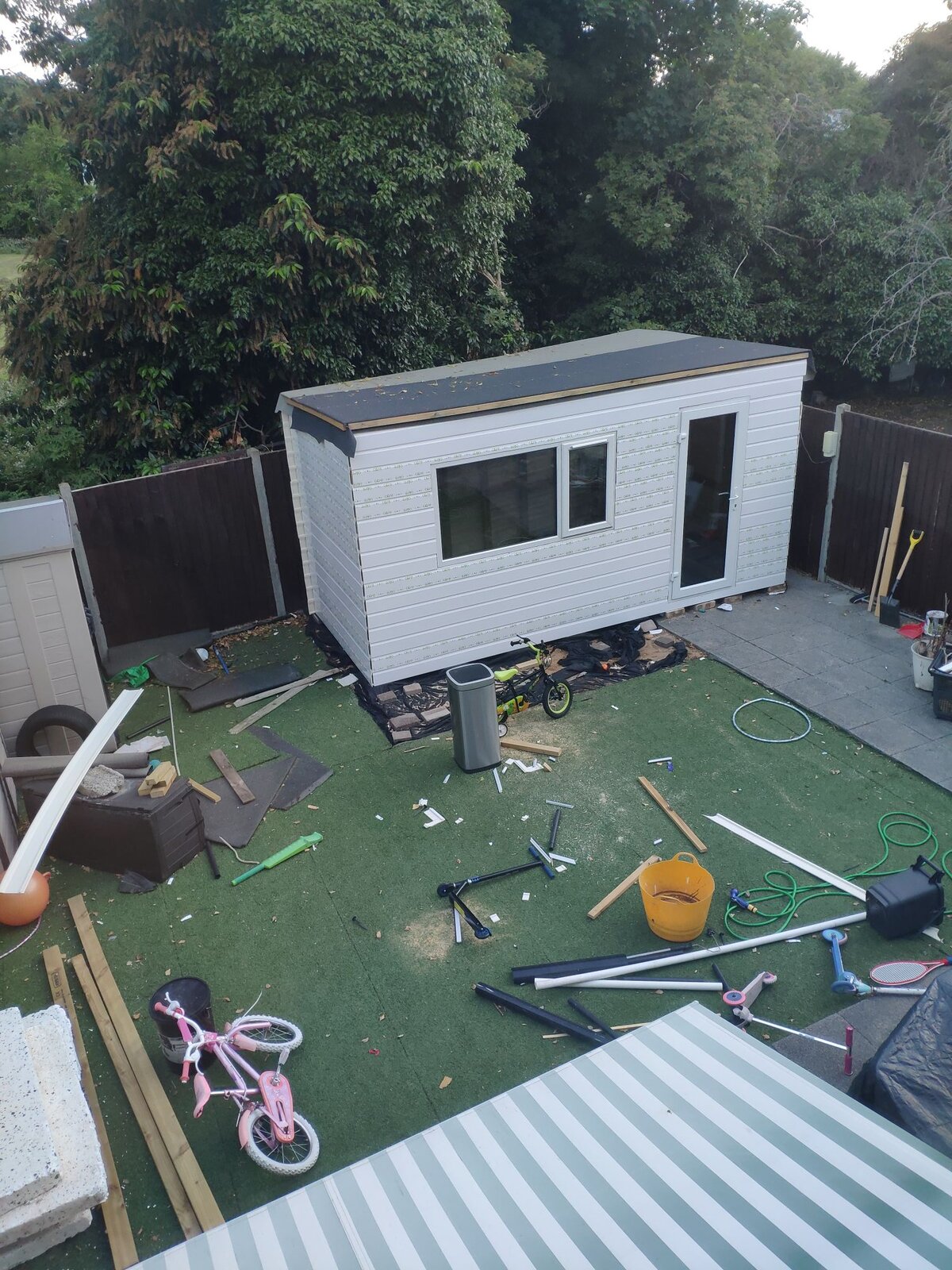

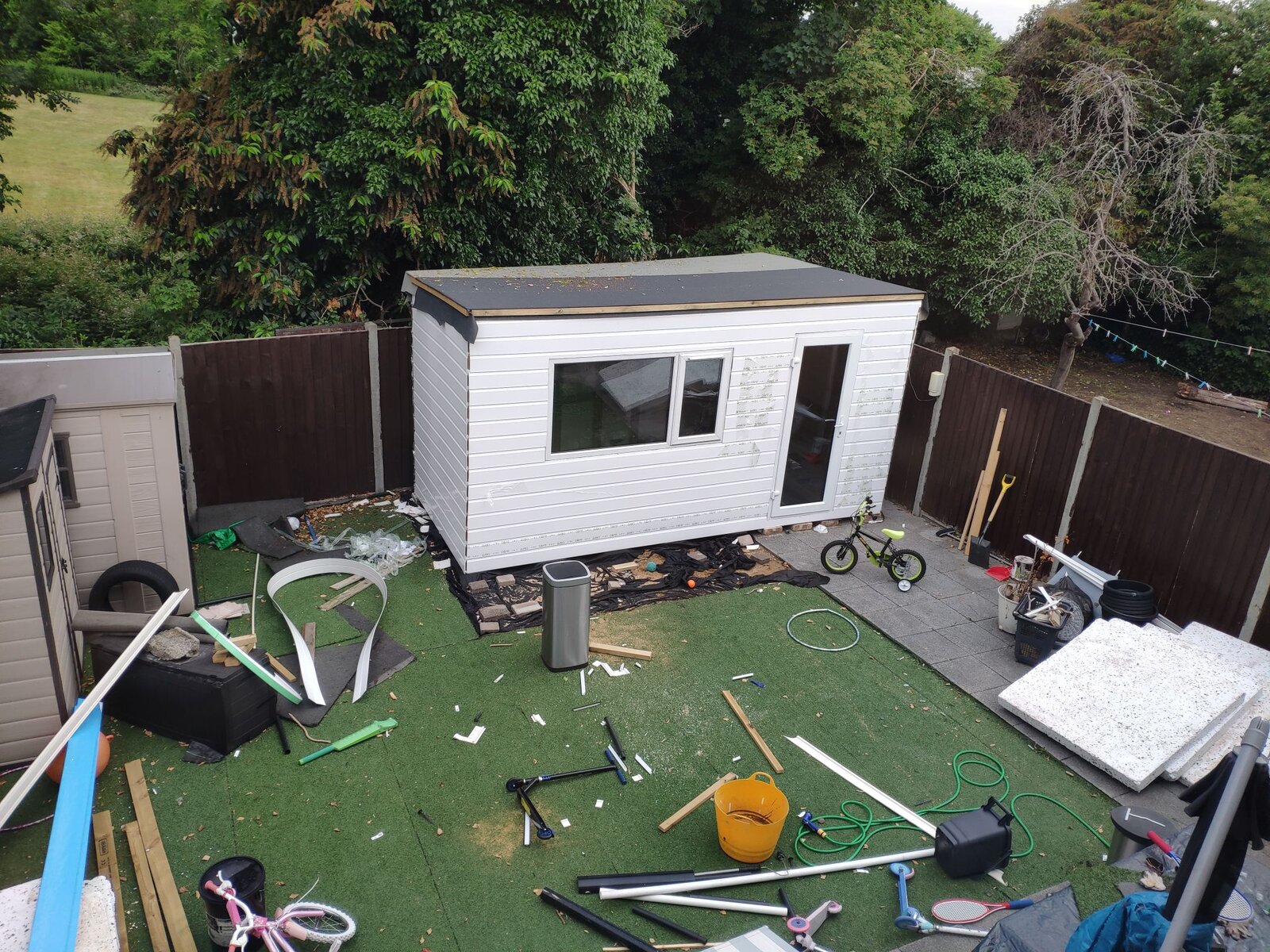

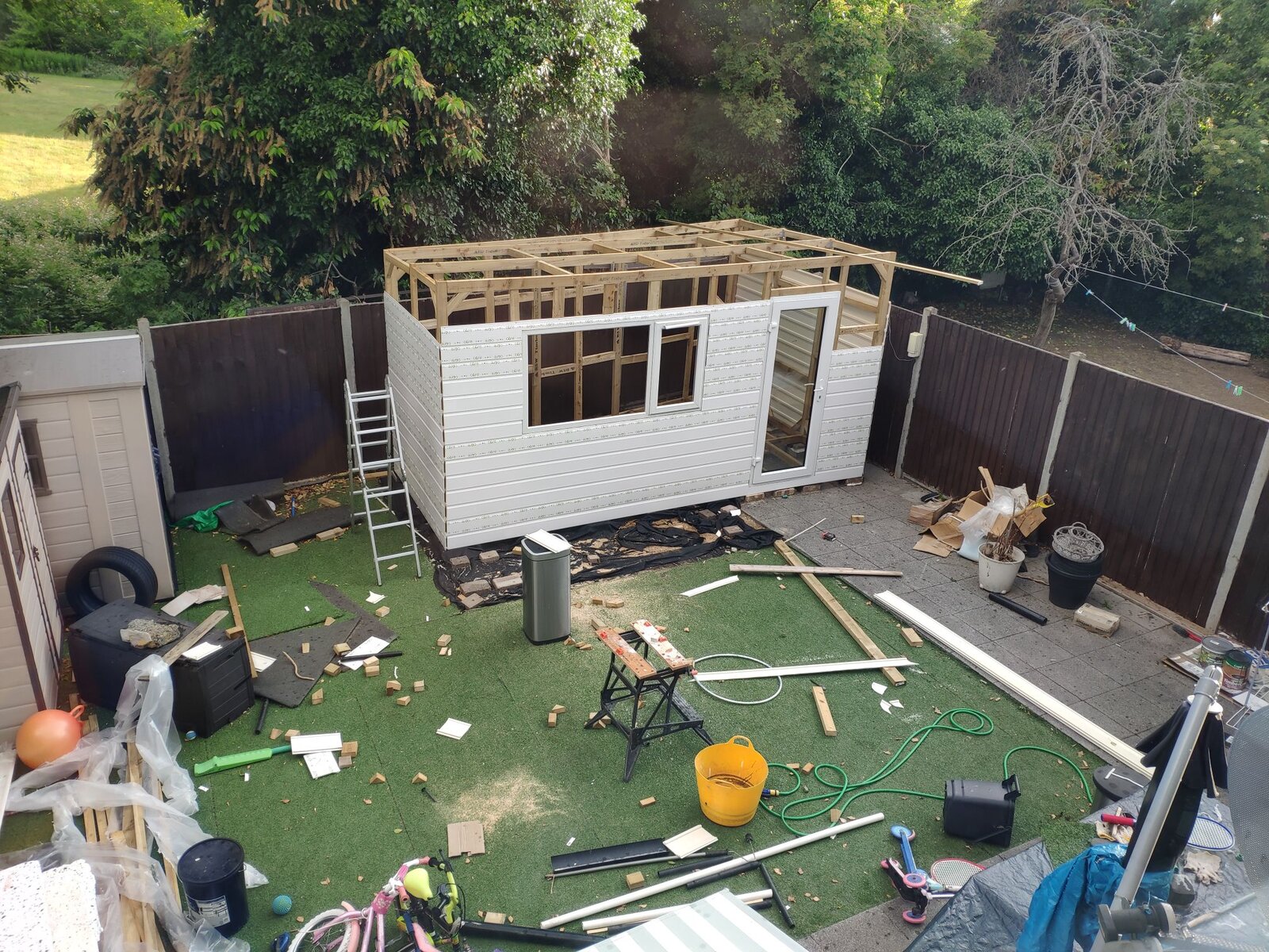

Step 4: Get the outside done
I know many will not agree with my cost saving approach - but i chose to direclty put the cladding on the structure - and behind the cladding i would be putting the insulation directly - this was sufficient for me. and in the current 2-3 degree temperatures, with my small electric radiator it is still the warmest room in the house :)

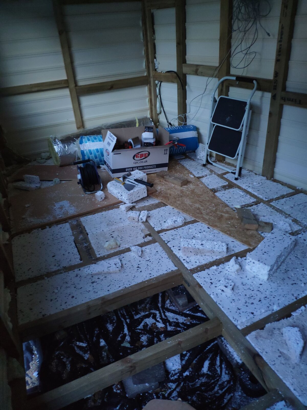

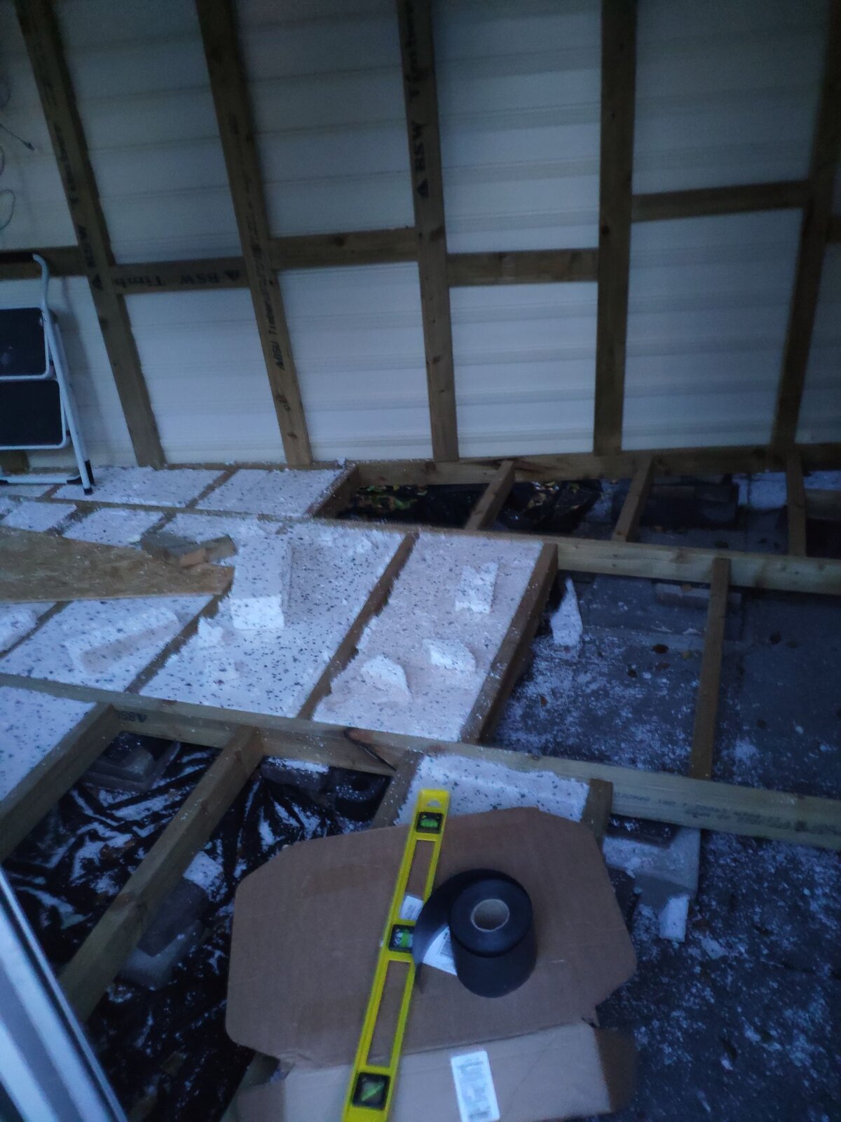

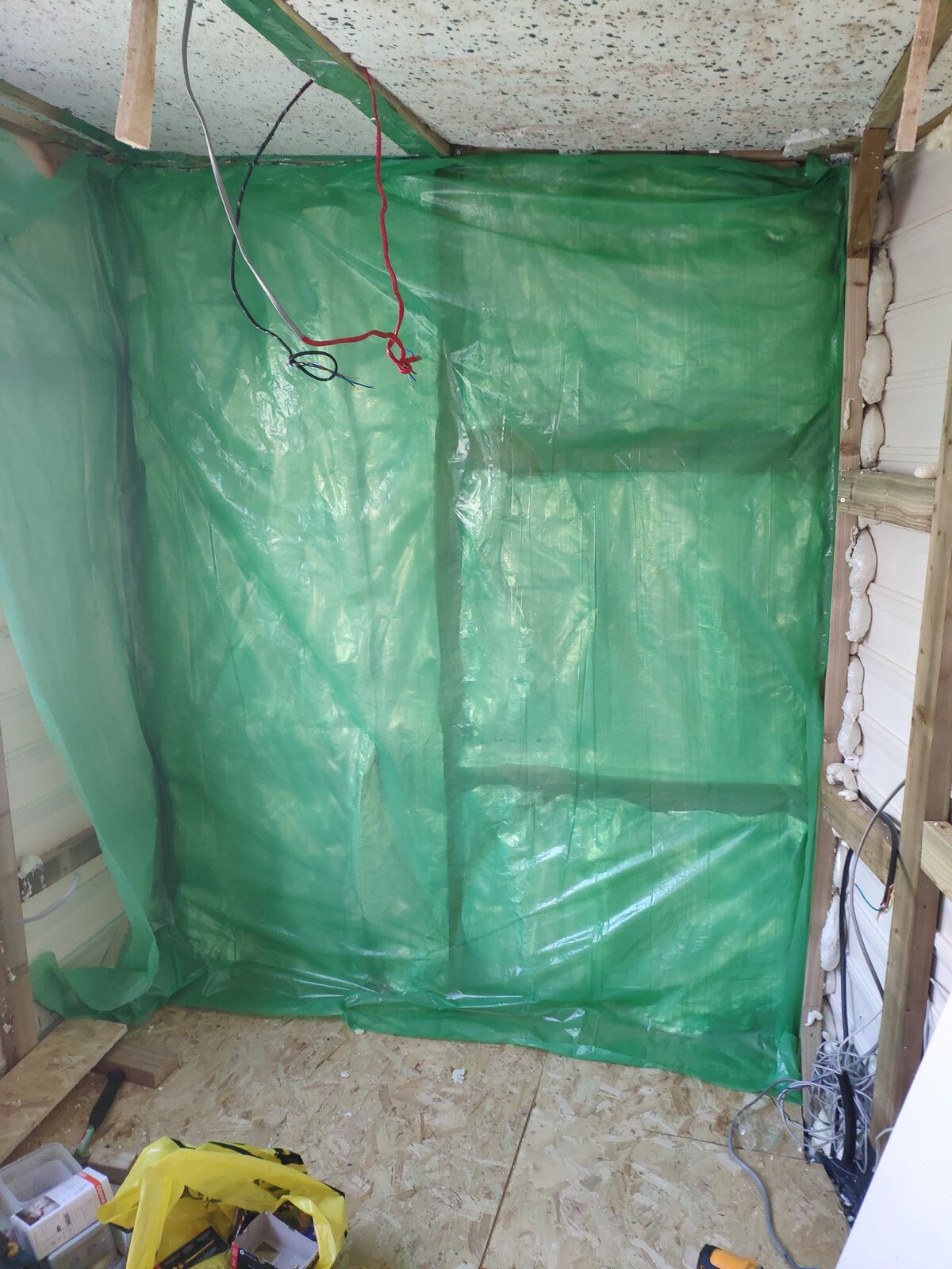

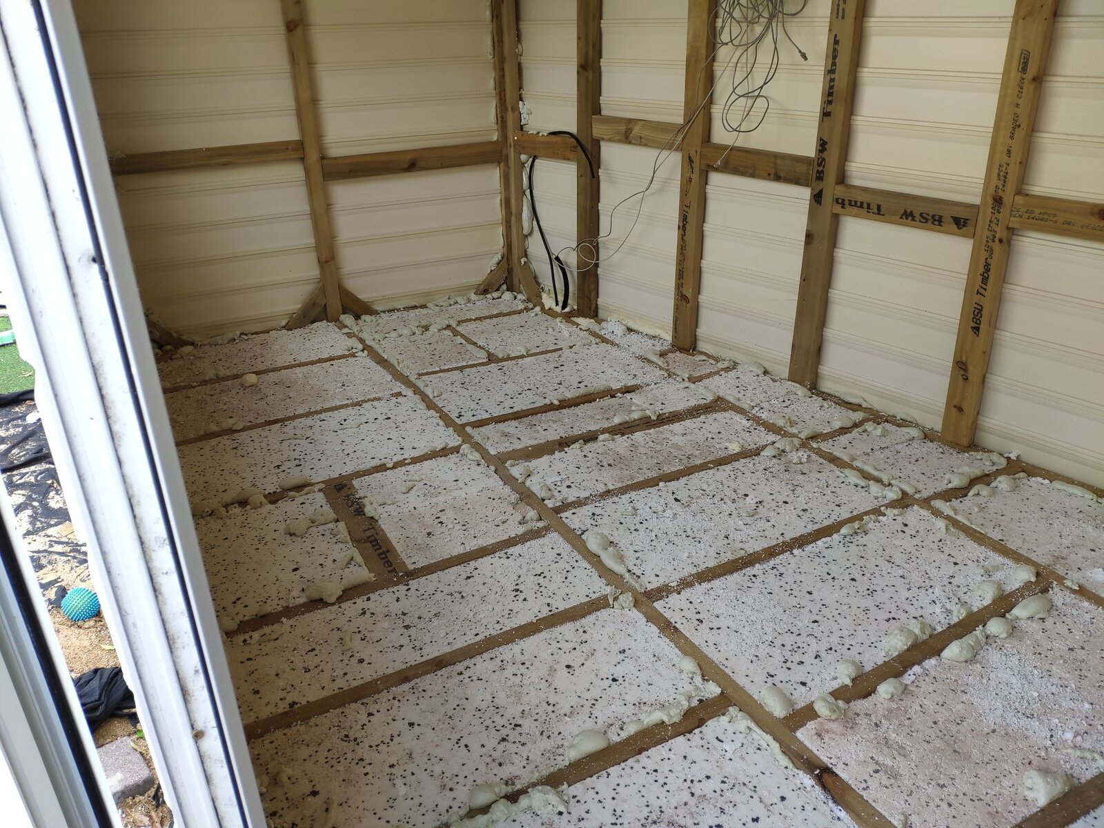

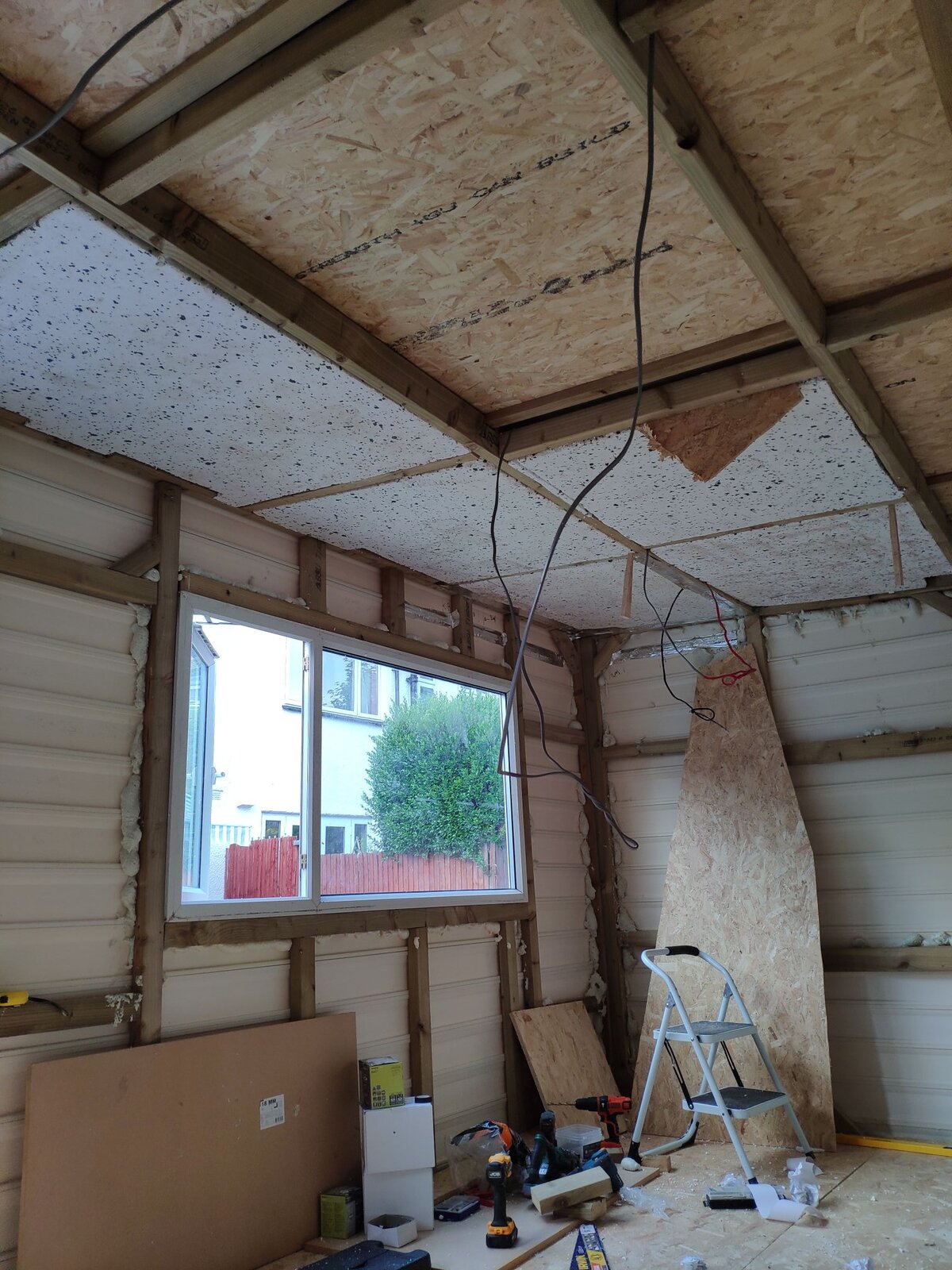

Step 5: I started with the floor insulation - i used jabalite for this as i got this free again from a build project. It was random odd sizes, but i got enoguh to do my flooring and roof
As you can see on the right hand corner side, i pulled in the electric wires there as well as network wire to provide full speed broadband in the office - this needs planning and is always easy to do at build stage than doing it later.
Also you can notice that foam falling from teh sides - i used a few cans of expanding foam to make sure there are no gaps anywhere

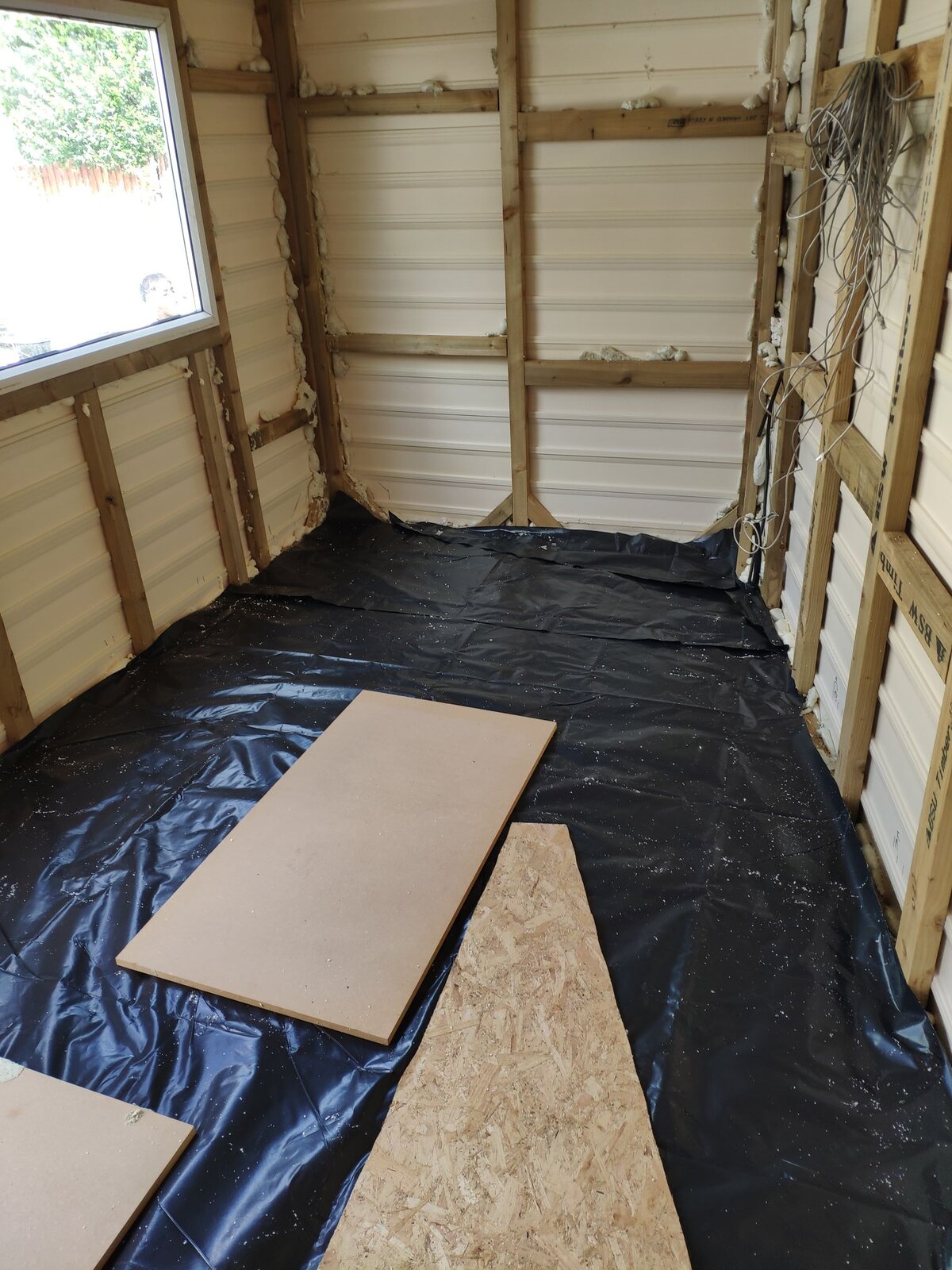

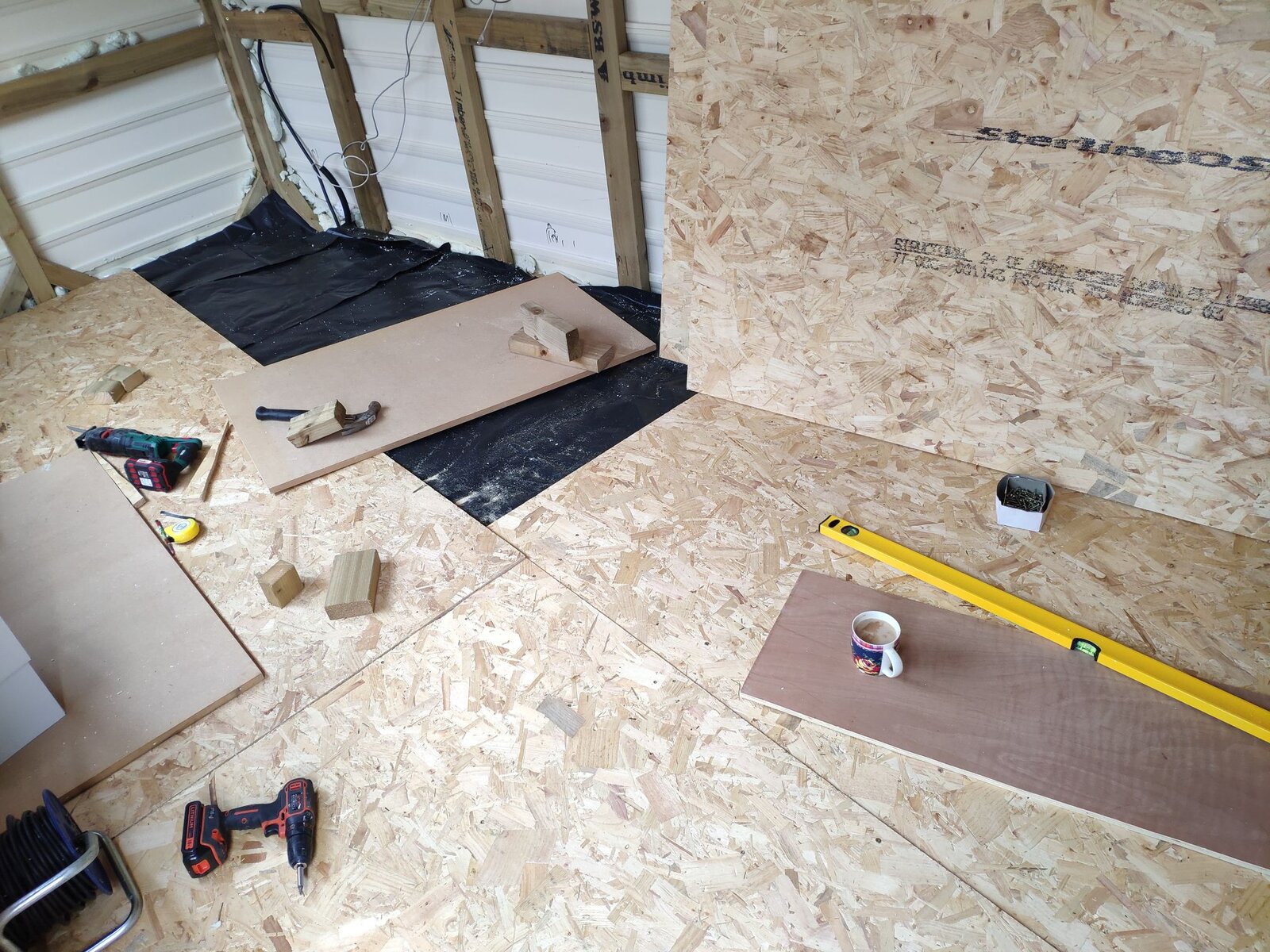

Step 6: Flooring - before installing the flooring, i stuck a waterproof membrane on top of the jabalite, alumium foiled to the sides to avoid any cold air and condensation
BIG TIP : Remember i mentioned the prep - make SURE your floor base is on same size as your floorboards (ie. if you buy a 2200cm floorboard, install the joists accordingly so that you can screw all edges of the floorboard to the base), do not let the floorboards hanging - i had to pull things apart as i realised this too late and had to re-install joists in the base to get that solid stable flooring

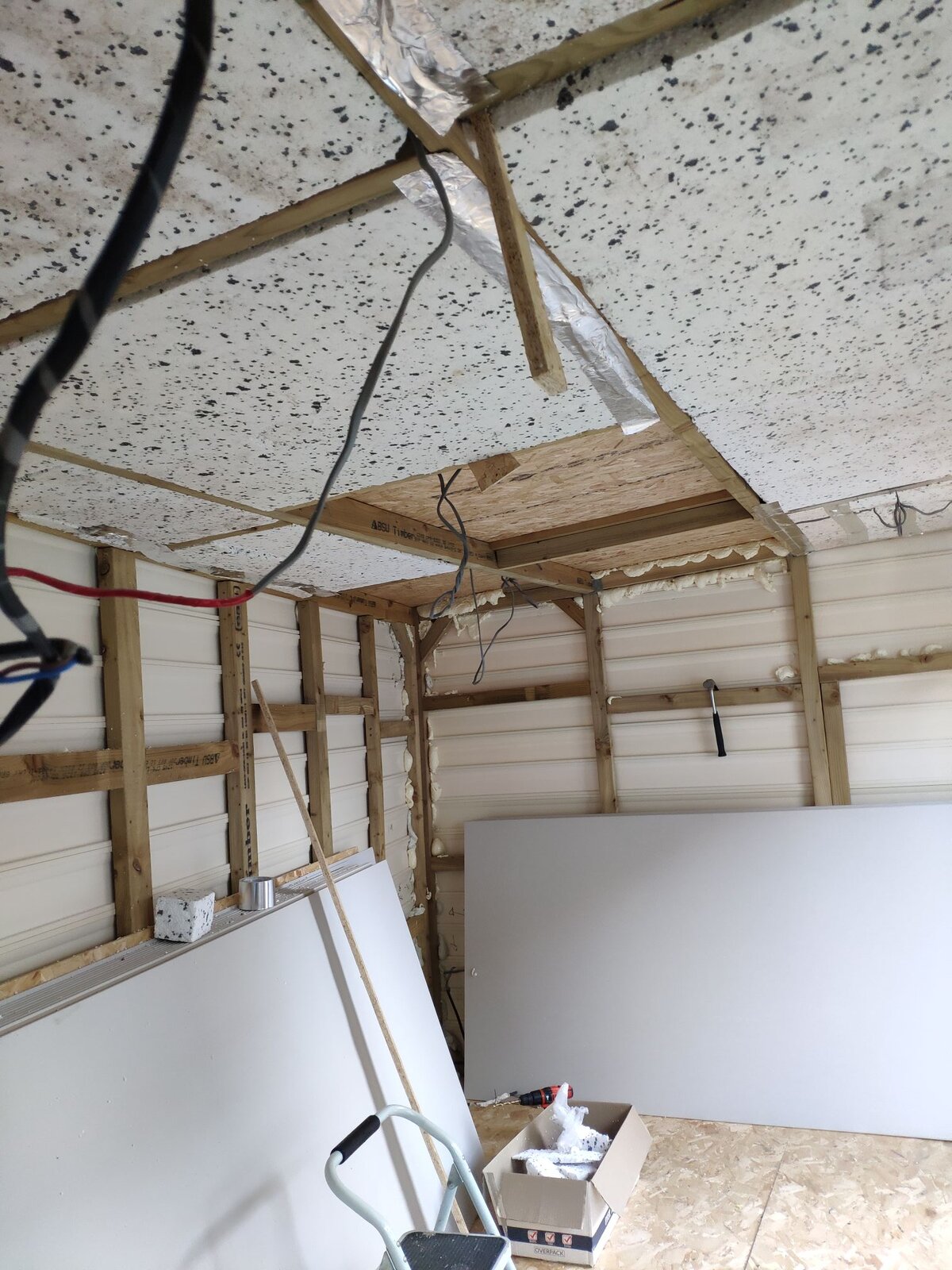

Step 7: Roof jabalite - make sure to wear a hat as these things keep falling - nothing special here i just cut to size and attached it to the top
but once more, get the wiring through before doing all this as its easier to plan for. I was going to put led lights so put the wires through accordingly

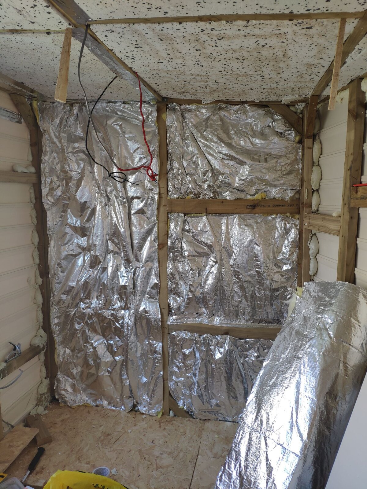

Step 8: Wall insulation - i just used a simple aluminium foil insulation - these are usually for airconditionning and are not the most insulating - but worked for me given the price benefit, and as mentoined above, despite the cold weather this remains the warmest room in the house!
I have now covered all walls - roof and floor with membrane/plastic to avoid any condensation. Works so far with no condensation - but then again its only been a few months

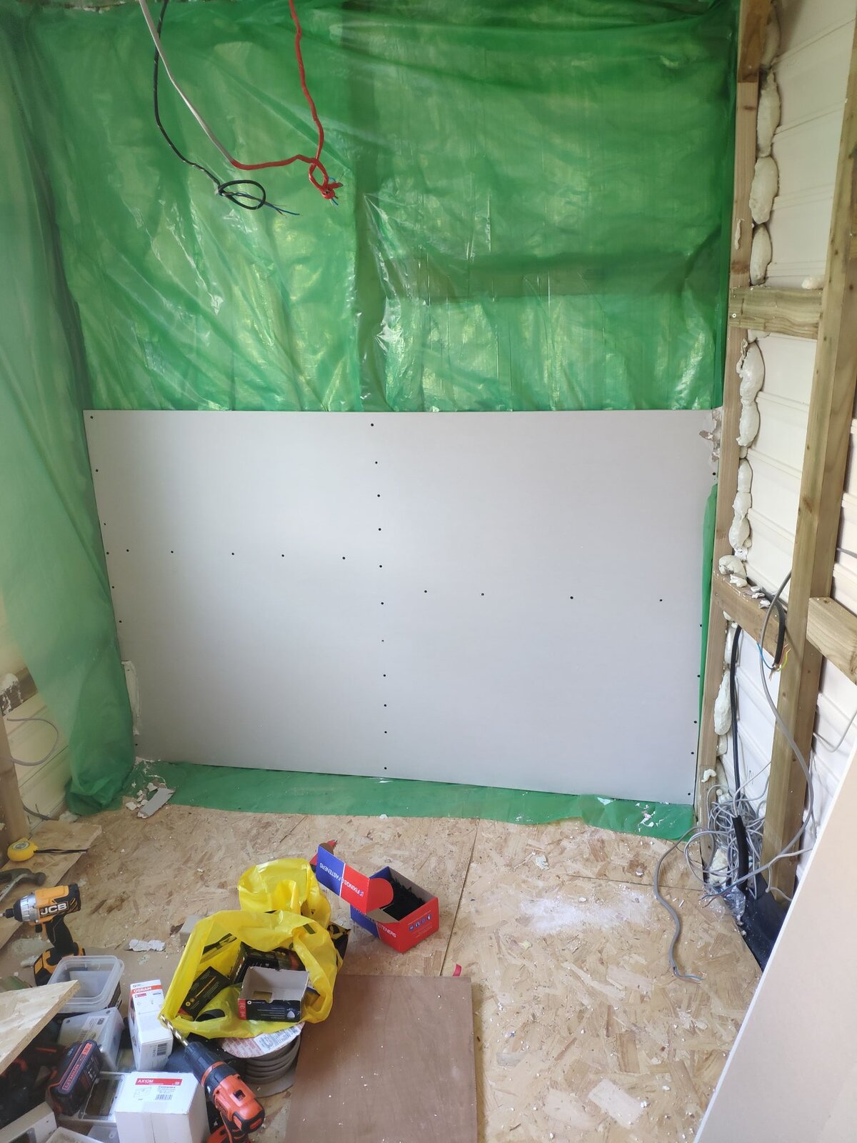

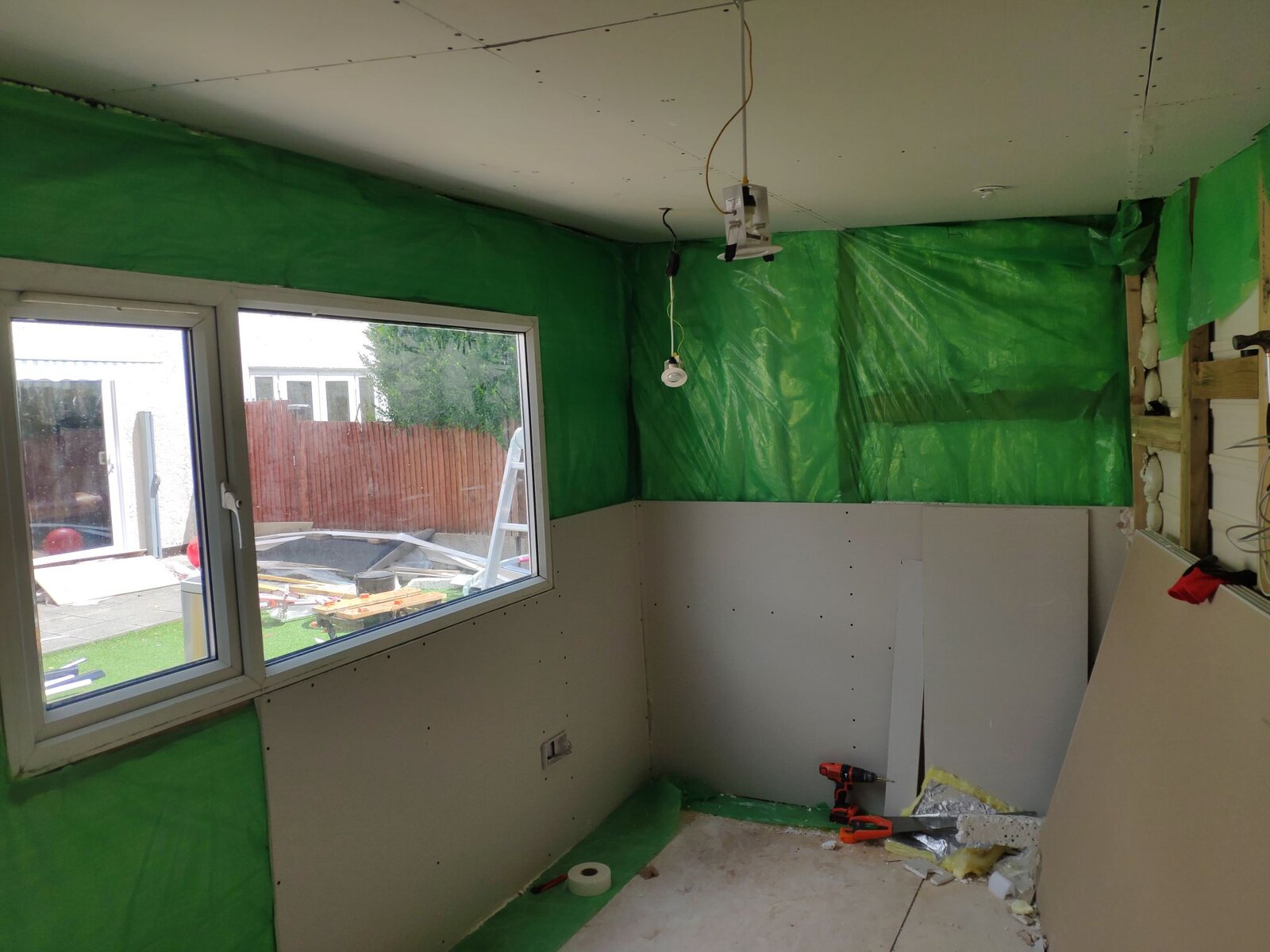

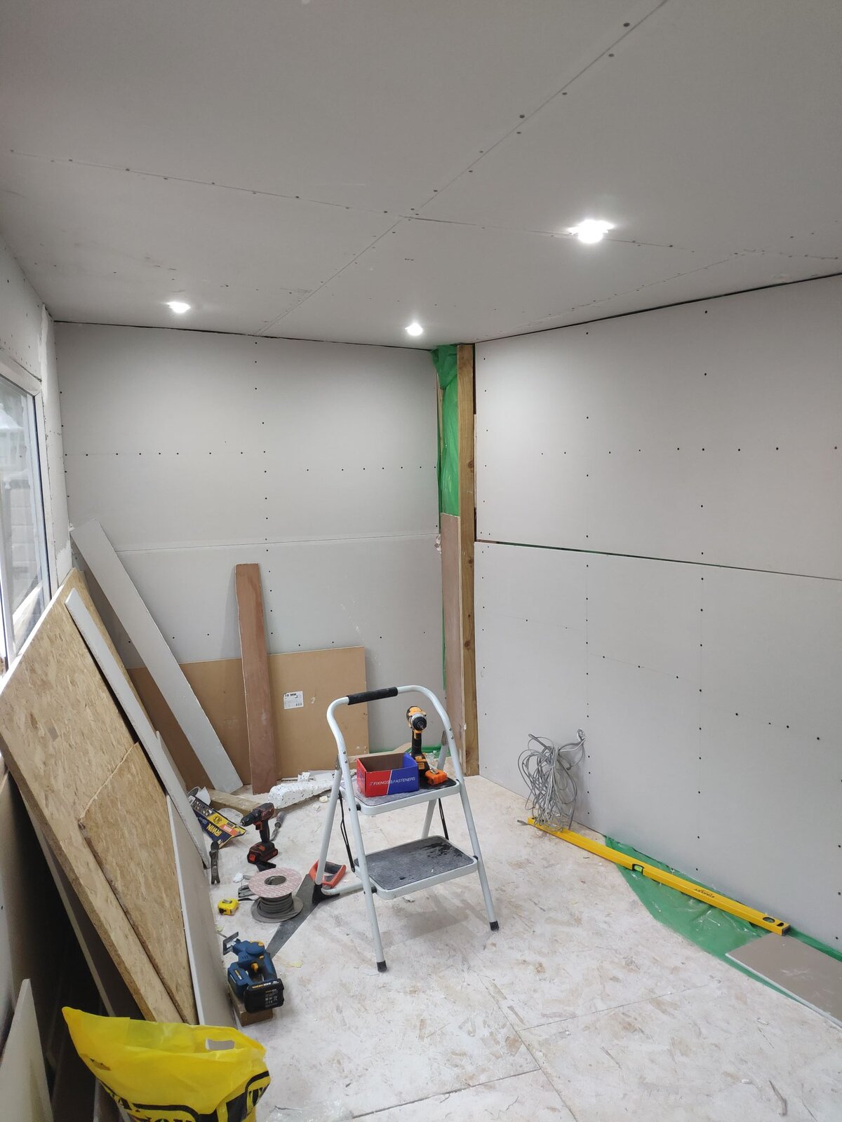

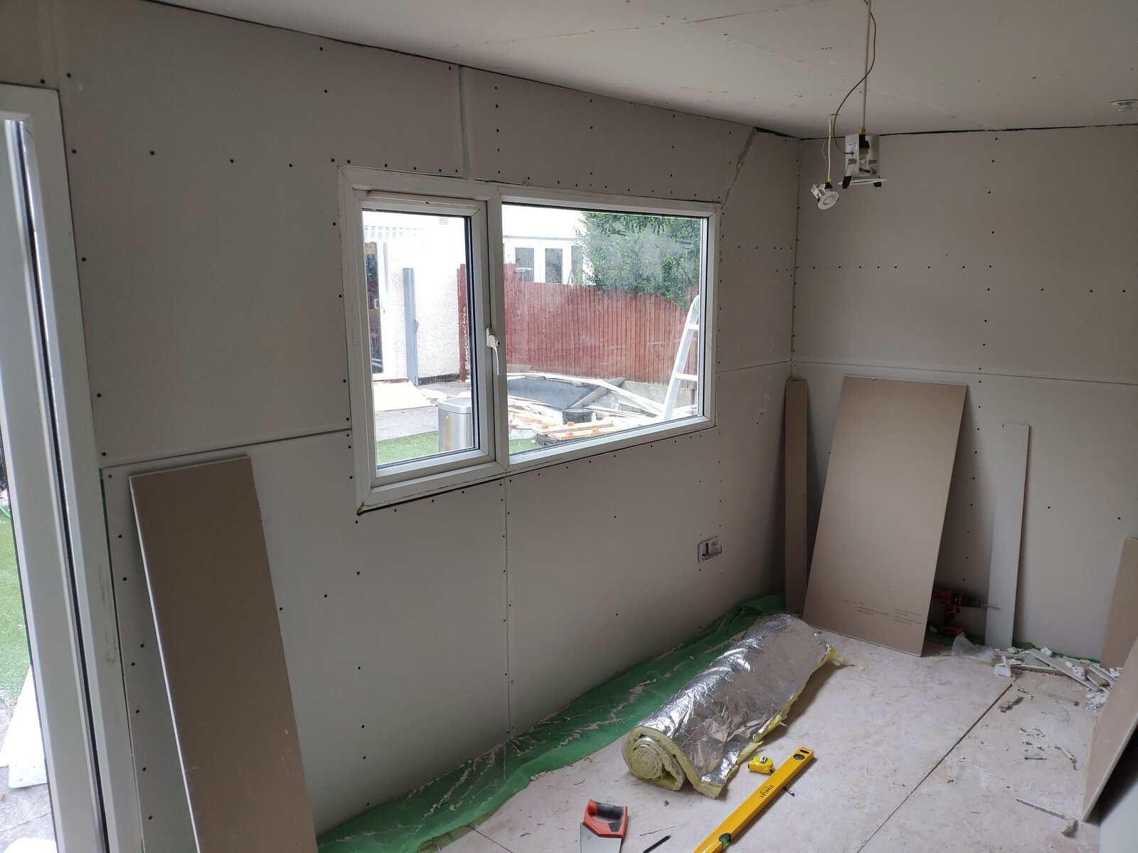

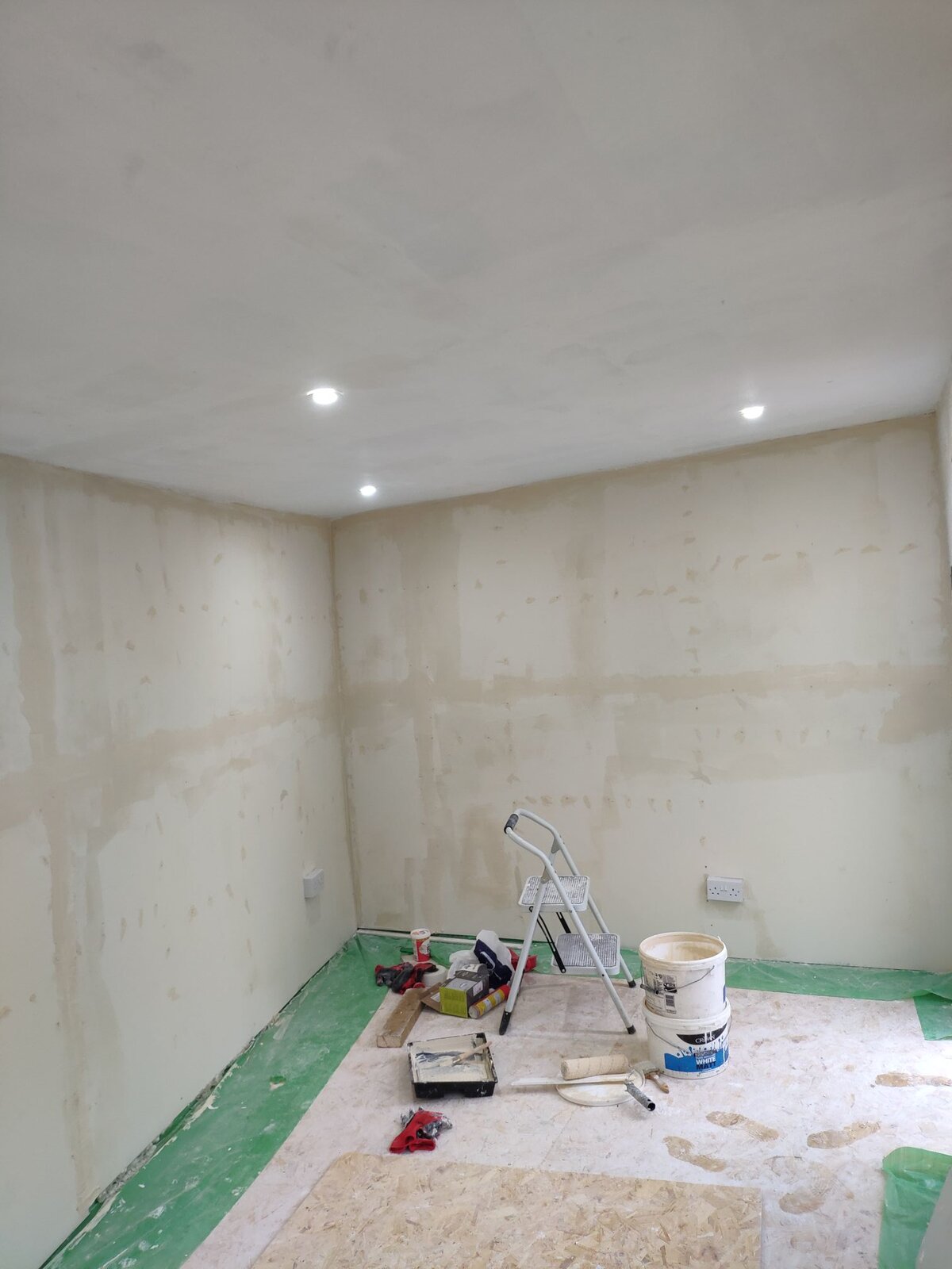

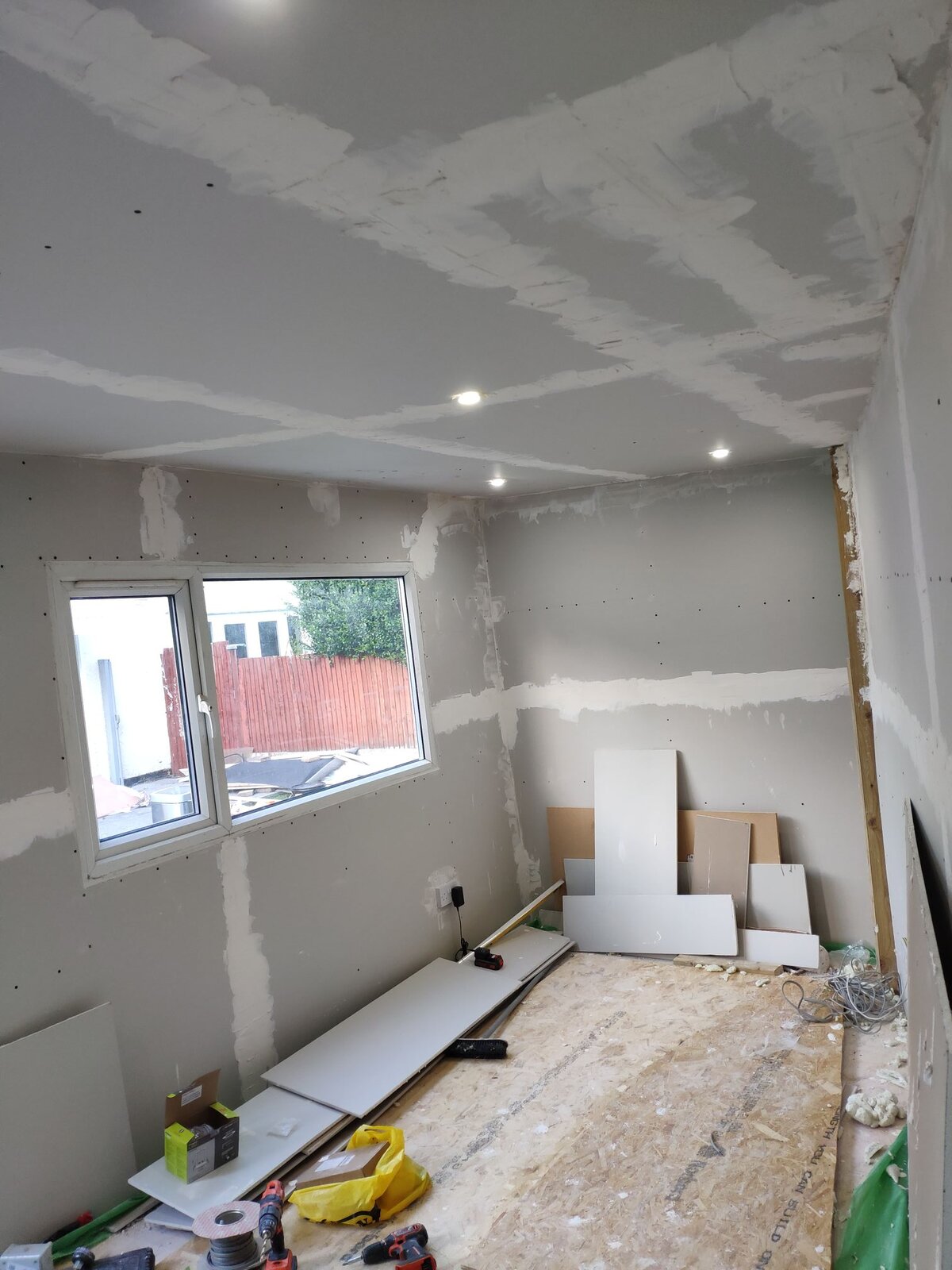

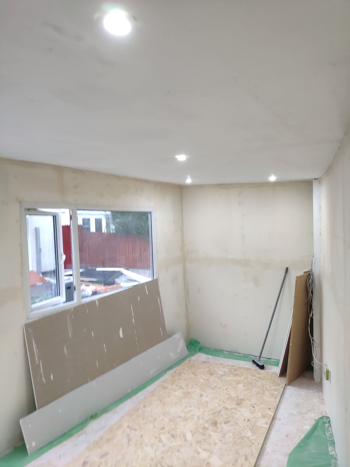

Step 9 - getting the walls ready
this will be fun part too, as it starts to take shape.
I used simple plasterboard across the walls and roof
IMG_20200629_123702_compress29.jpg IMG_20200629_183727_compress15.jpg IMG_20200704_195923_compress9.jpg

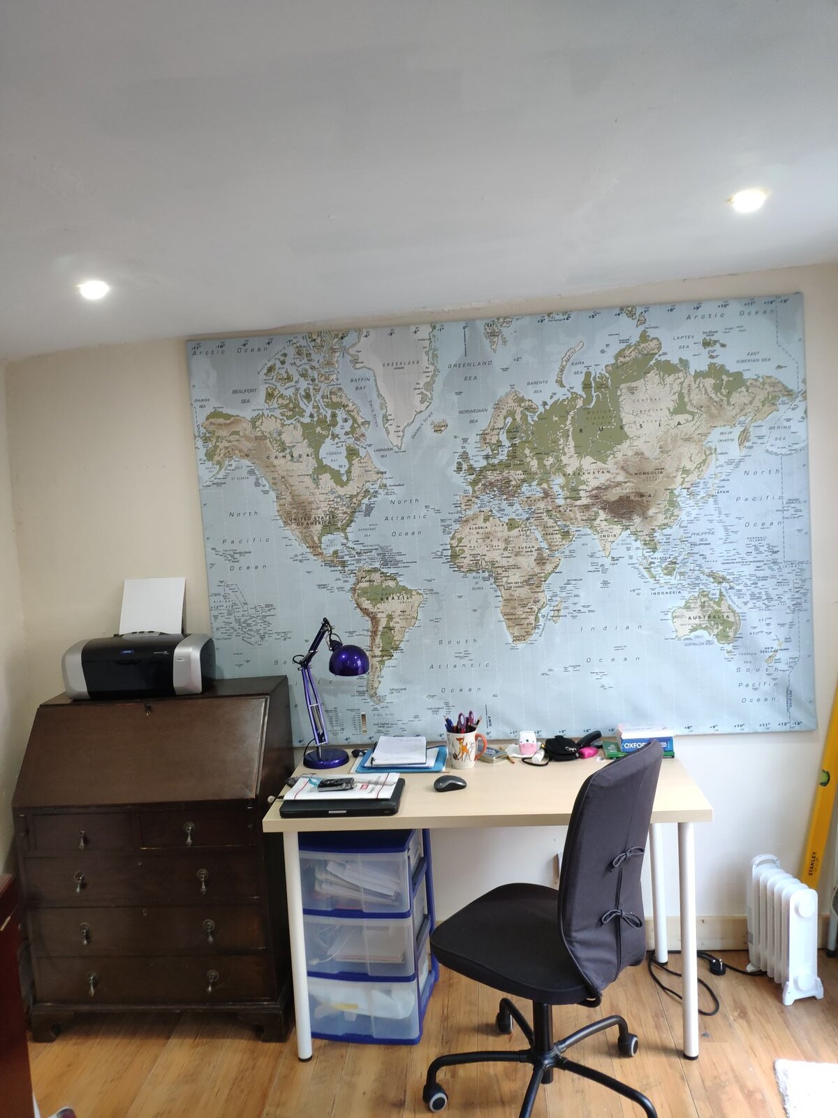

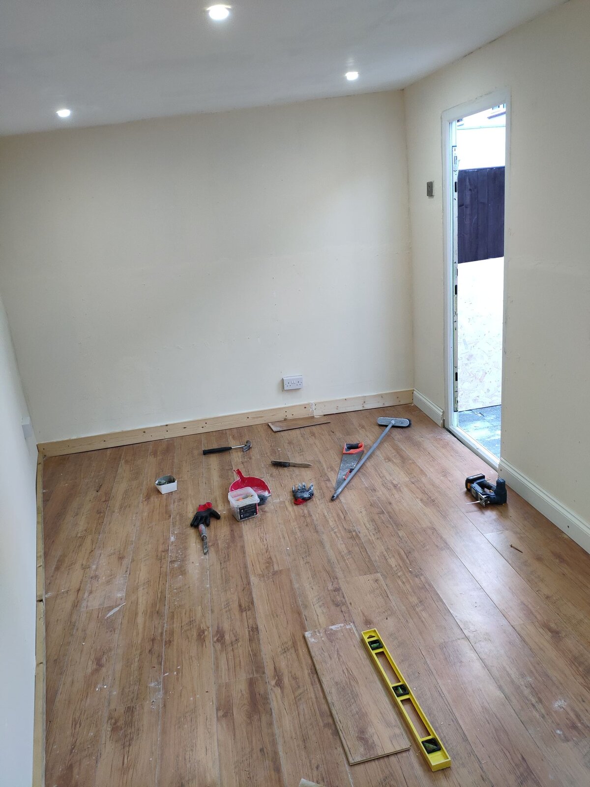

Step 10: Complete finiishing
fresh paint - floor board - et voila! we are ready to work
IMG_20200708_201820_compress33.jpg IMG_20200708_201841_compress10.jpg IMG_20200711_204238_compress93.jpg

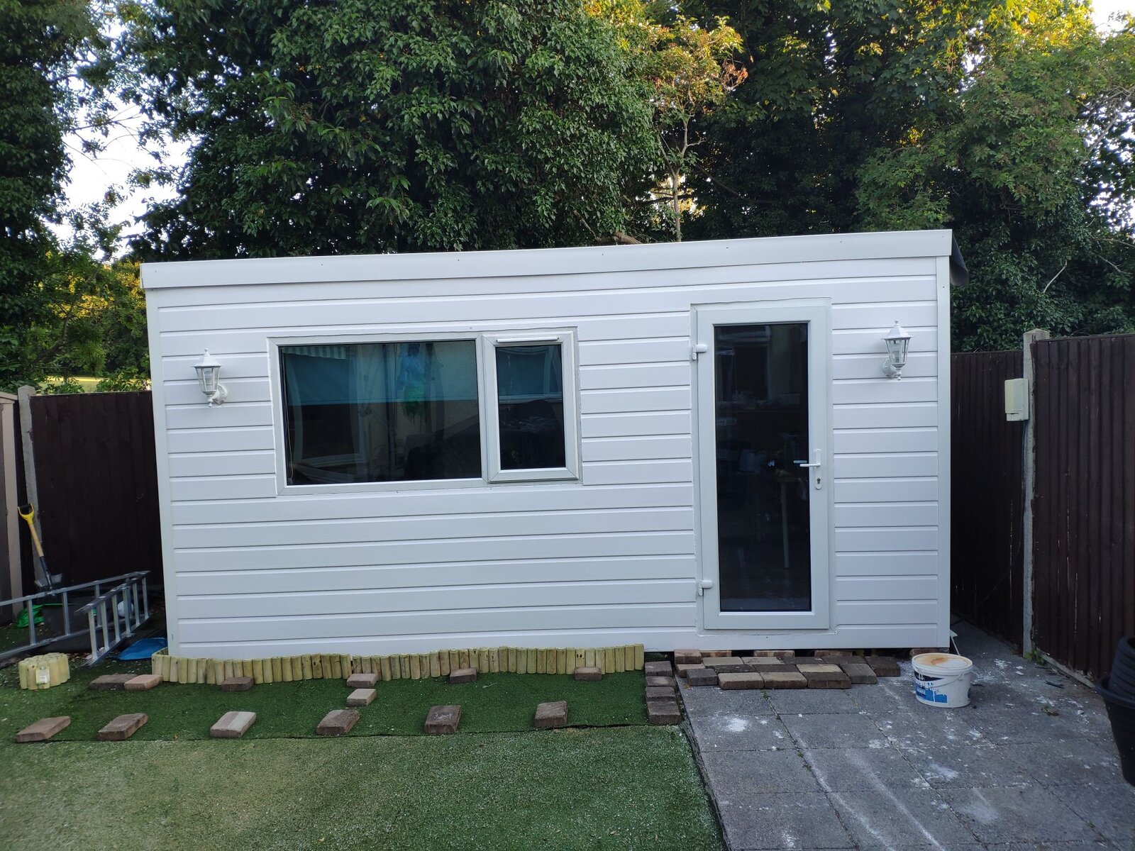

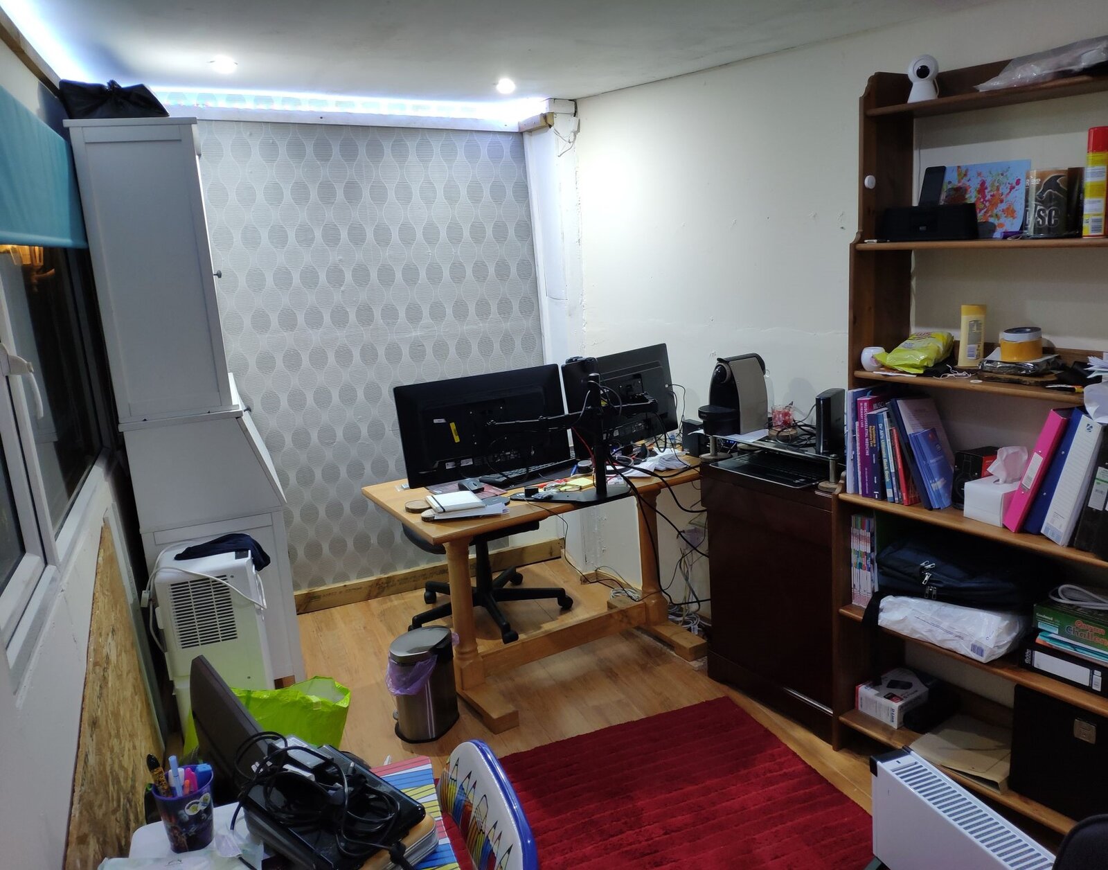

And now the final result from the outside - the kids desk corner, and my desk corner - keeping an eye on them :)
