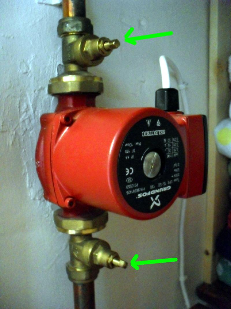

My central heating boiler pump is a Grundfos. It is not a combi heating system and we still have a working immersion heater/tank. After problems earlier in the year which has now been very expensively repaired, I am starting to notice that when I am in the bathroom, which is were our boiler is, or, in the adjoining bedroom, there is a noise coming from the boiler. On close inspection this appears to coming from inside the Grundfos pump and seems to sound like a gurgling / bubbling sound. Is this safe and how can I stop this noise which very annoying in bedroom.

sounds like you have air or gas in the circulating water. Bleed all the radiators, plus bleed the end screw on the pump (all turned off)
see what you get out.
Also go and look at the feed and expansion tank in the loft is it full and clean (no mud or slime)?
is there any reason to suppose water is pumping out of the vent pipe over the top when the pump is started up or running (tie a bit of rag round it and check again after a day or two
When you bleed the highest radiator in the house, does water squirt out forcefully?
When did you last add chemicals to the F&E tank, and what were they?

I have checked the tank and all seem fine up there and I have bled the radiators. I am unsure as to bleeding the valves on the pump so have uploaded this picture, are these the valves I open ???
This is the area which is noisy and bubbling or gurgling and its still just the same.
no. those are pump valves, which you close if you need to take the pump off.
to bleed a pump, turn off the system, then undo the silver screw in the middle of the motor end of the pump. Water may dribble out (it will not squirt out) and you may get air first.
there will be an arrow cast into the side of the pump at the pipes end. Is it pointing up or down?
