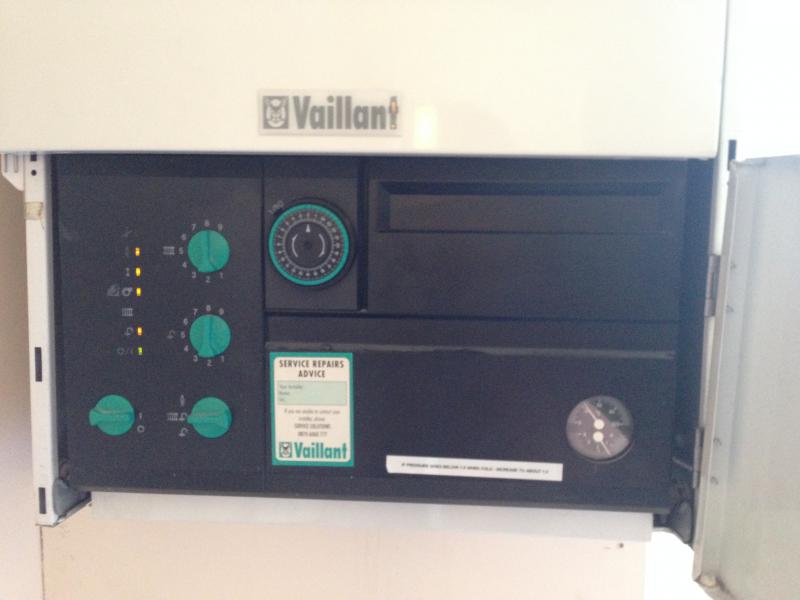

Picture of boiler would help. Possibly diverter valve letting by on boiler or restriction inside boiler.

Here is the boiler...
[/img]
Turbomax. Lovely.
When you turn on a hot tap, does the light on the boiler with a tap symbol come on?
My guess is diverter valve passing. Good boiler. Worth repairing.
