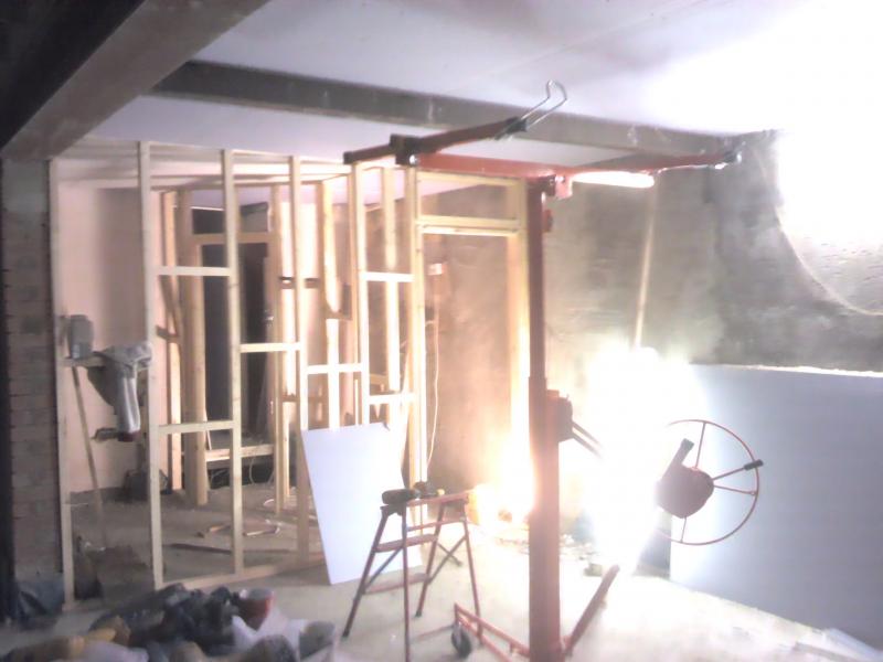

Have been working on my house for a while but not got round to taking pics. Today was quite productive so took a pick of what have done. Double boarded ceiling with 12.5mm standard plasterboard and then 15mm dB plasterboard. All screwed to resilient bars. About 15 square meters. Not bad considering I turned up at 1.30 and included alunch break at 2.30 and coffee break at 4. Finished by 5.30.
Wish I had use of that board lifter! Balancing on head and broom sticks for me :LOL:
