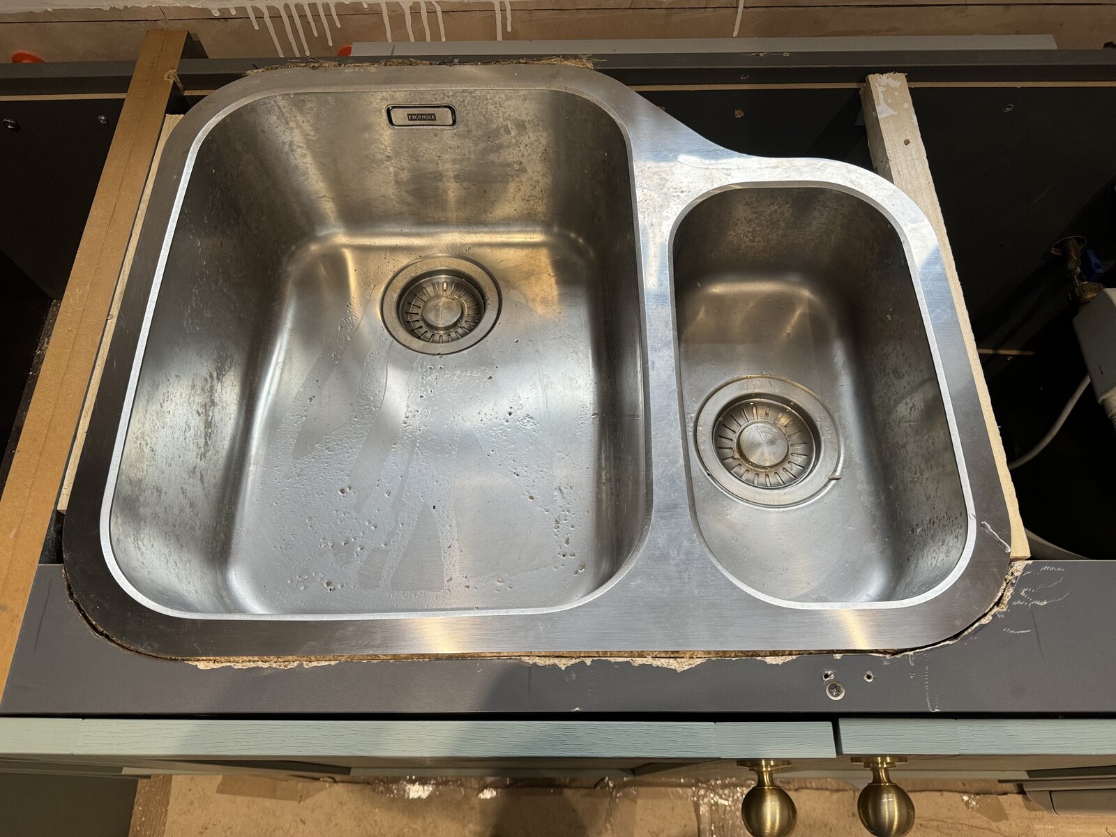

Under instruction from the worktop fitter, I nibbled out some more of my sink unit to get the inset sink flush with the top. I suppose I’d better seal the raw chipboard now - any recommendations on what to use?

Foil tape to seal the edge. Or, for a belt and braces approach apply a liberal layer of silicone and then apply foil tape.

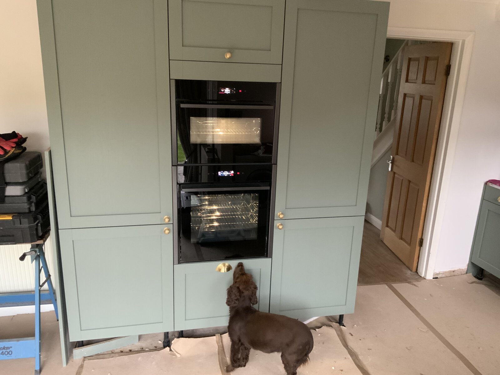

Your dog looks cheesed off!! He wants his kitchen finished!!!
Yeah, she's got the 'ump because she's confined to the lounge as she keeps padding through all the sawdust and walking it around the house. Also, our kitchen bin used to be one that came out from under the sink when you opened the door. Until we get sorted again, we are just using an old bucket with a bin liner and she's taken to delving into it. She's 12 on Friday and she’s just started scrounging for scraps!
Waterproof PVA.
for 'belt n braces' PVA first, allow to dry then kitchen or bathroom grade Silicon or CT1.
The PVA will penetrate into the timber a little so does improve the protection.
Varnish, I prefer oil based with a bit of dye in it so to see where I've been.
First coat is sucked in by the chipboard, second coat seals it.
Tell the worktop fitters to put silicone around there before dropping the worktop.

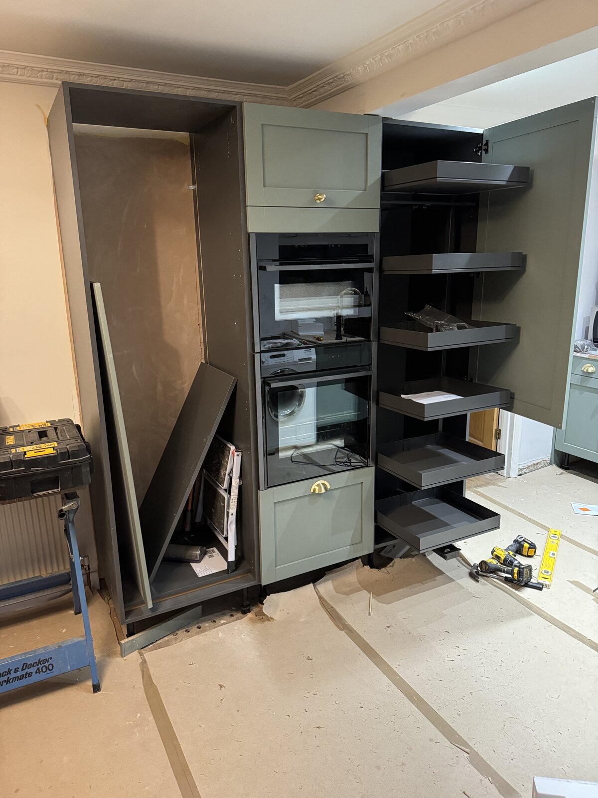

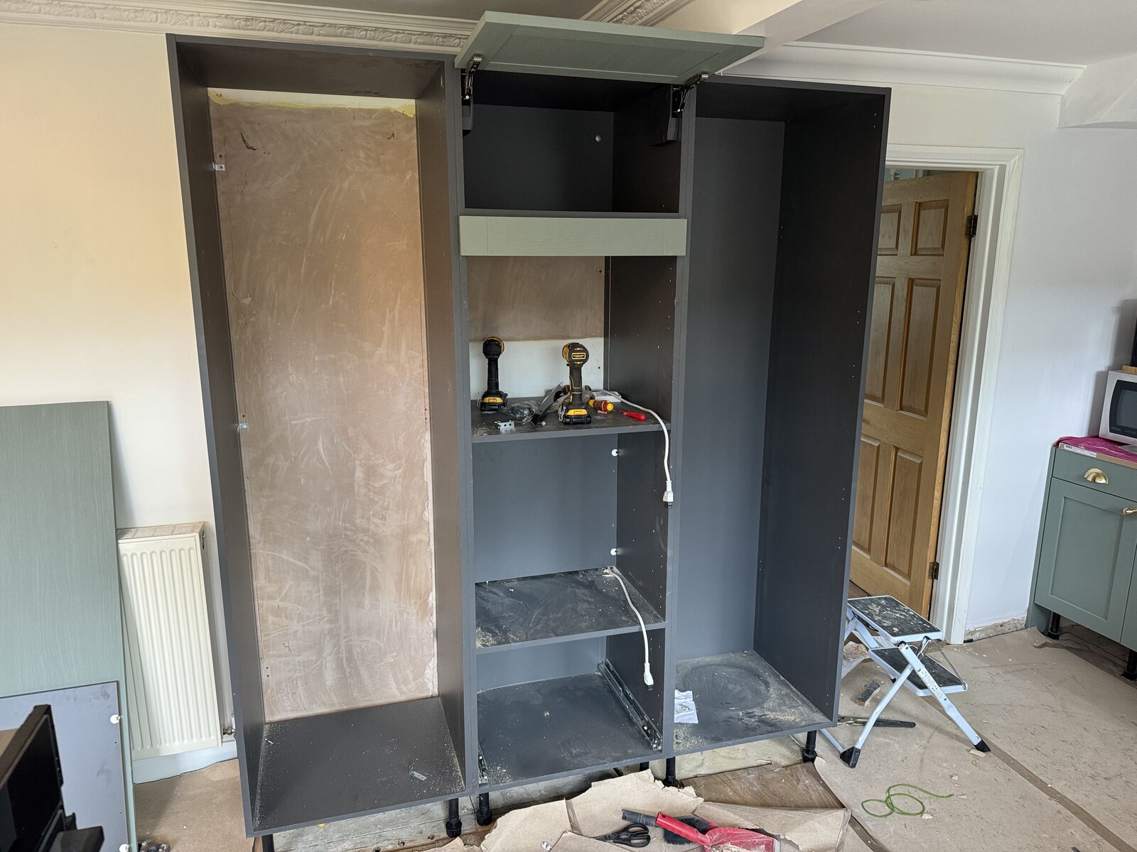

Took the ovens out, yet again to straighten up the oven housing. I swear they are getting heavier! I got the sides straight the first time but completely overlooked the fact that it was leaning out at the bottom which would have showed up even more when the end panels were fitted. I ended up having to chop some plaster off the wall up to about a metre in height to correct it. Nothing's ever been straight forward on this job - everything has needed piddling about with - the wiring, the plumbing, the waste, the soil stack, the plastering etc etc. is this normal when fitting a kitchen?
Anyway, ovens are back in - I'll connect that circuit up tomorrow - fridge and larder housings are in, straight both ways, I’m going to hold up fitting the fridge/freezer in because I need to fit the tall end panel which has to be screwed in from inside the fridge housing but at the moment we are using that panel (in its packing box) as a worktop!
Yes Mottie, it happens to every kitchen fitting, some worse than others.

Saw some results at last today! Fitted the fridge freezer in its housing ( only temporary at the moment as it will have to come back out for me to screw the end panel on), connected up the cookers and built up the larder unit. Mrs Mottie has actually given me some praise and the dog likes it too - just the right height for her to get at the dog treat box! :)
