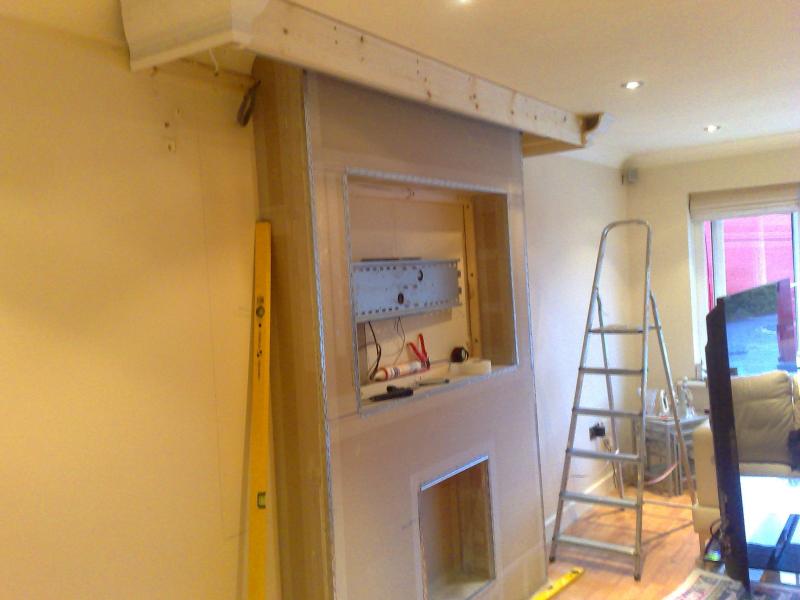

The above pictures show the beginning of my New Home Cinema setup which will include a 50" Plasma, Epson Projector with Electric Screen and trigger, etc. I own a building company and do many home cinema & Av installations all over the UK. I am one of those sad persons that loves his work and insist on high standards.
After reading and reading the many impressive threads in these forums I thought it was time to post my little project that was started late November 2009.
I will start off with some photo's and will add content as and when as required. At the same time I also welcome any comments or idea's as my project will be ongoing for some time.
My own specification was to have all my AV equipment in another room with no cables on show. This would include the Sky HD, Denon 1610 AVR, HDMI Splitter 1 x 4, Blueray, PS3 etc.
The Plasma will be going into the chimney breast recess, this will then be covered over when the electric screen drops from the ceiling. One of the reasons for buying a Plasma was due to the costs of replacing projector bulbs as we were using the projector nearly all the time. Once you get a big screen you get spoilt!
I started off with taking down my existing screen that was fixed to the wall.
The project started off with the building of the false chimney breast.

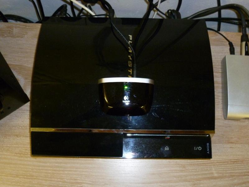

Just an update, I would really reccomend the PS3 adaptor for the Harmony Control. Mine is placed in another room (garage) and works flawlessly.
I get all 51 commands from the PS3 on my Harmony control. All you do is pair it up, then go into settings on the PS3 and it finds itself. I can now control the PS3 through the Harmony and turn it on and off.
Great bit of kit.
