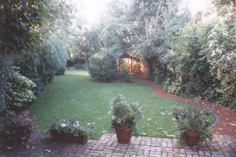

rottie - I built a pergola 25 years ago and set the posts in BROWN metposts (not the red ones) ... all very discrete! The thing is still standing ... solid as ever. So I suggest you drive the mets in, then lay the slabs. My paths are edged in stable cobbles with red gravel infill; the path has a series of shallow steps out the otherside of the pergola leading to the rest of the garden. I used slates on the roof and the 4 hips have 1¼" wood rolls nailed on then these were dressed in lead. By the way, the bright light showing at the pergola is the morning sunshine.
