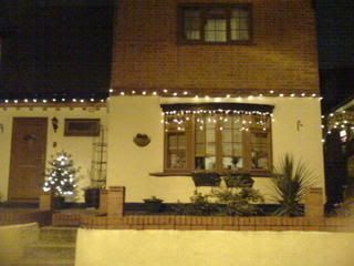

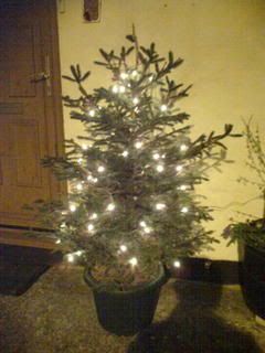

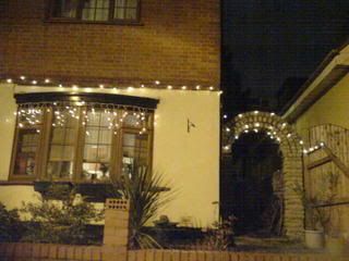

posted a little late now, but here are some pictures of my outside xmas lights.
Outside xmas lights
Outside xmas tree

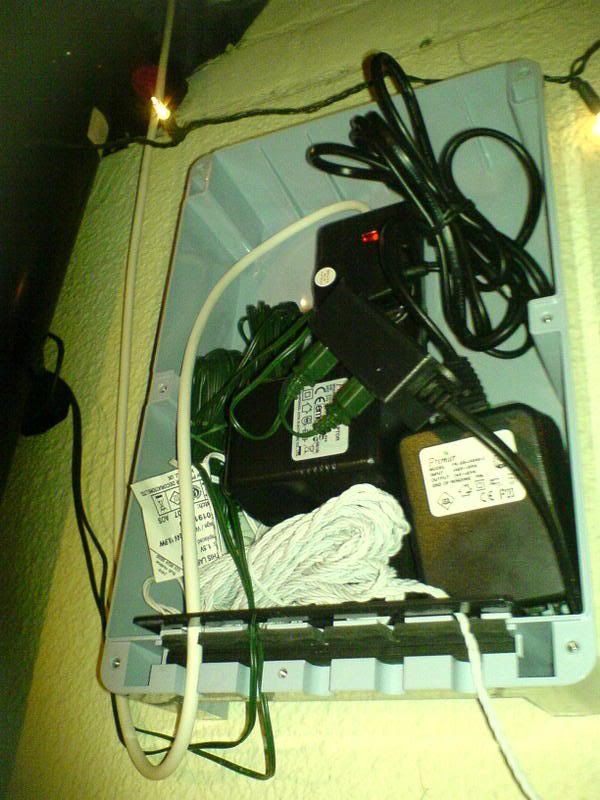

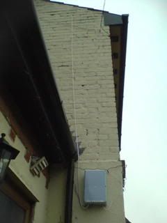

Outside xmas lights power box
Inside the outside xmas lights power box

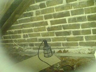

The supply to the outside xmas lights up in the loft
The supply cable to the outside xmas lights

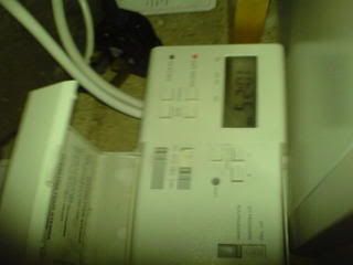

The outside xmas lights timer
The timer is set to come on at 16:30 & to go off at 23:00

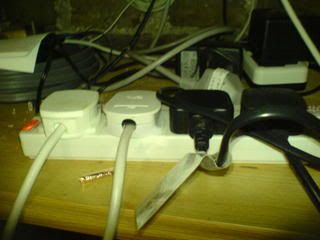

The outside xmas lights plug
The 2nd white plug is for the outside xmas lights

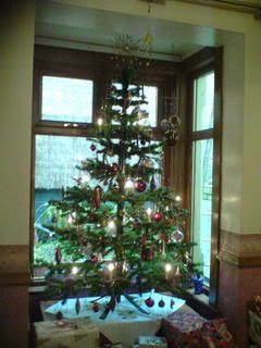

The xmas tree in the dinning room

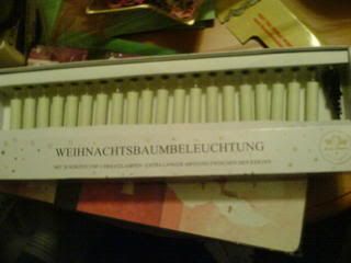

The new lights for the tree (from Germany, & only cost about £7)

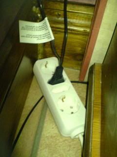

The tree
The plug for the tree lights
Are you posting those pics to show others what not to do?
My concern is the two transformers in a sealed (apparently plastic and there for thermally low conductivity ) box could overheat and fail possibly creating a short between 230 volt and the cables to the lights.
Yea - But atleast the lighting is subtle, and not a farse of elaborate lighting.
The box is one of those IP65 weather proof boxes made by timeguard, which is designed for pond pump or xmas lights plugs & transformers.
Cable installation method 14498-G (Strewn Direct) ;)
The 1mm white flex is temp. for this xmas only, as I ran out of time to put in the 2 gang weather proof RCD socket above the shower room window (the socket will go to the right of the vent above the shower room window, in the pic below)
The front outside socket will be supplied from the loft sockets circuit, in 2.5mm HiTuf, & will be clipped up to the wall in the loft & outside. So next xmas the weather box will also have a timer in it as well, & it will just plug into the front outside socket.
Central heating time clocks don't have hugely rated contacts ;)
Many just 3 amp, and not inductive.
Just a pointer ;)
