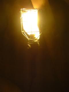

Here are some pictures of the loft lights which were already installed, in the flat which my Nan & Grandad have just moved into.
The 1st Light

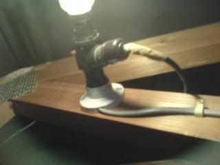

The adaptor in the 1st light, which supplys the 2nd light

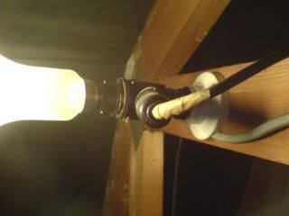

The 2nd Light

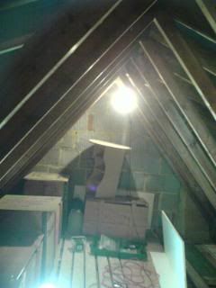

Close up of the 2nd Light
The 1st light is a normal batten holder fitting (which is above the loft hatch & is very easy to hit your head on as you stand up), into which is an old 2 way baynet adaptor (the type which used to be used for plugging in the electric iron into the light fitting). Plugged into the adaptor is a 150W bulb in the stright socket, for the 1st light, & into the side socket is plugged a baynet plug which is connected to a old wooden handle handhold light.
The handhold light is on a hock down the far end of the loft, with the cable laying all over the loft floor (on the main walkway). The handhold light also as a 150W bulb in it.
I will at some stage replace the current lights with two 5ft fluro's, by putting a JB where the 1st light is, & then running new cable from the JB to the fluro's.

Is that insulation tape near the bayonet fitting?

Yes I think that it is insulation tape near the bayonet plug, proboaly put there the outer insulation of the flex was cut back too much, or something like that.
I will be redoing the loft lights in the next month or so, replacing the 2 lights with two 5ft fluros.

You mean the original fixed installation? Bar the skirt is missing from the batten lampholder, there's not much more to see. The handlamp and 2 way adapter look like they were added later.
