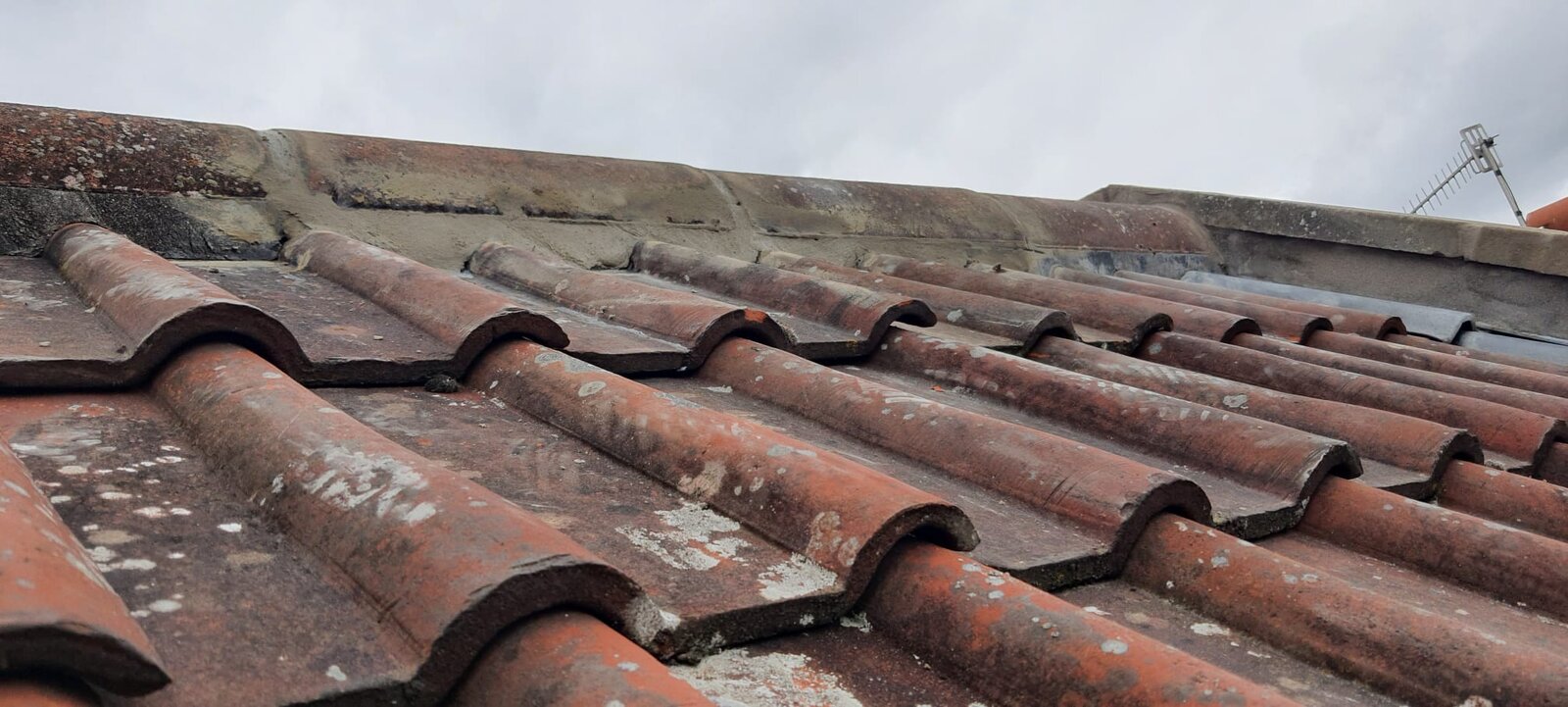

Hi, I have some roofers working on my roof for a repair. The work last four days. They did not use a roof ladder.
During the work, some of the tiles were cracked. They replaced all of them but one. The one that they did not replace was right under the mortar ridge. They said this tile can only be replaced after removing some of the mortar ridge, which they want to avoid. As such they simply used a black material to seal the gap (see the attached Picture 1). Would this be an enough fix? Should I insist them to replace this cracked tile?

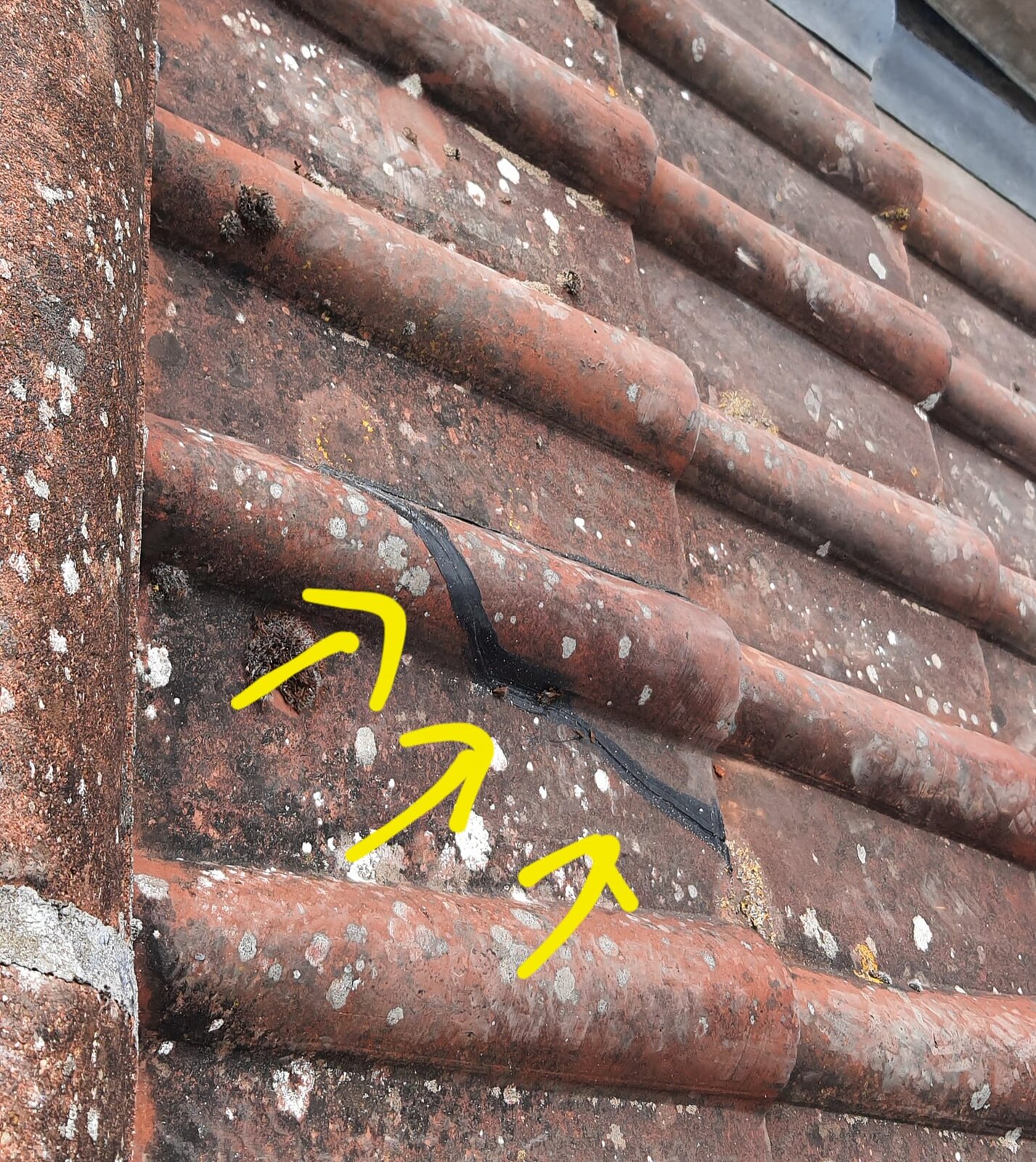

Also, what would be your comment on the fact that they did not use a roof ladder. I saw some books suggested that a roof ladder should be used (See Picture 2)

It is absolutely of no consequence as far as this forum and your question is concerned as to "what they did." They broke your tiles and they should replace your tiles. Also yes they should have used roof ladders although when I had my roof done a while back the roofers who did it did not use roof ladders. Mind you I had all my latts and tiles replaced so roof ladders would have been a hinderance. Those are old tiles and as such will have become brittle and easy to break. That little thin bit of lipstick they have smeared on could well already be leaking or it will leak. If they have to lift the mortar ridge so be it, they broke the tile so they should replace the tile.
If they have fully bonded that tile with adhesive, it should be absolutely fine. Some damage is inevitable when working on roofs I think, a roof ladder won't really help. The repair seems fair enough to me, if it's sealed well. Lifting the ridge would be a fair amount of work, and really wouldn't be necessary.
Part of the reason for the usage of roof ladders, is the avoid damage to fragile tiles, the other being that of safety - something to hang on to when working. It would be no surprise that the broke tiles working without a ladder, if their full weight was placed on the tiles and you should expect ALL damaged tiles to be replaced, at their cost. That repair is just a botch at best, and will not last, it needs a new tile to be fitted, at their cost.

I am debating myself with two contradictory angles:
To accept the current fix:
1. The tiles are not the only defense against rain water -- there is also a breathable felt below, and it can catch any water that breaches the tiles. So the crack may seems more serious that it looks.
2. The cracked tile is the top row and sits right under the mortar ridge (not a dry ridge). To replace it would necesitate lifting the ridge, which may open up another can of worm. ( The roof did replace other cracked tiles that can be easily replaced. )
To insist on replacing the cracked tile:
1. Even though there is a breathable felt below the tile, a cracked tile still mean a weakened defense. Why settle for it?
2. Lifting the ridge is not a big deal for a competent roofer.
What do you think?
Roof ladders do not prevent tile damage totally .they make access easier on some coverings
The damaged tile would best be replaced.
So, how did they actually access the roof ?
There was a scaffold which provided access to the bottom of the pitched roof. The roofers then walked/climbed up the pitched roof.
respect, those doble romans don't take foot traffic well.
did they happen to slip a few out and work off the battens by any chance
Just an update on my roof -- in case you are interested. I insisted that the cracked tile must be replaced, and the roofer relented. It turned out that changing the tile (the ridge had to be lifted) was not that difficult and could be done within an hour. Attached is a picture after this fix.
