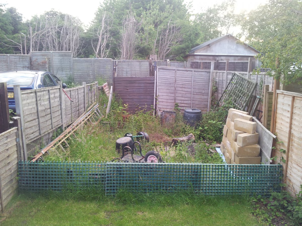

My brick built shed with a 2.3m round door, in my back garden!
This is what I started with .

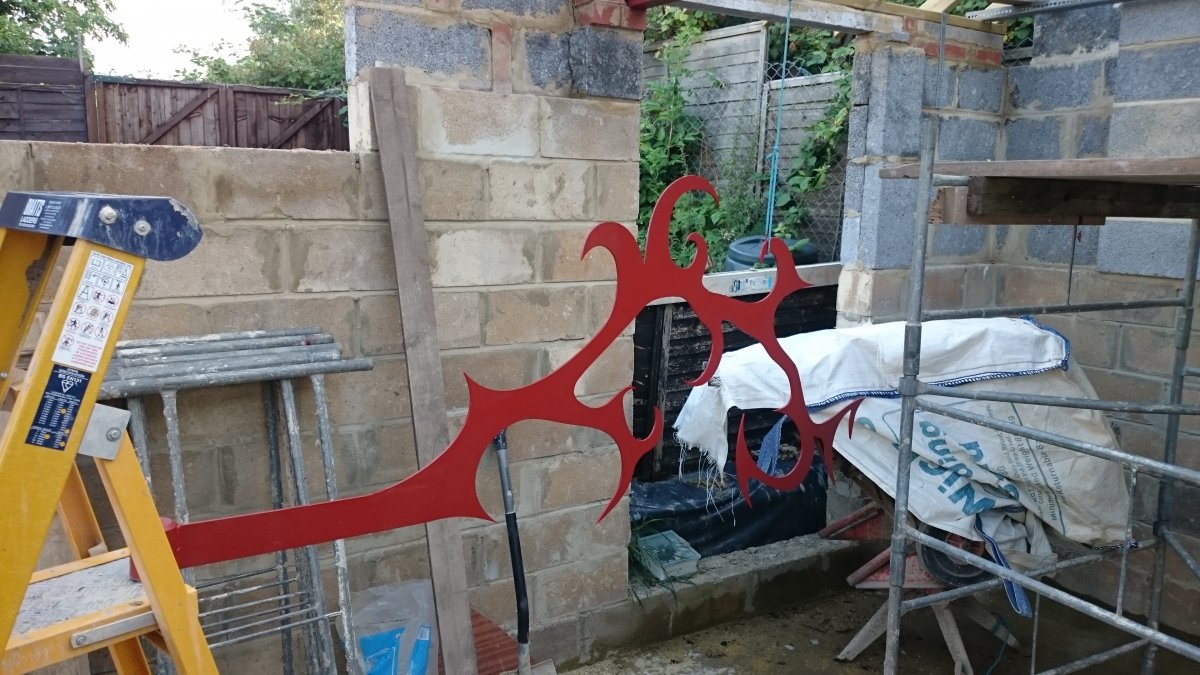

Just wait for the hinges... They are enormous!

Painted up the upper hinge with red oxide. not ready to install it yet but I don't want it rusting away.
these are the hinges. I designed them on a CAD programme called solidworks. I had them plasma cut out of 5mm steel. Then welded them.
They aren't at all like the hobbit door hinges, they are more Mordor than shire!

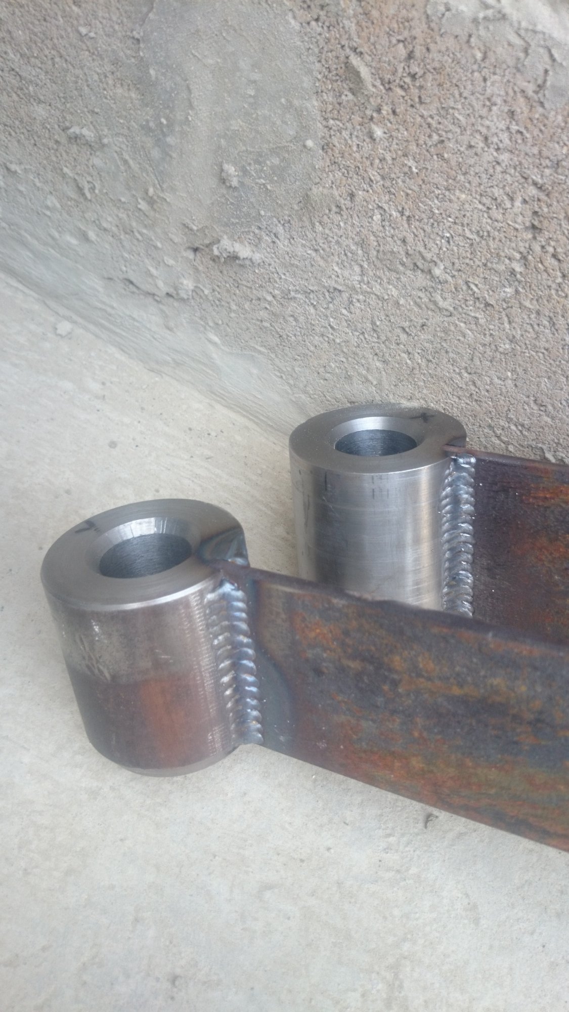

I have been working on the Hinge pin for ages. Doing a little bit on the odd lunchtime or after work.
It essentially a 45mm steel bar with 2 70mm collars welded at each end. Originally it was around 500mm long but I added another 150mm in the middle.
On the ends of the actual hinges, I made two 70mm diameter collars and welded them.
I'm not an engineer, so im kind of making this up as I go along. I always like to over engineer things anyway, its just my way.
