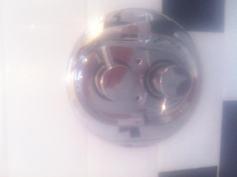

Hi was wondering if anyone could help me I have a bristan mixer
Shower in my bathroom and when I turn it on it goes hot the after about a few minutes goes cold then goes hot again any thoughts
I have tried the sink and the water stays hot constant on that any ideas anyone thanks
New shower, old shower? What model Bristan shower?
New problem, just started or old problem, new house (new to you)?
Type of heating system?
Inside leg measurement?
It's a new house to me just bought it they said they did the bathroom about 5 year ago but never mentioned the problem and since I have had the house 4month it's been doing it not sure on shower model and its just a combi boiler thanks
Have a look at the cold mains stop tap making sure it's fully open.
Might not be the fix this time but I've certainly come across a few situations were it as been.
servotech,
I'd run a hot tap elsewhere in the bathroom. If it doesn't suffer similar fluctuations then I doubt it's your boiler.
More likely your thermo (blending) cartridge.
I reckon the blending cartridge has had it. It'll be a plastic thing behind the temperature control knob. They normally unscrew or pull out.

You have said nothing about your hot water source!
If a combi boiler then turn down the hot water temp know a little!

1 Clean your shwoer head or change it if in a hard water area.
2 Combi boilers are sensitive to flow and as such if too low will will turn on and off repeatedly. Getting the flow rate up will help.
That's particularly the case if the boiler is not serviced regularly.
Many of those problems are due to the shower head holes not being kept clean!
Running a hot basin tap at a half flow is likely to cure the problem on a bodge basis.

I actually just put the sink tap on half and the shower stayed hot any suggestions on the problem thanks ?
