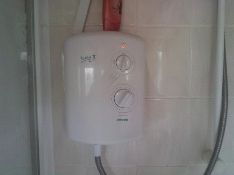

Now, I have an IvoryII. On turning the power off to it at the pullswitch, the water does not run at all.
Which means the fault is within the shower.
(Out of interest, does the power light stay on on yours all the time too? Ours always has.)
That switch never gets turned off. :LOL:
So why on earth did you ask "Out of interest, does the power light stay on on yours all the time too? Ours always has."?
Surely it's no mystery to you that the power light is always on on yours when you never turn the power off? :rolleyes:
Because I am perplexed that despite the fact that the knob on the shower is turned to OFF, the "power" light remains lit! It seems a completely daft idea. Its almost like its in standby, when it needn't be because it has no remote control! :eek:
Err...
It's to tell you that there is power being supplied to the shower!
If it were worked by the shower on/off switch then it would come on when you turned the shower on - don't you think that the sight and sound of water spraying out of the shower head would be enough to alert you to the fact that you'd turned it on? :rolleyes: :rolleyes:

I wont. This is why people fall out with you though ban. Dont you think its a little wasteful? Having another LED burning 24/7? Bearing in mind, we're not the only people in the world who dont turn off their shower isolator.
