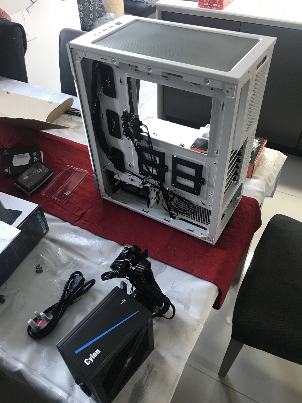

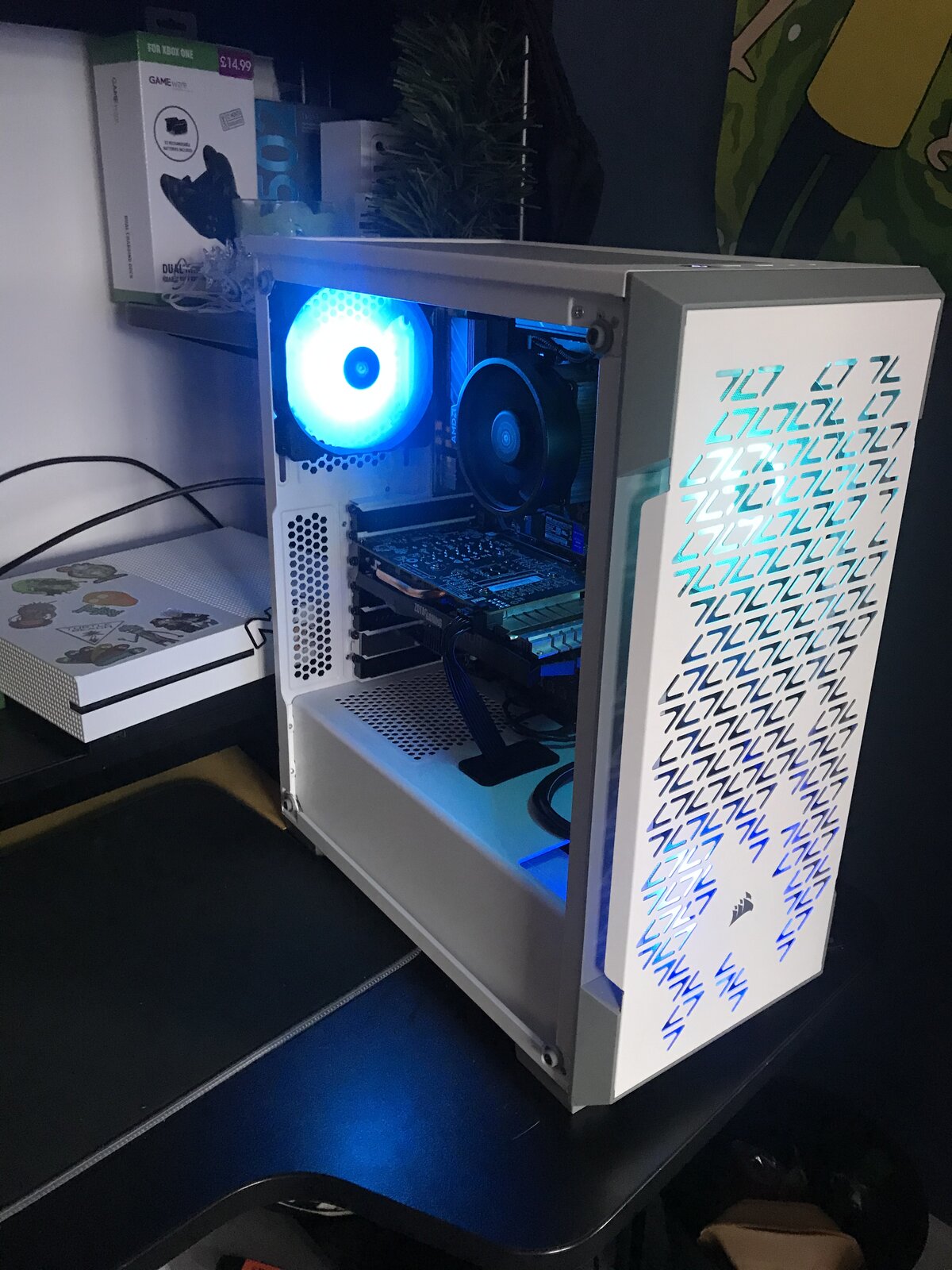

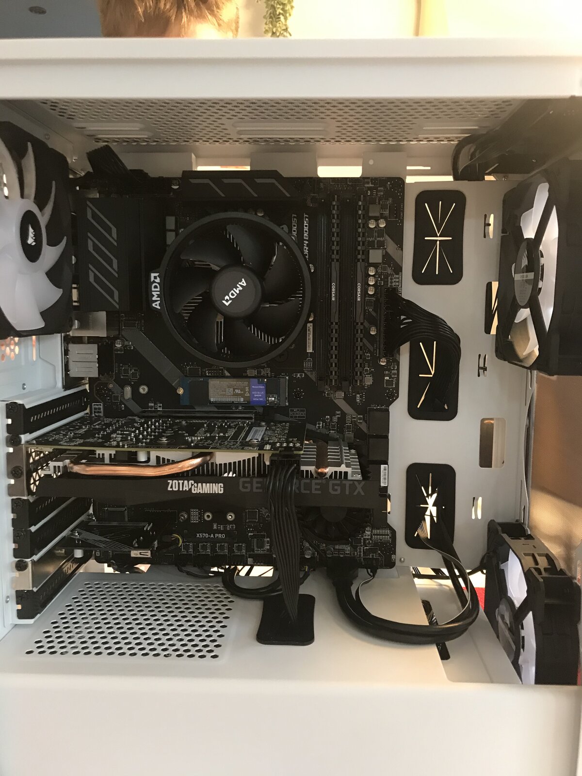

My son wants to build a gaming computer
I’ve now got the x570 motherboard, ryzen 5 chip, 32gb of ram, 700w power supply, a 500gb ssd memory card and the 1660 graphics card he already had.
I think I’m missing a HDD hard drive, the case and operating system.
Can anyone recommend a good HDD? Ebuyer seem really good with price and delivery but not sure exactly what I’m looking for. If I swapped his hard drive accross to the new machine would it then work with the operating system already insts

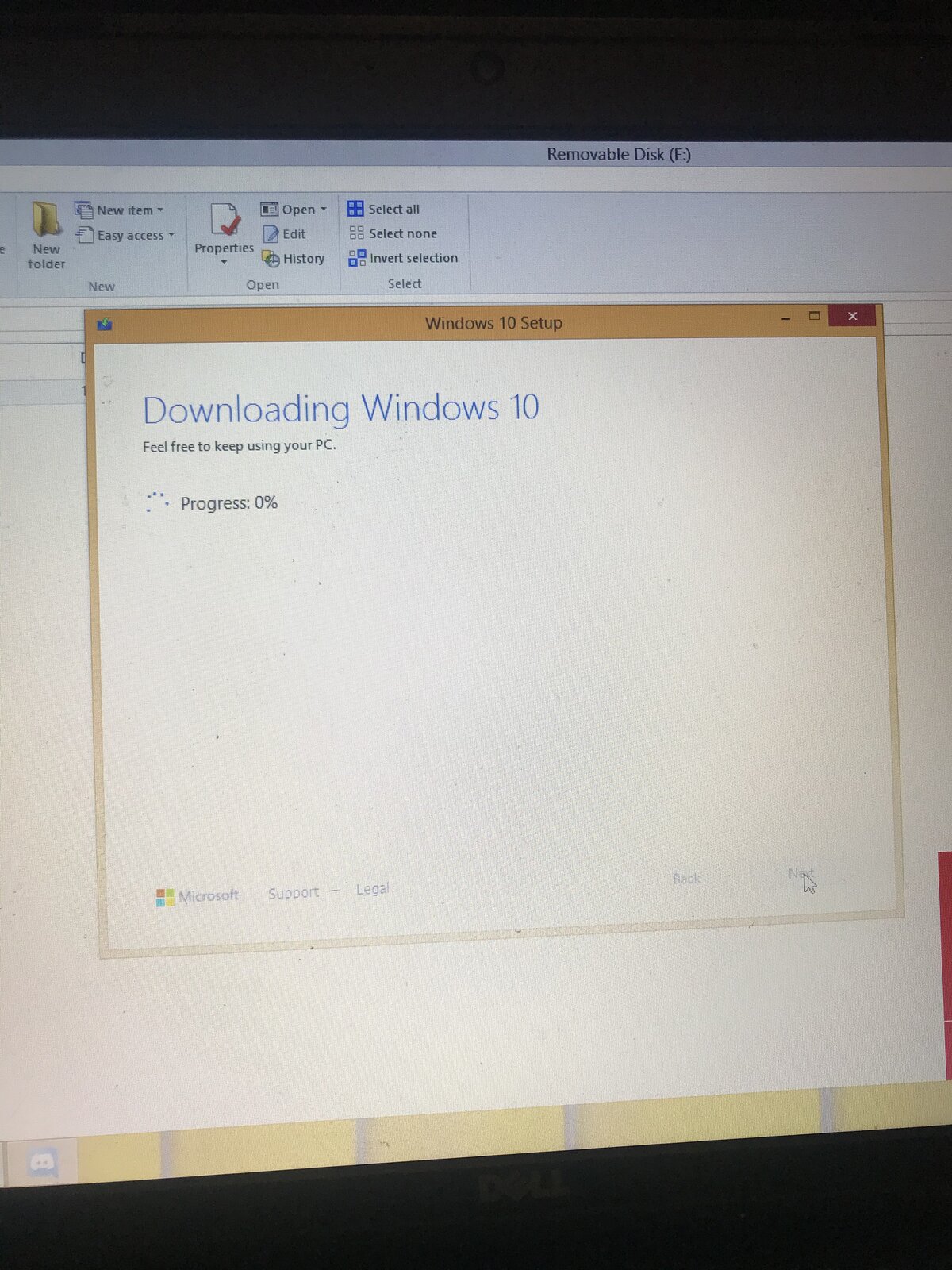

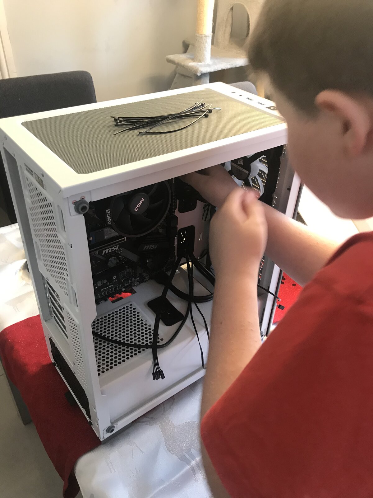

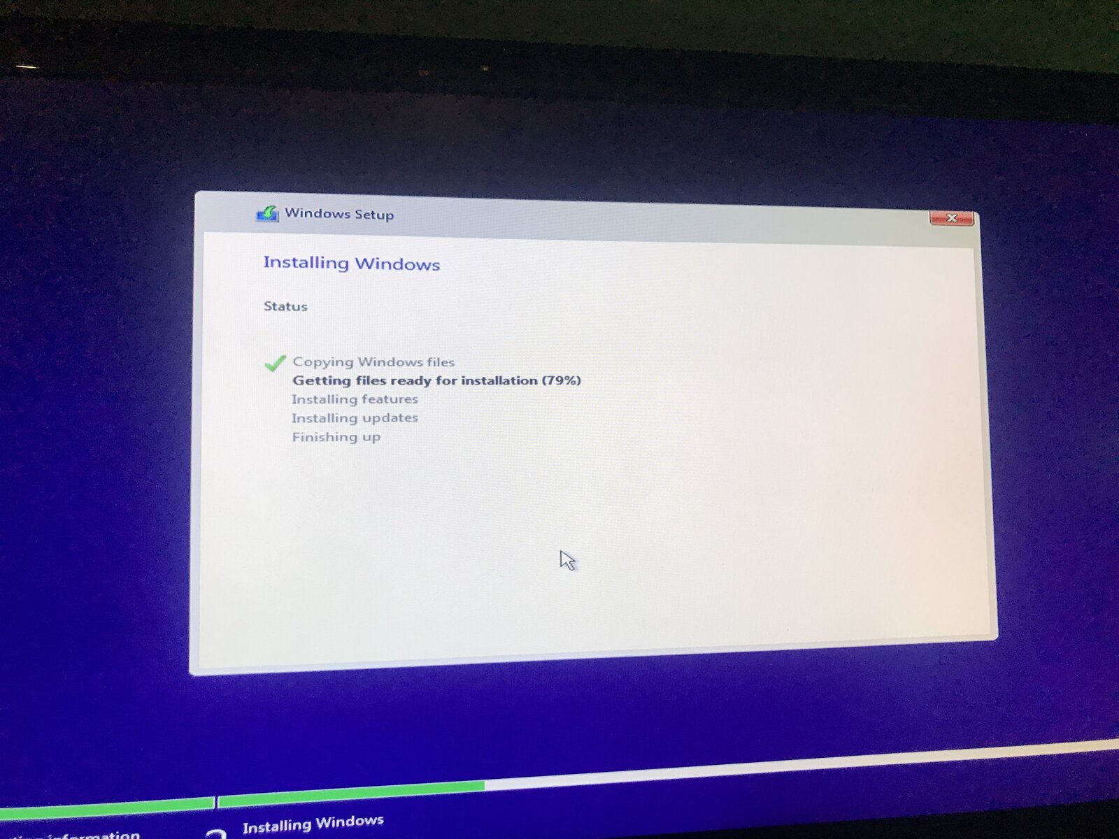

We have put the computer together but can’t seem to get windows onto it.
We downloaded windows creation tool onto a usb, put that in the new machine but only get these screens up:
Any idea where we are going wrong?
Thanks :)
Might have sussed it now, I think we needed to take the usb further on the other computer first

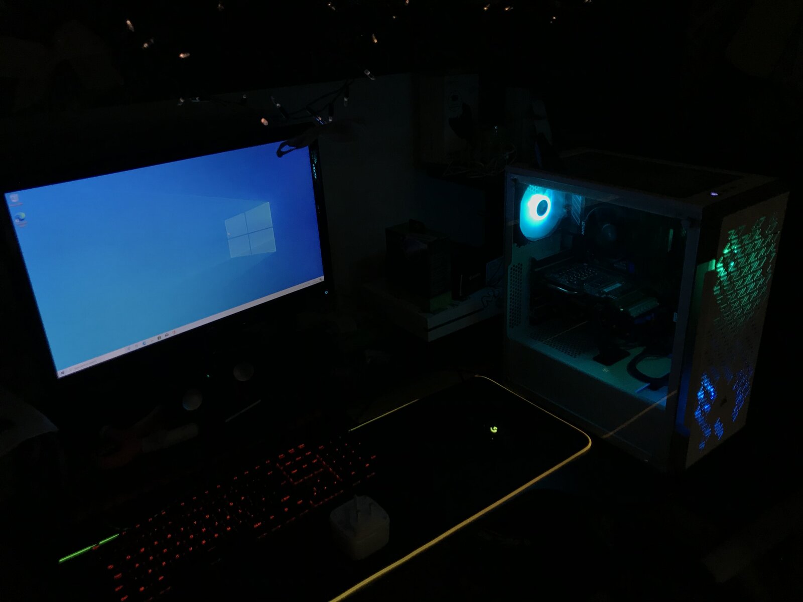

All done now, that was much easier then I expected. He is well pleased with it and proud to have done it (y)
