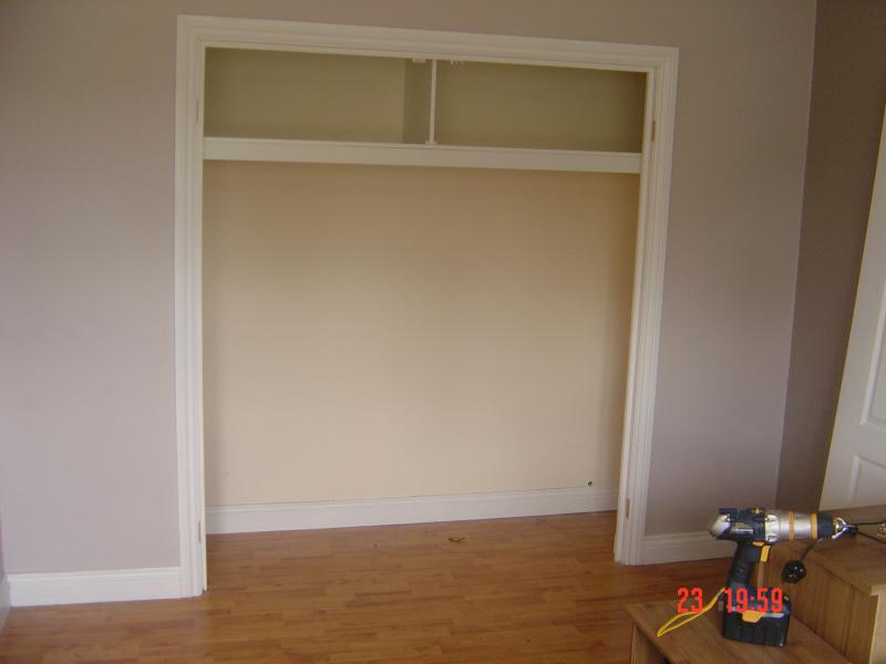

Doors removed then forgot I hadn't taken pics!
Small built in wardrobe, your typical newbuild cheap option.
Wardrobe in other room was used as a sheet and towel store.

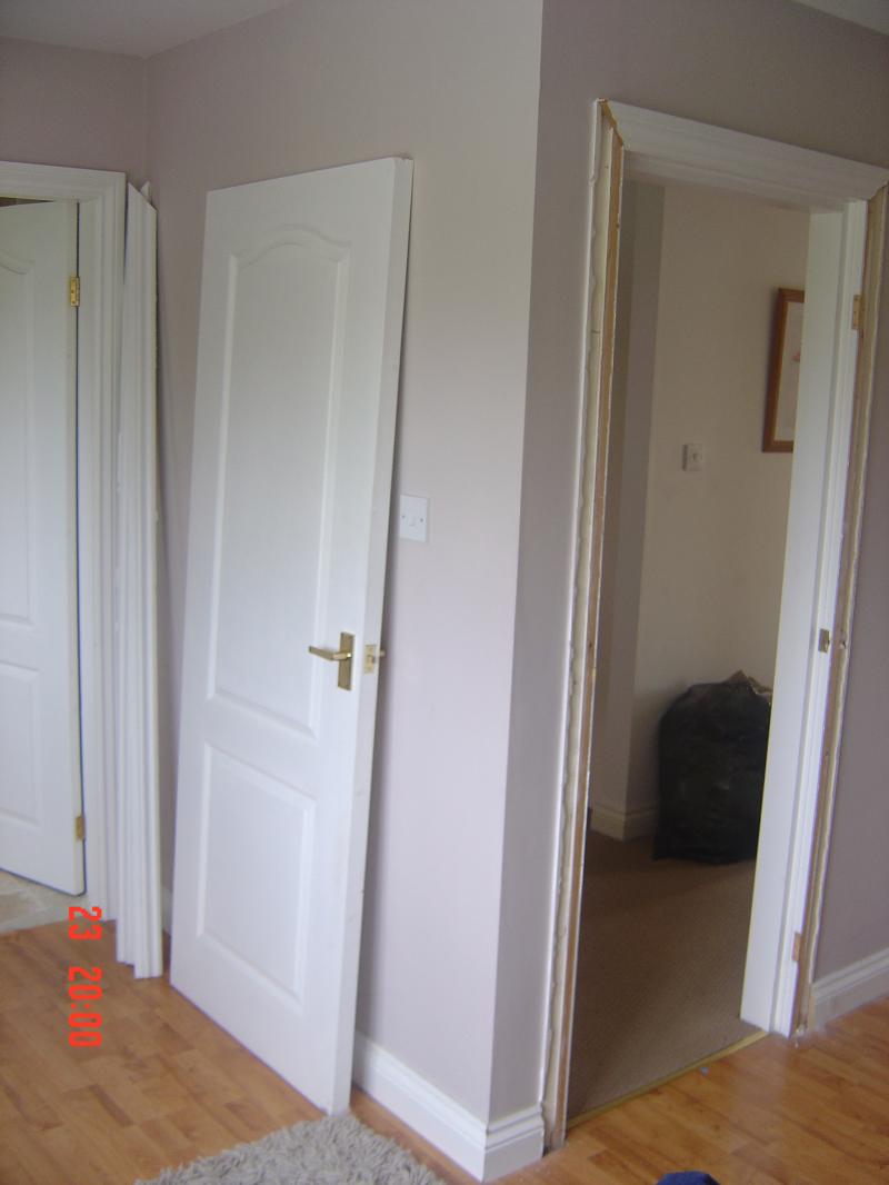

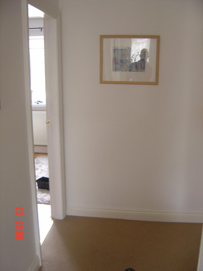

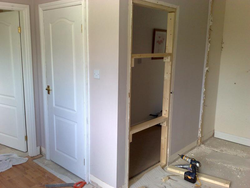

Hopefully a doorway will replace the picture!

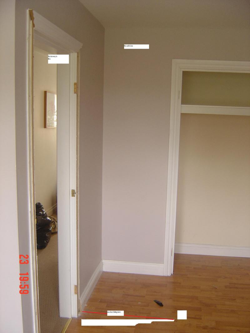

You can see here where the new doorway will go.
Now, i've never moved a doorway, so this will be interesting.

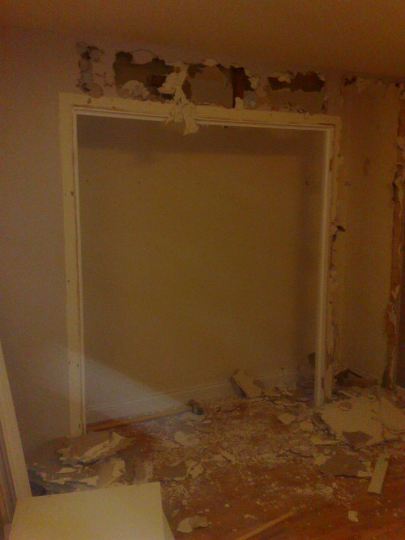

demolition begins. forgot about how much dust generated and had removed the doors and didnt put any covers down anywhere. Just as well the wife is away for a few days!

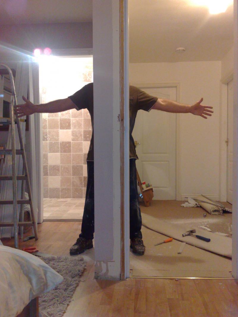

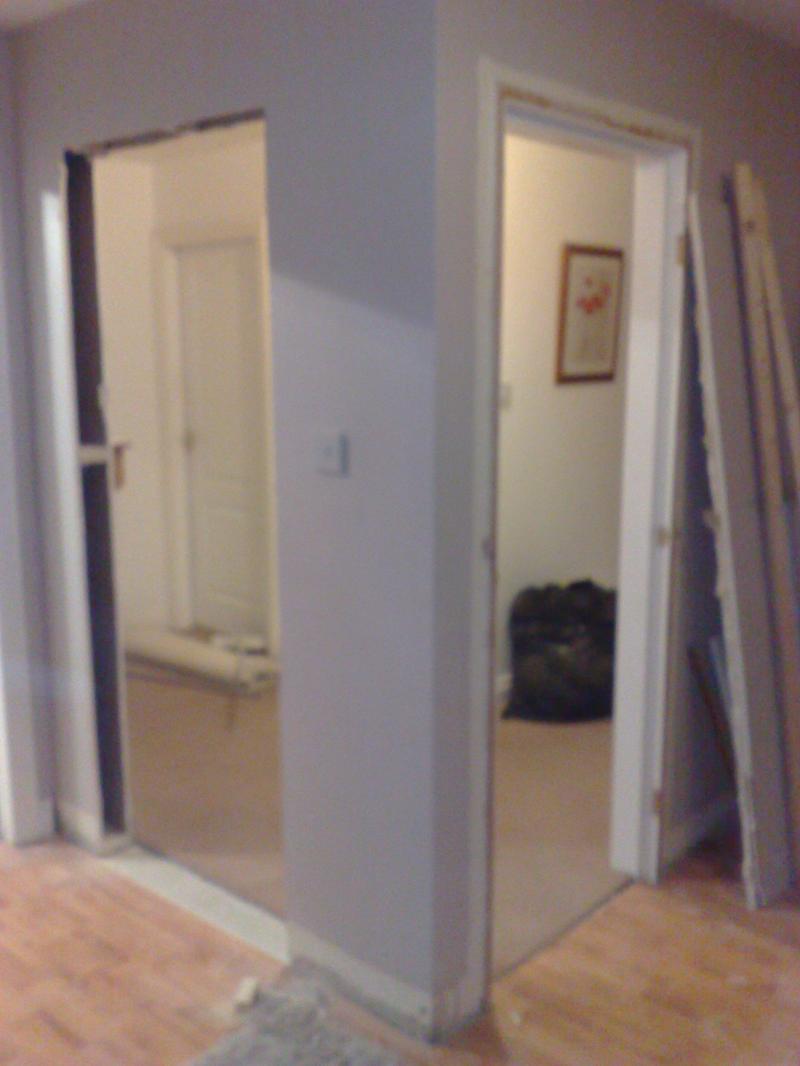

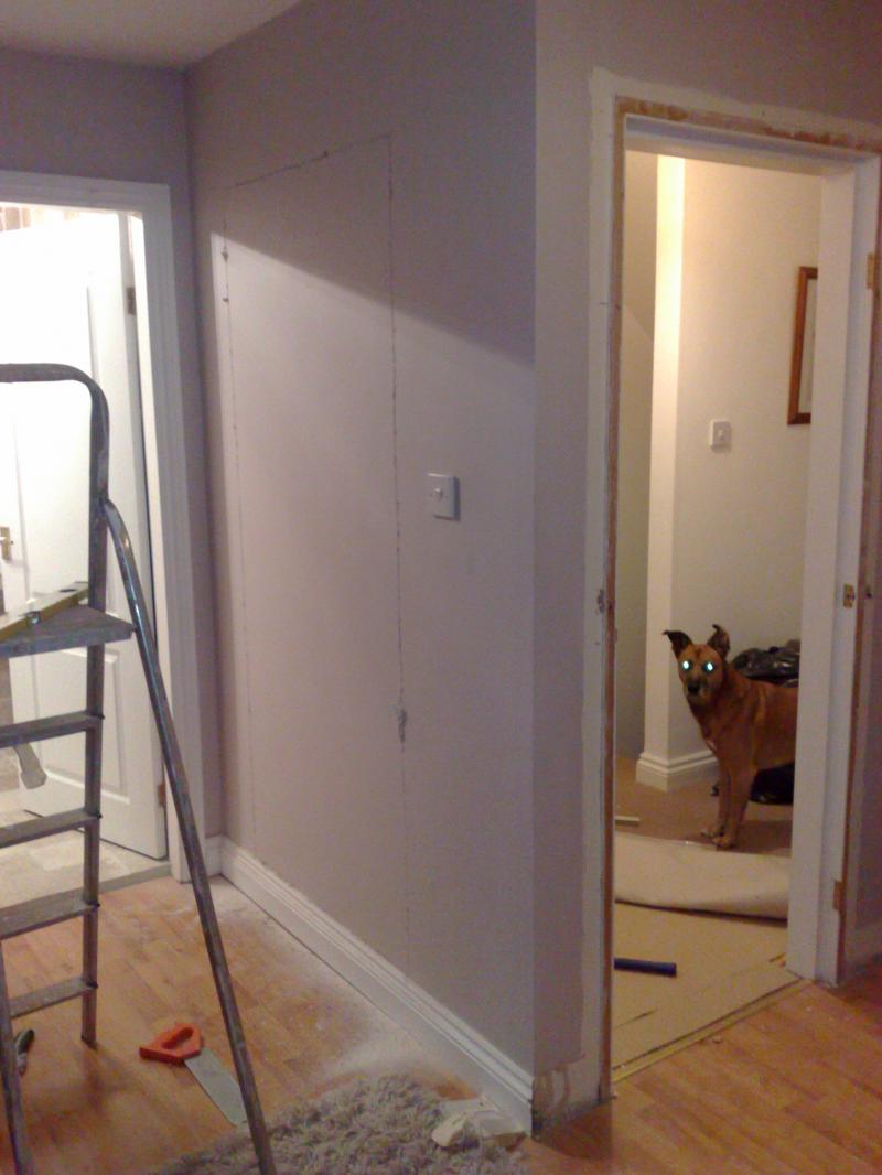

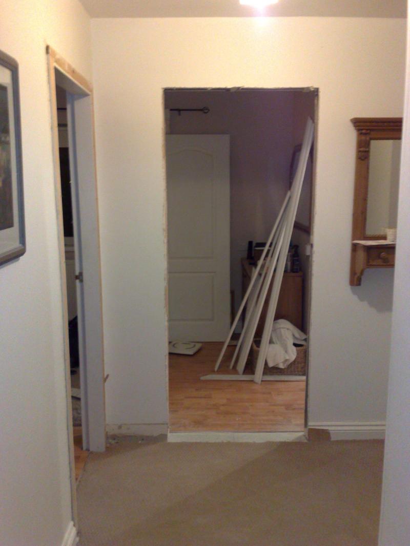

Ok, so not too much progress overall but managed to get the door and doorway moved, also now blocked up the old doorway and will be plastering that today hopefully. Need to look at tidying up the outside wall and skirting so I can paint that then just work inside room itself. Decided to take up all the laminate flooring and bin it, and going to screw the floor boards down as they creak. Ideal opportunity. What a way to spend Bank Holiday Monday.
Would just like to add, I know the door isn't exactly opening the right way into the room, but it was the easiest way of doing it without having to redo the hinges etc. This can be changed at a later date. ???? Maybe. :D

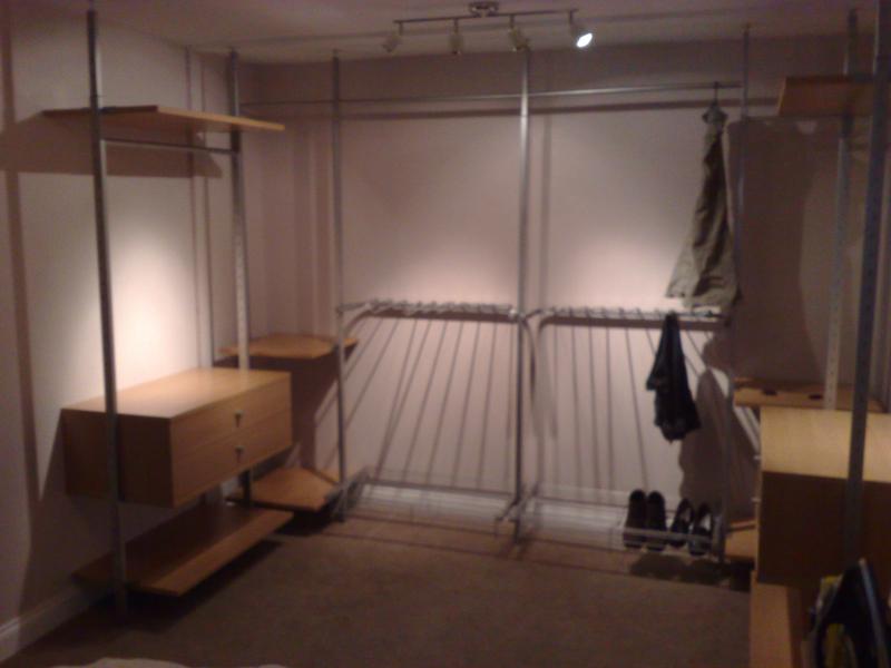

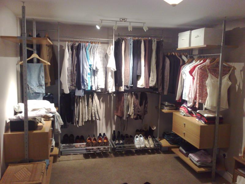

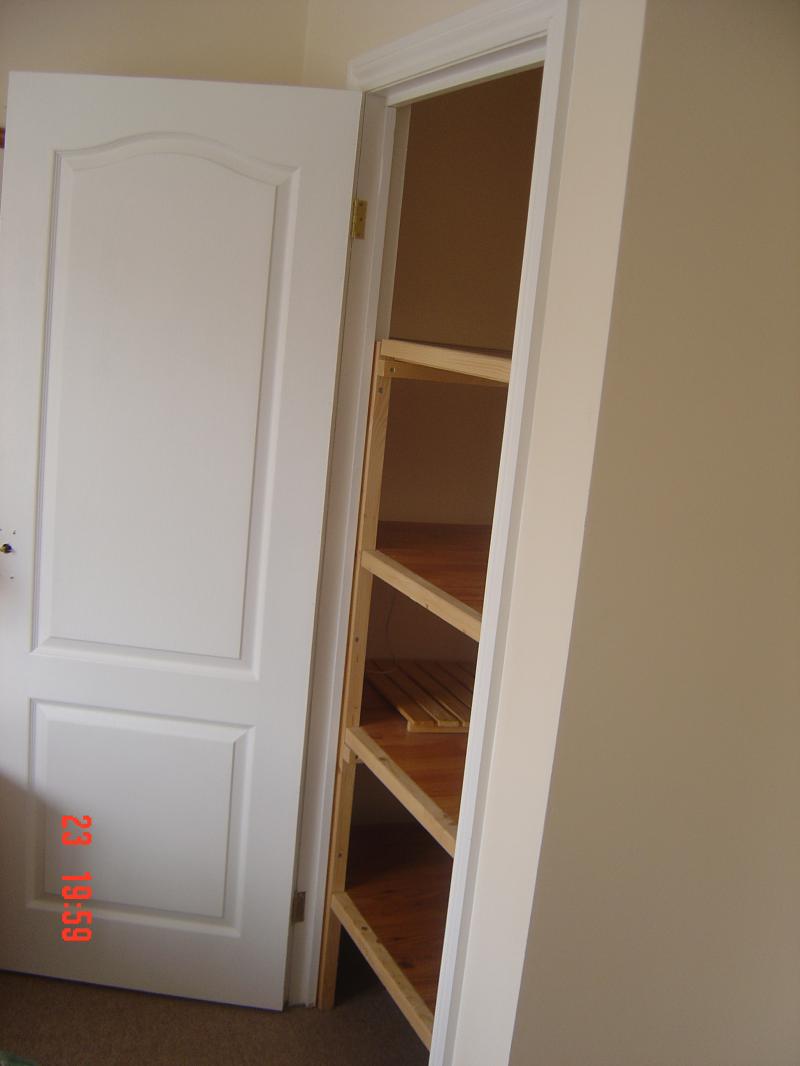

So, started to fit the internal racks/shelves
wife couldn't wait to start putting clothes away. They had been lying in the spare room for months by this time! LOL

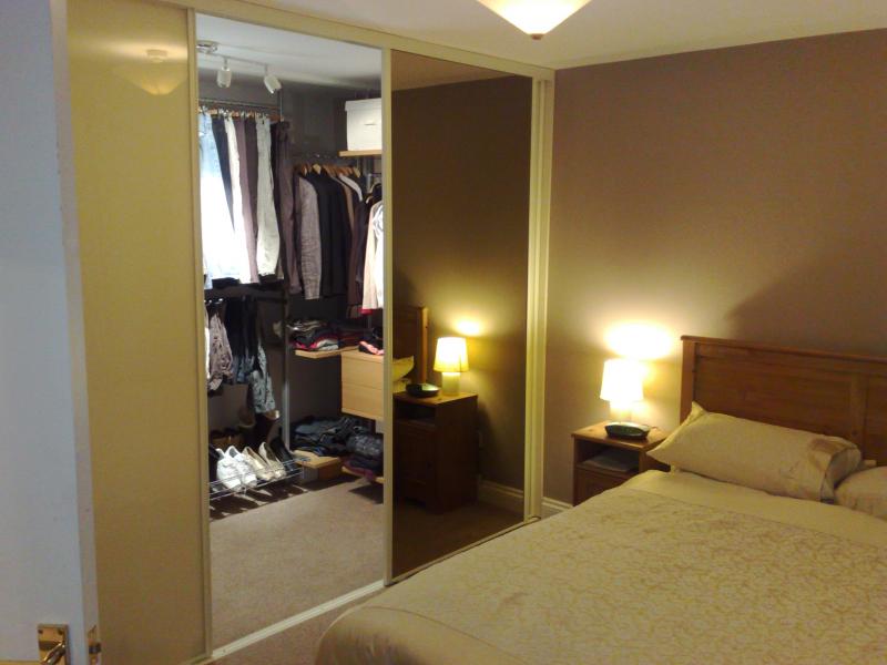

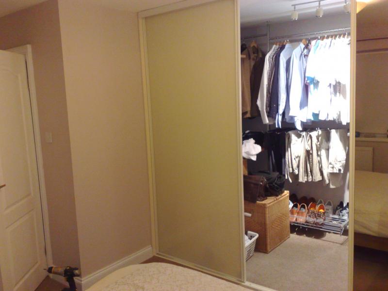

So the doors arrived this morning.
Two Butternut coloured glass doors and one bronzed mirror door
Very straight forward to fit them by myself.
Centre door opened. At least the room doesn't appear as small as we thought it might and we can actually walk into the wardrobe. The whole point of the exercise though.
