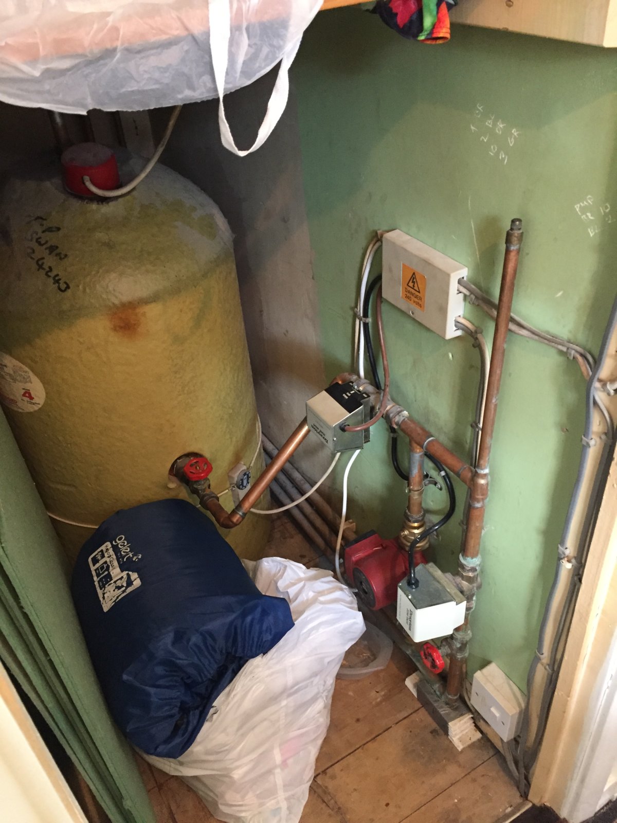

I wouldn’t mind actually replacing the wall thermostat for a hive . would it be possible with an old system like this? handy in the winter as its fitted with the old switchmaster timer.
Possible, although whether that is worthwhile really depends on what the rest of the system is like.
Some other alterations may be needed / desirable.
Which model of Switchmaster is it?
Can you select heating only without hot water?
Pictures of the hot water cylinder and any other components such as valves would be helpful.
thanks. off the top of my head as im not there atm. i think its switchmaster 805.
(brown and beige). yes i can select heating without hot water, it has 2 motorised valves.
i’ll take a picture tomorrow when im down there.
so this is what it looks like
