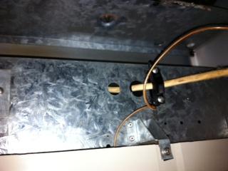

Thanks agile. I saw this about the flue spillage detector in the manual but I can't see one on my boiler. From the diagram it looks like it's on the underside of the control panel box and I've attached a photo. The mains cable goes in at one side, and the cable to the gas valve comes out the other. As you say nothing else really to this boiler.
Tonight I tried switching off, then waiting a few minutes, re-lighting the pilot, then turning up the thermostat. Just when the thermostat passed the "click", there was a bit of a noise like the boiler was about to fire up the main burners - but then nothing. I got the same noise some of the time if I tried turning the thermostat right down then up again. Does this suggest thermostat or gas valve, or something else?
Without examining your boiler I can not say if the flue stat is fitted or not but its shown on the manual!
The simple answer is that without measuring voltages I cannot tell what is happening.
But gas valves are a no-no for DIYers.
Sounds to me that you may need to call any friend who is handy with a multimeter or a professional.
Tony
