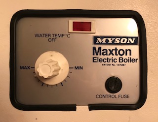

The Maxton thermostat control seems to function only as an on-off switch, with no variable control and the neon indicator doesn’t light up, so I suspect the boiler is working on an all-or-nothing basis.

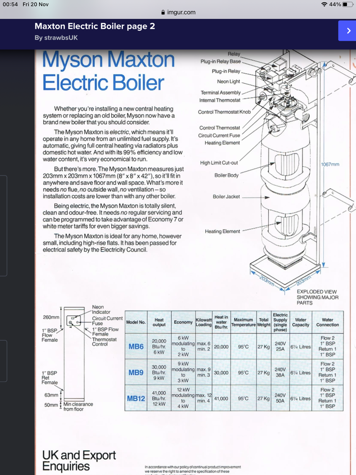

Your boiler will have 4 x 3KW heater elements, as the return water heats up the boiler switches off an element at a time, when the water cools down the boiler brings on how many elements it needs, this is all done automatically by the boiler, you cant alter how this happens by any external controller

Regarding the apparent non-functioning thermostat knob, I’d like to know whether replacing it (and the duff neon indicator) would help fine tune the output control? Might it’s non-functioning be compromising the automatic modulation?
What do you mean by non-functioning thermostsat knob ?
Sorry. I was referring to the ‘control thermostat knob’ (larger diagram, top right of attachment) or the ‘thermostat control’ (smaller diagram, bottom left). It now only serves as an on/off switch, with no other function apparent, whether set at 1,3,6,9 or whatever o’clock.
I’m pretty sure it originally served to adjust the desired temperature.
My apologies, I was thinking of a different boiler, yours only has two elements which is very unusual, yes your thermostat should adjust desired tempersture, but possibly does this by just an on off control, not designed to be turned up and down all the time, but set to whatever temp you require then the on off times set by an external controller thermostat or timeclock

I think it has to be a manual control as the ‘control thermostat knob’ has a Stop and Min>Max dial on the face panel. There certainly isn’t any min or max function at present, just off or on. And the on/off times are set on an adjacent timeclock.
The fuses appear intact. So I guess I’m looking for the thermostat and neon light to be replaced.

The neon light simply tells you that the elements are heating and will go out when the temperature is reached, it has no affect whatsoever on the efficiency or operation of anything else
