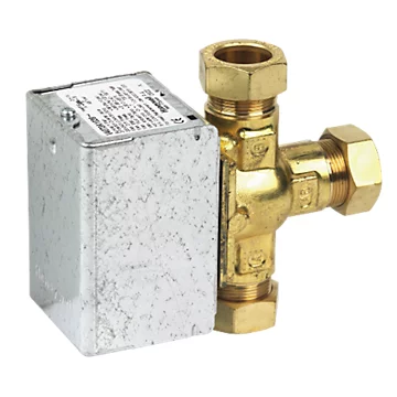

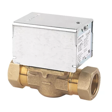

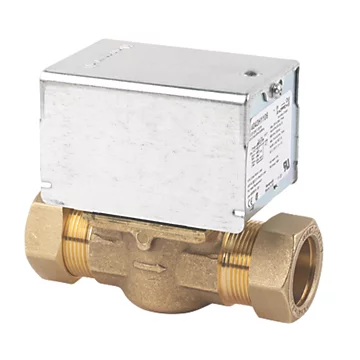

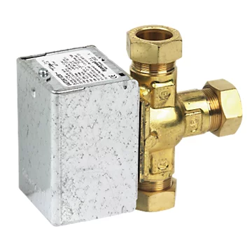

If an open vented system, you may have either an electrically operated valve, with three ports/pipes entering it, or two electrically operated two port/two pipe valves.
Your post suggests that one, or other of these has perhaps failed, or stuck, not fully opened enough to trigger it's microswitch.
Look for one or more of these
IME they are usually Honeywell or Drayton, and can last around 15-20 years
P.s.
They way they work, in the most common 3-port valve, the timer and the cylinder stat send a signal to the motor that turns the valve. There is a switch inside the motor casing. When the motor gear reaches the end of its travel, it switches on the boiler. The motor also drives the valve to a heating position, and at the end of its travel, switches on the boiler.
If the motor was not switching on the boiler reliably, if would be consistent with the fault you describe.
It is possible to change either the motor part or the valve part, but if your assembly is 20 years old, you probably need to change the whole thing. It is a moving part and wears out.
