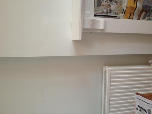

I recently moved into a 1900s end of terrace ground floor flat which had damp problems. We had a new DPC injected, replastered and also fixed a few things like installing vents in closed up fireplaces.

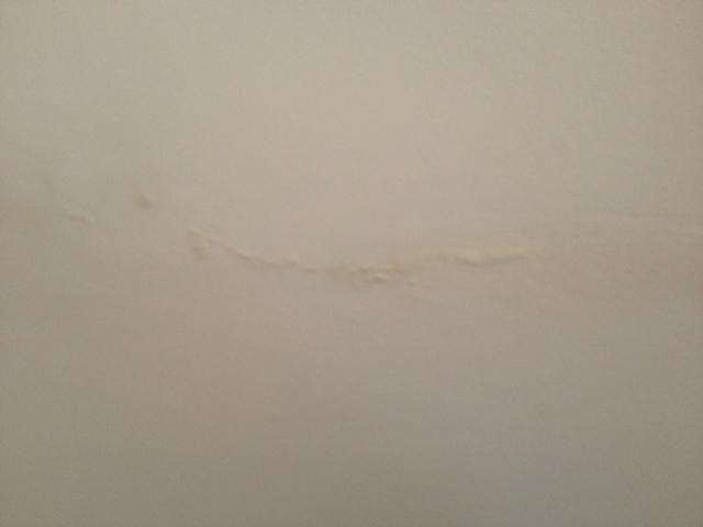

However, a few small damp patches have started emerging again in the front room. The new paint is a bit bubbly around them and they are brownish in colour. They seem to be gathering around the edges of where the new plaster meets the old plaster.
The wall where they are appearing has a working gas fireplace in it that we use quite a lot.

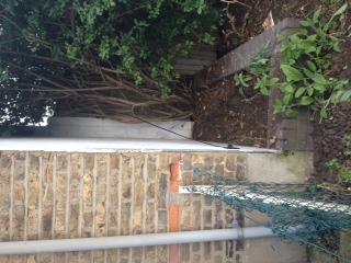

Also - they are on an external wall which is next to an elderly neighbour. The wall is originally brick but it has been entirely covered with a strange sort of material - it looks like metal but has a white surface. There is also a raised flower bed against the wall. I know this is likely to be a problem - but the elderly man has not lived in the house since I've been there, and I've been on to the council but they keep ignoring me. I'm going to persist of course.

This is the outside wall with neighbours raised flower bed (PS - does anyone have any idea what the white coating is on top of brickwork?)
Bubbling paint on wall...

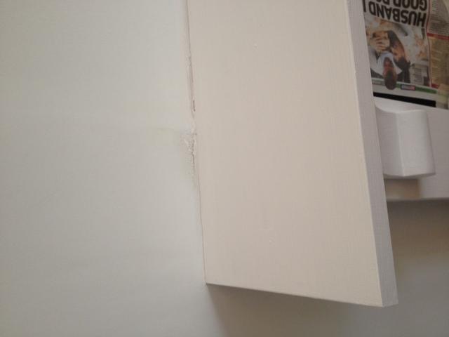

Sideways pic... but this is the damp above the fireplace
Another sidesways pic but this gives an idea of the room - damp patches seem to be where old plaster join is

The pictures aren't that good, but in any case the water is coming across the wall - either due to defective bricks, pointing, or that material holding water behind it.
You need to determine wha is wrong externally and sort that out. If it's not obvious to you, then someone experienced needs to have a look

The problem is I can't see the bricks on the external wall because the entire side of my house is covered with the white material

If the cause is the neighbour's thing he has put on the wall, then that will need to be dealt with. The neighbour is not permitted to fix stuff to any wall that belongs to you
Only suspect the chimney if the damp stains are where the line of the flue would be

Where would the line of the chimney flue be?
The patches seem to follow the join of where the old plaster meets the new plaster that the DPC firm put in. Presumably it's because this new plaster is damp-proof, so the damp is gathering above it?
