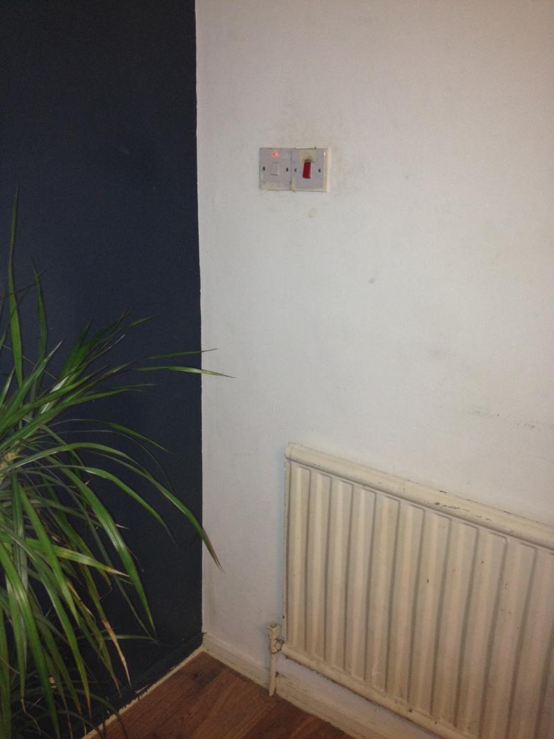

Hi,
I've got two, yes two, immersion switches on my living room wall. Behind the wall that they are on was an immersion heater tank in a cupboard. The tank and all wiring the other side of the wall has been removed in the past.
The mystery is that the white switch light is on all the time, which is what I would expect, but the red switch light comes on for about half an hour at 6-7am. Given that this red switch doesn't appear to be connected to any sort of timer - I presume the wiring runs inside the wall down through the floor and into the main unit in the kitchen below - what on earth could be going on?
Thanks for reading.

You would have had two immersion heaters 1 on normal 24hr and the second on off peak cheaper over night rate, the power to that is controlled by the supplier. That's the reason it appears to have a life of it's own :LOL:
You can switch it off at your fuse box if you wish.

Thanks for your reply, it's really helpful. I was going to get an electrician in to move the switches lower down the wall and then have a faceplate fitted. Then I noticed the red switch coming on intermittently...
It really helps to know what's going on before I call the electrician round.

There are no storage heaters or anything. We've just had a new combi boiler put in. Here's the fusebox and meter in the kitchen...
Hi, yes you only have one breaker from the Off Peak supply, the one at the right hand side if you switch that off no more flashing red lights !
DS
As DS says, it looks as if you have an off-peak supply for just that second immersion switch. As I implied, you should check what electricity tariff you are on - since you have no storage heaters, if it's a dual-rate tariff (like Economy 7 or Economy 10) you might be paying a lot more than you need for your electricity. Do you know if there were ever any storage heaters in the house?

As both of those switches are redundant, the easiest option is to have both circuits disconnected at the consumer unit and remove the switches.
Another option would be to add a socket as in the other thread, but your consumer unit has no RCD, and replacing it will not be straightforward or cheap.
Get rid of the E7 as well, as it has no purpose and is probably costing you more than a single rate would.
