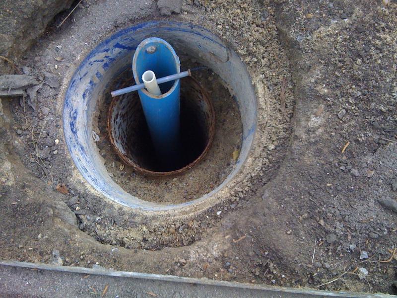

We have just purchased an ex agricultural property (barn) that was converted in the 80s to a house. It has mains water, mains electricity, a sealed septic tank (maybe i mean cess pool - no soak away, just pumped out), no mains gas, and oil heating.
In the parking area outside the property I have two mystery manholes (for want of a better description). They are some distance from the cess/ septic, and nowhere near the known locations of the foul pipes or the oil line.
The first mystery....
Under a relatively new lightweight manhole (ie not iron and ancient). There was a plastic cap sealing the 'assembly' shown - the outer metal pipe and blue pipe are fixed, the inner white pipe (with the cross T to hold it) can be pulled up - like a dipstick. I have pulled the 'dipstick' up a good 30m and it is still going!! - it seems to be weighted on the end (id guess 5-10kg worth)
Surely to bore a metal pipe this deep must have cost someone a fortune - and then not connected to anything. Or conversely if its redundant (a well?) - why not just cap it with a paving slab rather than a neat access?

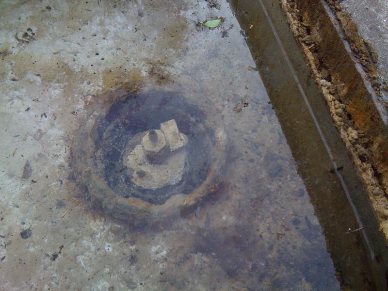

Second mystery.....
This one is 5m from the first, and under 6 inches of water. The valve assembly looks quite intricate - I didnt try and move/ open it. The white sediment is chalk like but hard in places, didnt try to dig into it. No noticable smells from either manhole.
Any ideas anyone? Plumbing and heating was the closest i could find as a category.

must be a well then
or else a heat pump. But 30m seems very deep for that.
If it is a well i think you have to get an abstraction licence for it. Your local water authority might be able to help. Useful if you have a farm, or perhaps a swiming pool.

I did assume something that deep must be a well - just intrigued as to why it was preserved, lined and properly capped!

No. 1 looks very like a borehole/well, like this;
http://www.wbadmorgan.co.uk/info_drilling.htm
Steel well casing in a borehole with the space between packed with grout/concrete.
The blue water pipe is from a submersible pump.
The white pipe- I haven't the foggiest idea.
Drop a weight down on a line, see how deep it goes and whether there's water at the bottom. Try e-mailing a well boring contractor, see if they can confirm this. You should be able to lift the pump out on the blue pipe.
Don't such boreholes have to be registered with the Environment Agency or some such? Would they have records?
One solved - 35 metres of pipe later theres a branded valve on the end of the white pipe - seemingly its for water sampling. Theres some 'inrastructure' nearby that maybe needed it as part of its planning maybe.
The other manhole with the mystery valve assembly - still a mystery!
I'm not certain it's a well borehole, it just seems most likely.
The submersible pump is possibly trapped by sediment in the bottom of the borehole and there should be a power cable to it. Maybe someone tried pulling it out with the cable.
The other one is possibly also a capped borehole. They should be sealed to prevent groundwater contaminating the aquifer. I can't say why they'd want two. Maybe a ground source heat pump system, one pumping water to the heat pump, the other returning it to the aquifer.
