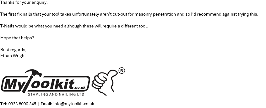

Hi. I have a beast of a DeWalt First Fix Nailer that Id like to use to fix mdf skirtings to plastered masonry walls. Ive tried standard collated nails without much success and I note there's not much in the way of masonry nails other than some sold by Axminster Tools but not sure if they'd fit. Surely Im not the only one who wants to do this?

Thanks for the replies. Yes they are a hard cinder block masonry, if it was Thermalite etc that would be fine Im sure. Also had this reply below from a specialist nail firm. Ive just got bored with screws/plugs and adhesives and propping them to the wall to close the odd gap.

First fix (clipped head) nailers, which have a nail thickness somewhere in the area of 2.9 to 3.3mm can fix into Thermalite blockwork (ideally skewed left and right to "stitch" the timber to the wall, but aren't able to fix into anything much harder. TBH that isn't what they are designed to do and trying to use one that way will result in bent nails, nail jams and sooner or later a broken driver pin (£50 to £70 on many guns)

I think the Axminster nails the OP was referring to are hardened T nails. They are available for a specific type of pneumatic gun called a T-nailer, but that is all they will fit. The nearest equivalent in a gas nailer would be a concrete nailer such as the Spit P800 or Hilti GX120 both of which can be used to fix (damp) timber batten to solid concrete, heavy concrete brick or even steel beams - although they are probably too powerful to fix skirtings to walls
OP - if you want to fix skirtings to walls the simplest way is to use a grip adhesive (e.g. a polymer bonding) or a low expansion foam with a few second fix pins to hold the skirting in place whilst the glue/foam sets. Failing a 2nd fix gun, just use masonry nails and a hammer, or hold the skirting in place with go bars or weights until the glue sets
