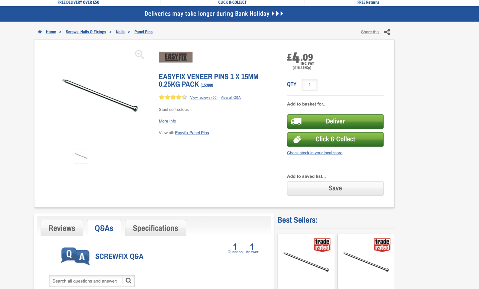

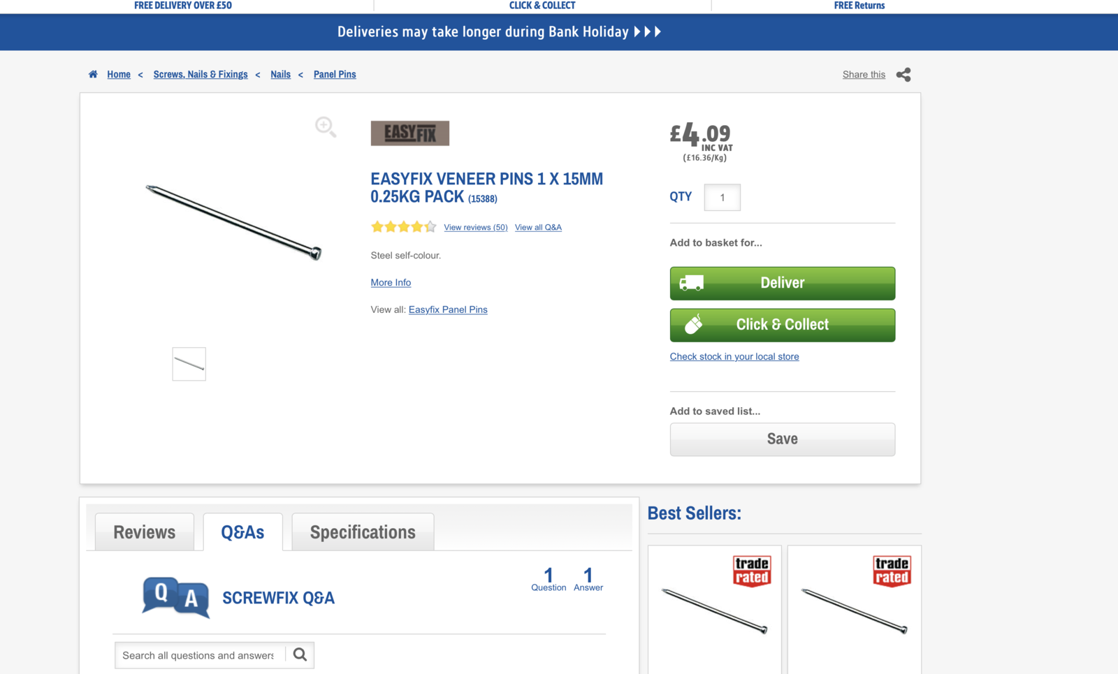

Looking at these.

Masonry requires masonry nails. Plasterboard would work with ovals providing you skew them in, although panel pins would also work. For the concrete I can offer no solution (because the pro approach is to drill and fix grounds if possible then nail to that.....)
As the name implies veneer pins are for wood veneers and very thin (2 or 3mm) plywood. They are very hard and are not meant as a permanent fix IMHO

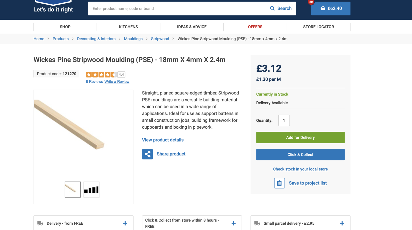

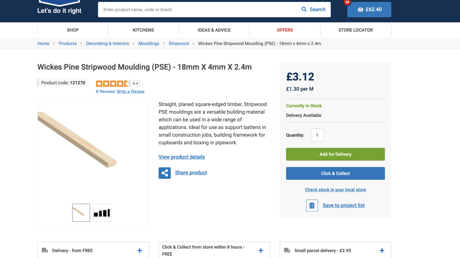

Great advice. I have decided to do the batton thing for the shiplap and do it properly. The only thing is I am not removing the skirting so want it flush as it can be. Do you think these would suffice. It is only 7mm MDF strips I will be pinning to it. I will drill the battons into the concrete and pin the MDF. Would these suffice?

Way too thin and likely to split if nailed.
Use baton to bring everything flush with skirting and then add new over the top .
Thanks. The skirting sits out around 12mm from the wall so if I use anything over 5mm thickness for the Batton the 7mm will overhang or am I being really thick here
Got to say that pin/nail holding in MDF isn't the greatest, plywood, OSB or softwood are all superior. The thickness of the battering should ideally be enough to take out discrepancies in the wall whilst not flexing. Also needs to be thick enough to provide sufficient holding power. TBH 7mm MDF fails on all three counts, even if you skew nail. Better would be something like 5/8in (16mm) ply or 18mm softwood, especially if you are cladding with 16 to 18mm MDF. As Foxhole says it generally isn't worth trying to retain the existing skirting in situ
