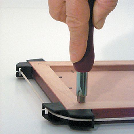

Also my daughter is considering starting a picture framing service as she is asked numerous times to make up pictures and frames
For picture framing your daughter probably needs to look at two completely different tools, a frame joiner like this one:
which drive a V-nail or corrugated fastener into the underside of the mitre joint. There are manual versions of this which are cheaper, but a lot more hit and miss to use I found (costing £15 to £20 or so from art shops):
The other tool to consider is a sprig or point setter like this one:
which drives triangular sprigs or points which hold the glass, matte, picture and backing board (apologies if the terminology isn't 100%, but I'm a "wood butcher" not a picture framer), etc in place. There are alternative systems to do the same job and Framers Corner do a similar DIY gun at about £30. The web sites of the two firms in the links (Framers Corner and Lion) are worth looking around to see what is used and available for picture framing, both tools and materials.
