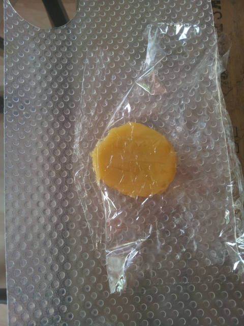

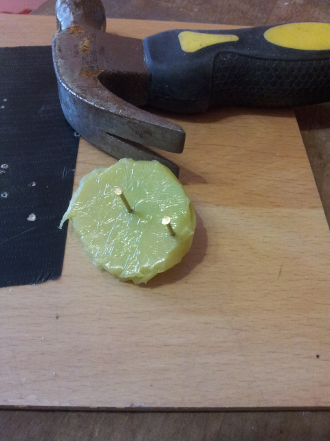

Using left over resin, I made an experimental piece. The plan is to drill a 1mm hole and hammer in a 1.5mm pin. Success if no cracking. An alternate solution is to drill a 1.5mm hole and glue nail using hybrid polymer sealant. Gluing using resin could be too strong and causing things to break when pulling out the nail in the future.
The piece will also be used for confirming: 1. ikea silicone drawer liner is suitable as a re-usable mixing pad; 2: cling film used as a barrier for forming the piece will not stick once the piece is cured; 3. new resin has weak bond to the cured piece.
The cured resin peeled off from both the silicone sheet and cling film easily. These make useful tools for working with epoxy resin.
Drilling and nailing worked. The resin wasn't dense. Consequently the holes exerted fairly weak grip on the nails.
Nailing without drilling also worked. This is the solution I will take. Although, I suspect the resin will become more brittle over time. So, it is best to nail when the resin is freshly cured.
