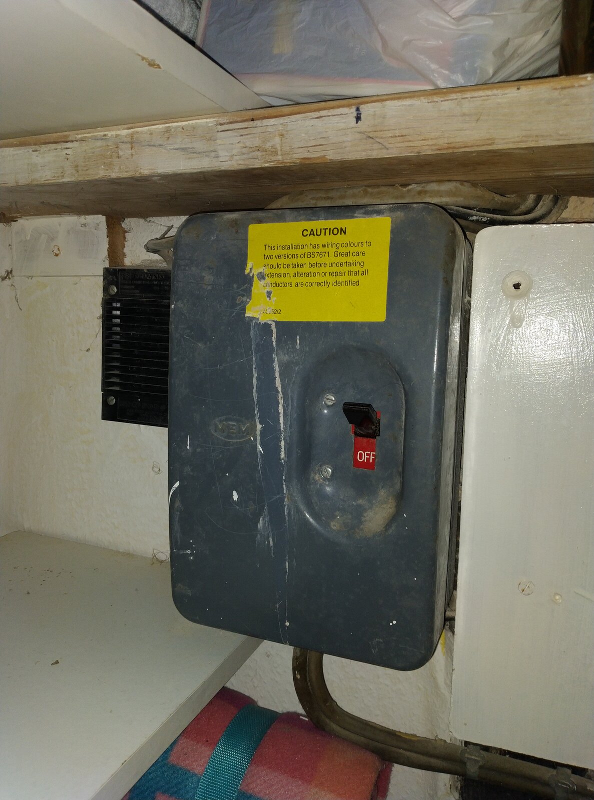

Hi. This is my MEM very old fuse board. I would like to look inside it so I can see what amp my cooker circuit is. But, when it is off, I can't find a hinge or latch to open it. It's got a couple of screws on the front but I'm not supposed to open those, am I? Please help

Don't touch that.
What makes you think it will be inside there?
That's a main isolator. Not a consumer unit.
On your consumer unit, (on the oven MCB it should specify the rating of the maximum current.) You won't need to open anything.
The two screws come out and allow the front to come off when the main switch is off. Usually you get two 30A carriers, and either two 15A, or one 15A and one 5A. these were used for standard domestic installations where you would have a 30A sockets ring, 30A cooker, 15A immersion heater and 5A lights. The carriers may also contain asbestos flash pads
What colour are the cables comming out the top, do they have black outer insulation like they look like they might do, or is it just poor lighting?
That board is long overdue for replacement, being circa 50 years old. I assume you are asking because you have an appliance retailer connecting a cooker to the cooker cirucit - I have no idea how they would react to seeing that board, they'd possibly decide because there isn't an MCB silkscreened with 30 or 32A that they don't know how to proceed
But if you have a 6mm cooker cirucit in your kitchen, realistically its going to be on a 30A fuse in there
I think it's fair to assume that is the consumer unit with 4 fuses as already described.

It's a 4 way consumer unit, probably installed somewhere around the early or mid 60s.
As I recall, you cannot have the main switch ON when the lid is removed.

that form factor includes a single fuse at 60A so it could be a submain. This is an earlier version in 30A (on left) from 50's/60's, My home built around 1965 had this older style. My guess; the 'all pressed' version like OP more likely 70's. I did a fair amount of work for a builder around 1973-5 and both versions were being supplied at that time (a real pain as sometimes 2 were fitted and possibly a struggle to get a match).
However from what has been posted I do think its a 4 way fusebox.
