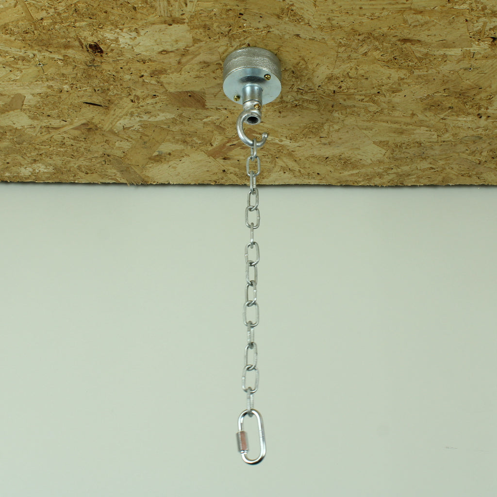

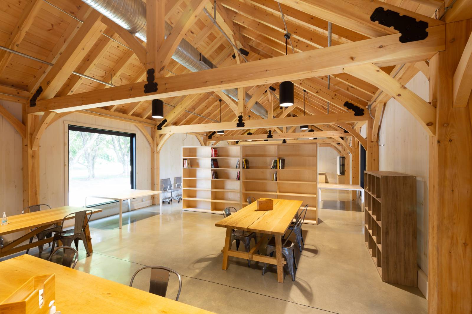

Hi -- I'm installing three ceiling lights in a workshop. They're old lights from a barn and each hangs on a chain. I'm going to hang them from the joist that runs along the length of the pitched roof. I understand the wiring diagram for the circuit, what cable to use, etc., but I just don't know the name of the fitting that I should use. The lights don't have their own ceiling roses -- just a wire coming out of the top. Please could you let me know the name of the thing I should be getting from Screwfix that will screw on to the joist & where I can put a cable in at one side & a cable out at the other to go on to the next light? Thank you!

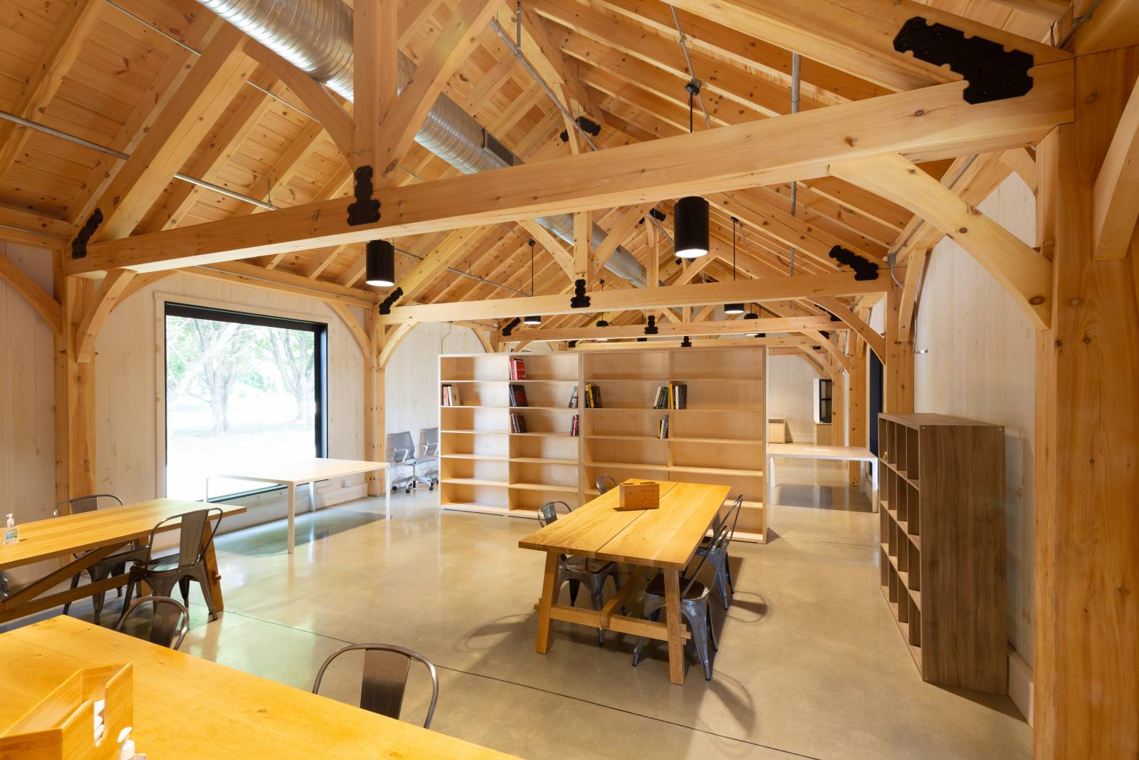

Thanks for getting back to me! Sorry not to have explained myself properly -- the cable is going to have to run along the surface of the joist and the fitting is going to have to be mounted directly on the joist, as it's a pretty simple timber framed building with all the framing exposed. Like a much more primitive version of the attached photo. So there's no void above where the cables will go.
  • 24_x_60_Fabbrica_Timber_Frame_Conference_Building_4683_Windsor_CT-OF3A1094-0.jpg

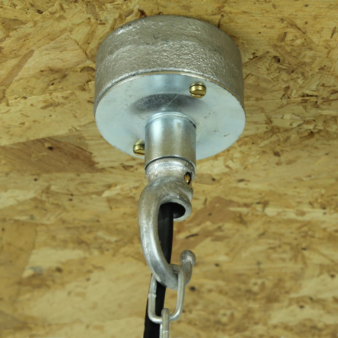

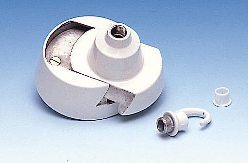

As above, I'd go for galvanised conduit and boxes, but it may also be worth considering a conduit ceiling rose with hook.
Something like...
Other styles/prices are available.
That looks good I think. I think I'll use the black conduit; I'd been thinking about galvanised conduit but started to fret about having to spend too much time sitting down with the die set trying to get it to fit -- plus I wasn't sure if I'd have to earth it & if so how. I can follow a diagram but I'm not an electrician and want to keep things as simple as I can.
These wiska boxes would be a good match with black conduit. You will need 20mm conduit adapters which can thread into each end of the box, you can use stuffing glands to enter your light cable more securely but can also just push through the membrane if it's not at risk of being pulled out. Pack of 3 way wagos will make life a bit easier too.

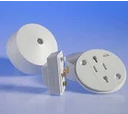

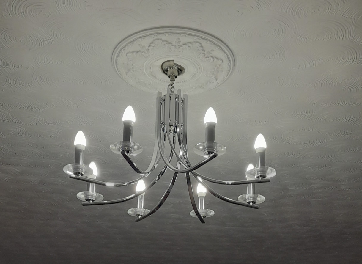

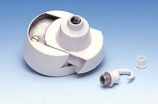

I found holding a lamp and wiring up as same time hard 20220415_000328_1.jpg so I used these Ceiling rose.jpg were done in chrome too, not seen them for some time now, but there are other plug in ceiling roses which will do the same job.
I found holding a lamp and wiring up as same time hard View attachment 369298 so I used these View attachment 369299 were done in chrome too, ....

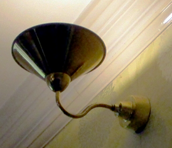

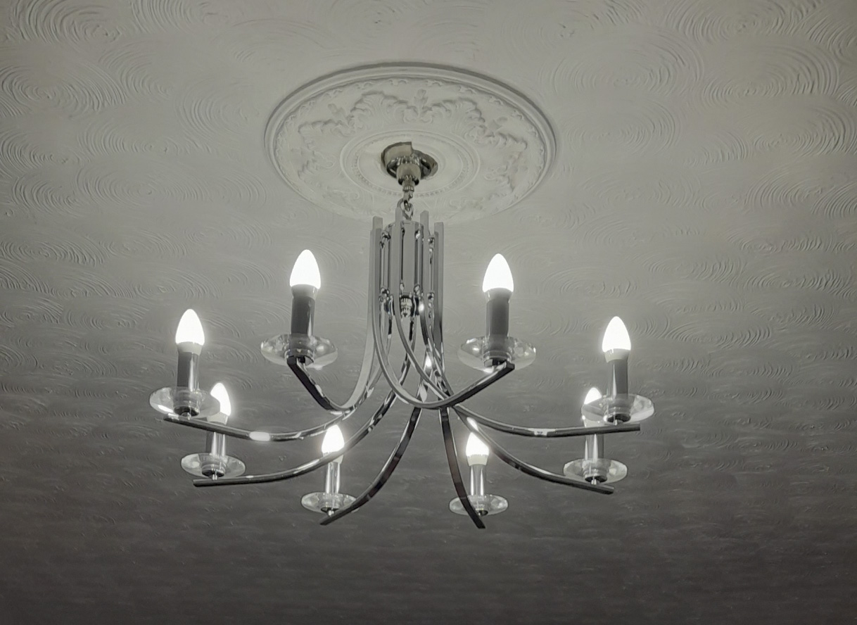

... and in brass. I have a lot of them in my house, mainly installed about 35 years ago, and I use them both 'verticsally' as well as the intended 'horizontally' - as in this one bearing an uplighter, a little below the ceiling ....
Yes, as you say, although that particular type/design seems to have disappeared, there are plenty of modern things which do mych the same job, but necessarily quite so well!

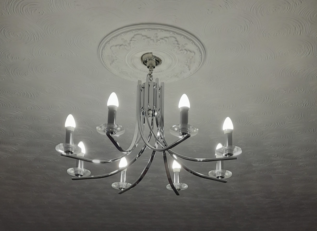

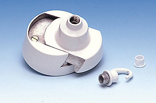

not seen a hook in ordinary ceiling rose. 1736939766088.png and it is a darn sight easier to wire on the ground then plug in. I can swap my chandeliers between dining room and living in minutes, would not dream trying without the plug in ceiling rose.

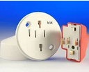

1736940179471.png1736940197340.png This was the first type I used, in offices, as we could swap light fittings without turning the lights off. We had 2' square ceiling panels, some of them lights, we could swap them with minium disruption of those working in the room.
Be it just take down to clean, or swap the whole fitting plug in ceiling roses work well. The Maestro however is the only one I have seen with hooks. The one shown the 4 pin would fit in the 5 pin but could never source 5 pin bases, and they fit neat on a conduit box.

Absolutely nothing wrong with that, but I suspect that a good few people might regard it as less aesthetically pleasing than having some sort of 'rose' that had a hook.
