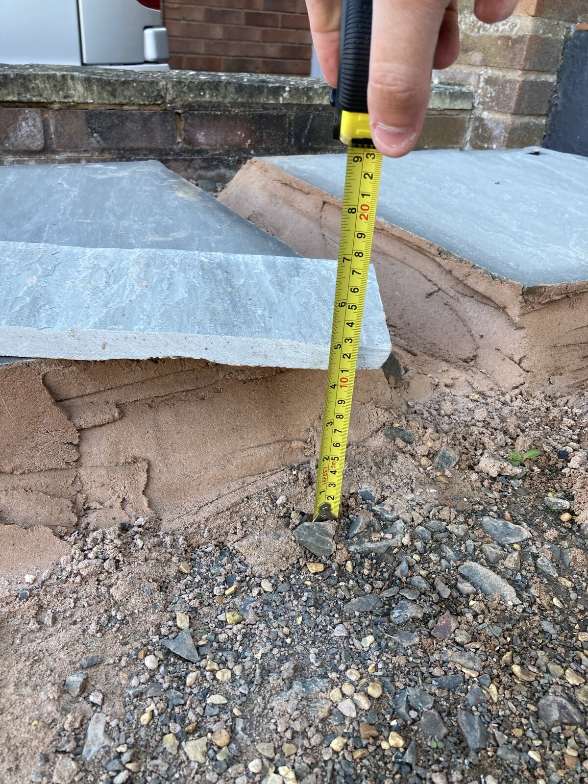

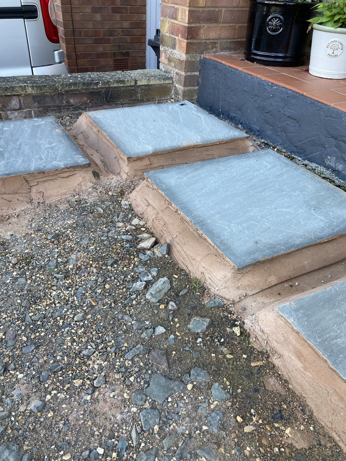

Here you go Mikey......he used more like 120mm instead of 40mm !
Here you go Mikey......he used more like 120mm instead of 40mm ]
Ok, that's a bit more than you said initially!
If the height is OK in other respects, and they work for your purpose, then I still stand by my suggestions, even if they look like that now. Once gravelled, they will look fine.
If they are too high for use (ignoring what they look like) then id remove, but you may struggle to not break them, especially if they have been bonded.
apologies Mikey, just went out and measured for the photos !
there is a slight bump on the drive (its not a nice graduated slope) hence i would rather not add more hardcore and whacker down as it will take the overall drive level up further but i will reconsider it
regarding the manhole, do you have any ideas of something that i can just drop on top of the manhole, allowing it to be easily removed should it need to be accessed perhaps ?
Where the manhole cover is is exactly where the front drivers side wheel is positioned when that car is on the drive, so one of my early thoughts was to drop an old-skule type 3x2 slab there, nice and heavy and strong and wont break but can be removed if needed, and then hardcore up the rest of the drive to that thickness ?
A bit "heath robinson" i know but just a thought as i an conscious of the effort involved in taking all 17 slabs up and rebedding, and breakages
