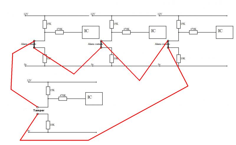

For example, say zones 5-8 are unused and linked out, you could bring the output of zone 1 and the input to zone 2 tamper into zone 5 terminals, the output of zone 2 and the input of zone 3 tamper into zone 6 terminals etc. and not have to use choc block. Disadvantage is would need to undo if additions required in future, advantage is would confuse the hell out of someone else trying to work on the panel in future ! :LOL:
Don't think that would work tbh, even though the staples are in place they are still part of the circuit hence there are voltages aparrent on them. Connecting your tamper wires to them will either disable the tampers or create havoc with the alarm closed circuit voltages.
You need to keep the tampers separate.
Surely the alarm terminals are purely a switch (normally closed) and no voltage is present ? In any case with a 0 ohm link accross them there aint much voltage !
But I agree its probably not the best idea.
No, they are often stuck in the middle of a potential divider so there is some voltage there with reference to the zero volt rail, even with the link in.
What you are intending to do is short two parts of the alarm circuitry together, the alarm terminals and the tamper terminals.
This will either disable the tampers or cause the alarm circuits to not function correctly.

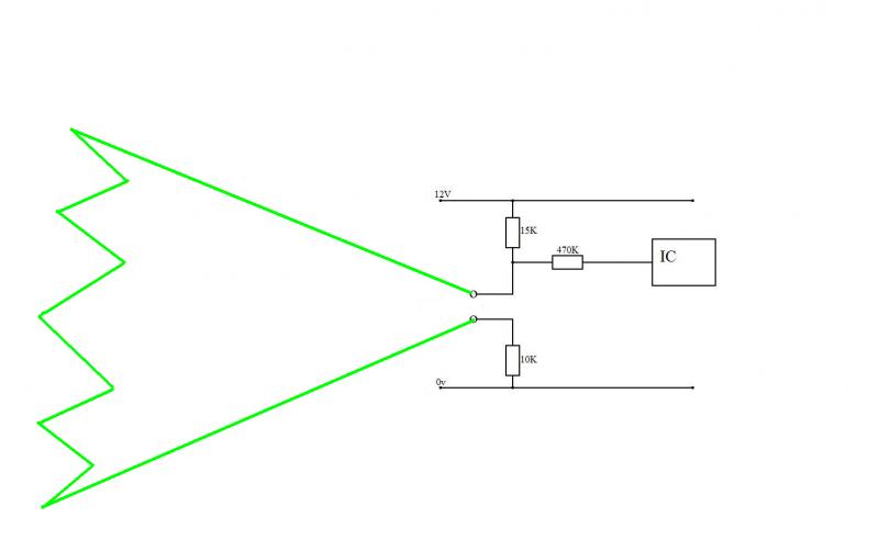

This is how a Texecom Veritas R8 alarm terminal is configured:
When the solid link is in the terminal link is held at 4.8v.
The only thing that should ever be connected to these terminals are dry alarm contacts, i.e. nothing with voltage on them.
Interesting stuff, thanks. But I still say that there will be no voltage difference measured across the alarm terminals with a link in place..
There wont be a difference across the terminals, but they are part of another circuit!!
You are intending on joining two circuits together which is wrong.
sorry but you are not right at all. (with your reasoning) you are right about no difference on two linked termianls
a circuit and tamper have to be different polarity on a non resistor based panel.
so lets say the ccts are +ve and the tampers are -ve
lets now take a pair of circuit terminals.
one must be a + supply the other is looking for that +ve to say everything is ok.
you put a link across and all is well.
However if you connect the tamper loop to either terminal you now have + and -ve which cancel each other out, so there is no +ve coming into the 2nd cct terminal so the panel will not let you set (which is what i said in the first place)
Also by sending a voltage up a terminal that should not have one can also cause all or any "lower" circuits not to work at all.
(its worse with a panel that does have resisitors in the detection devices)
