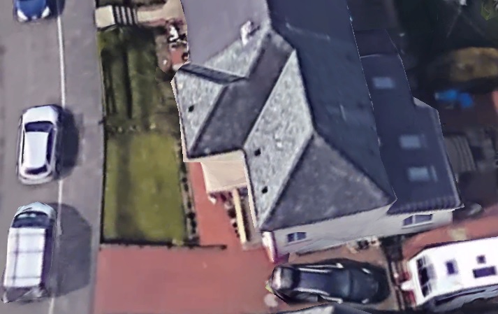

We're in Scotland in a high wind area, the roof is slate, bitumen felt on sarking boards and reasonably complex, they've measured it to be 79m2, the extension at the back is only 5 years old so not included in these works.

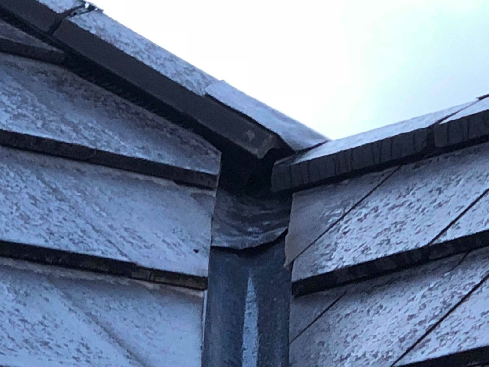

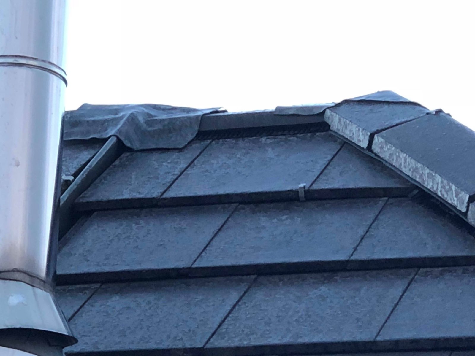

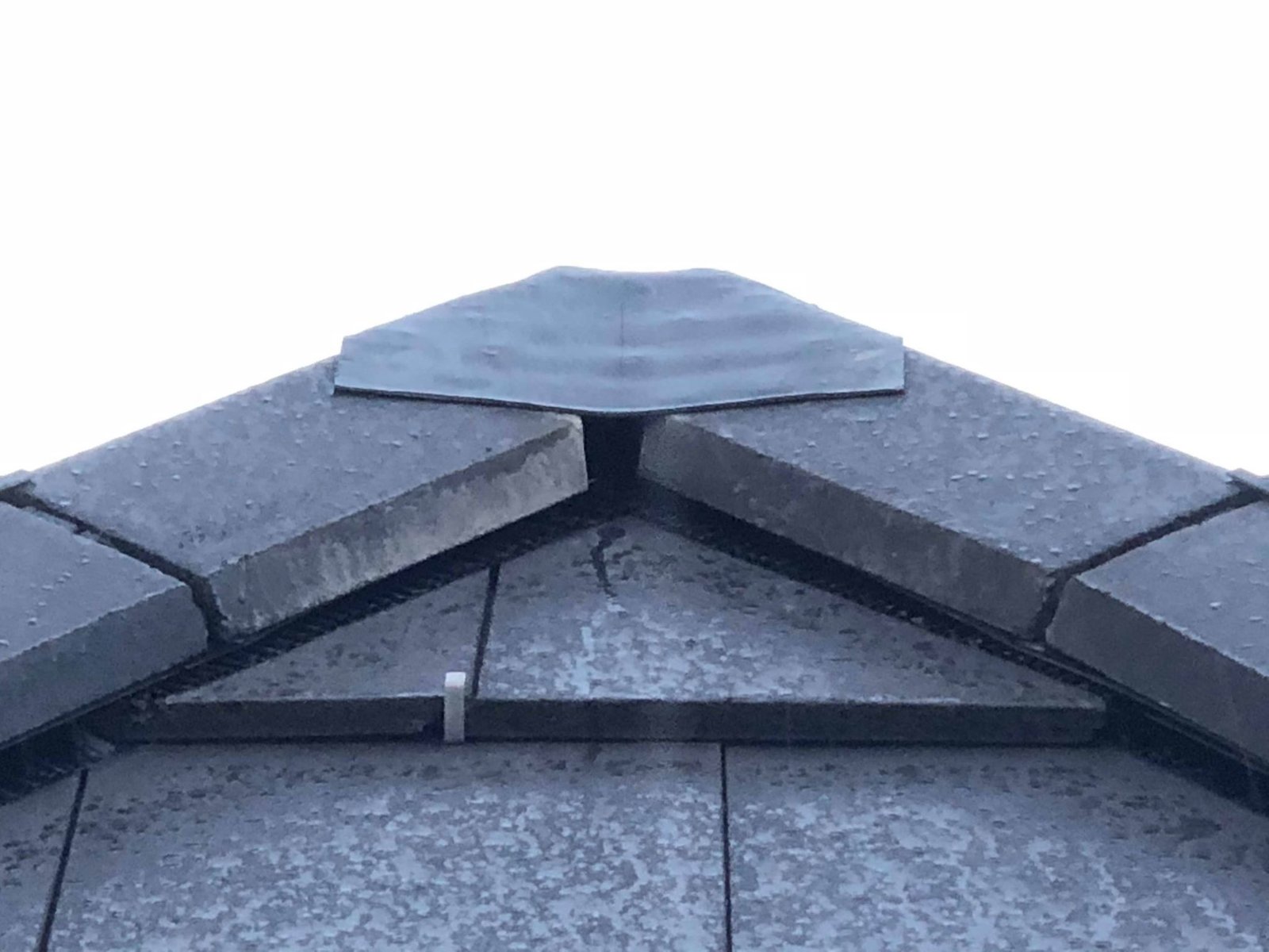

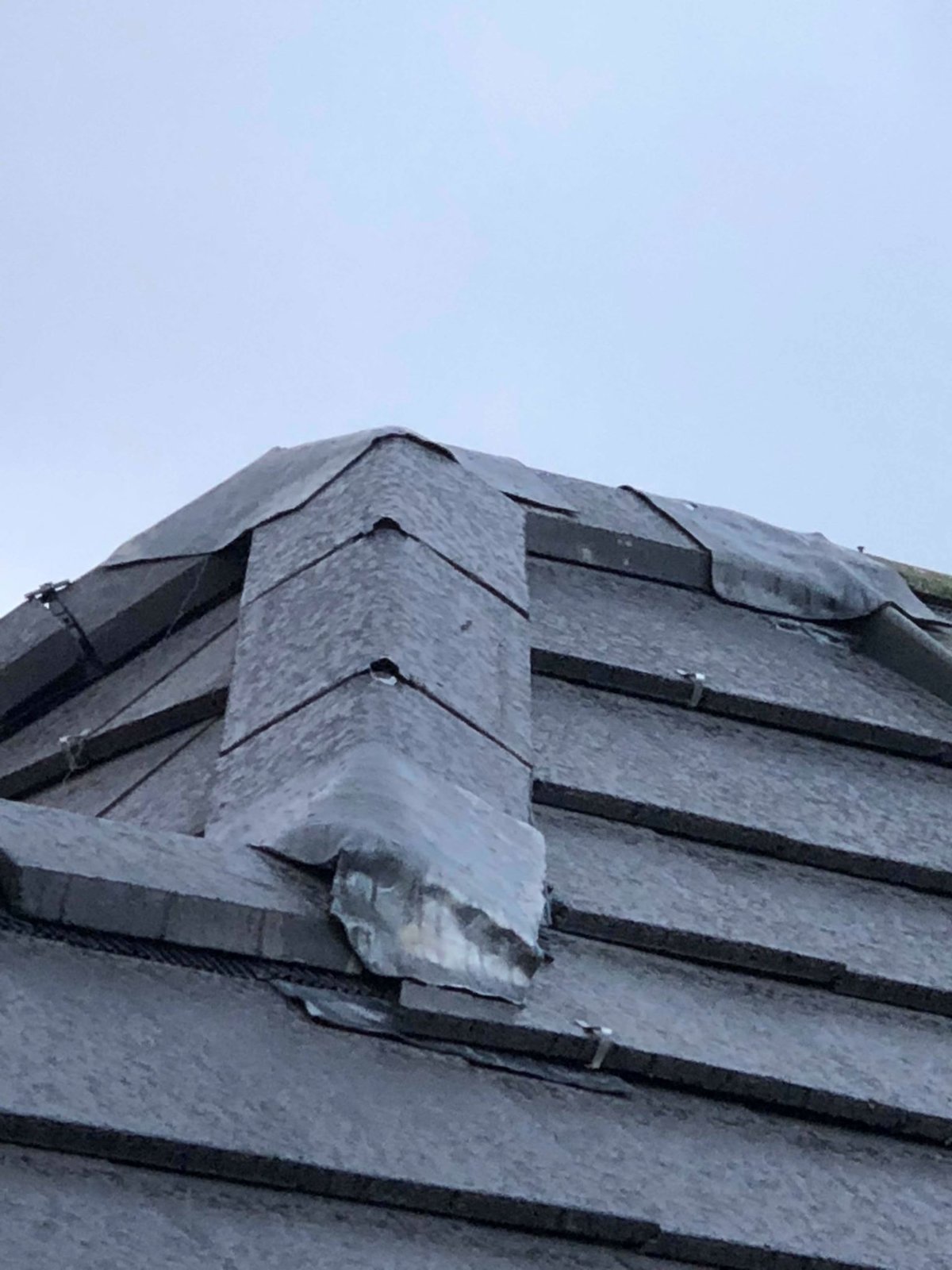

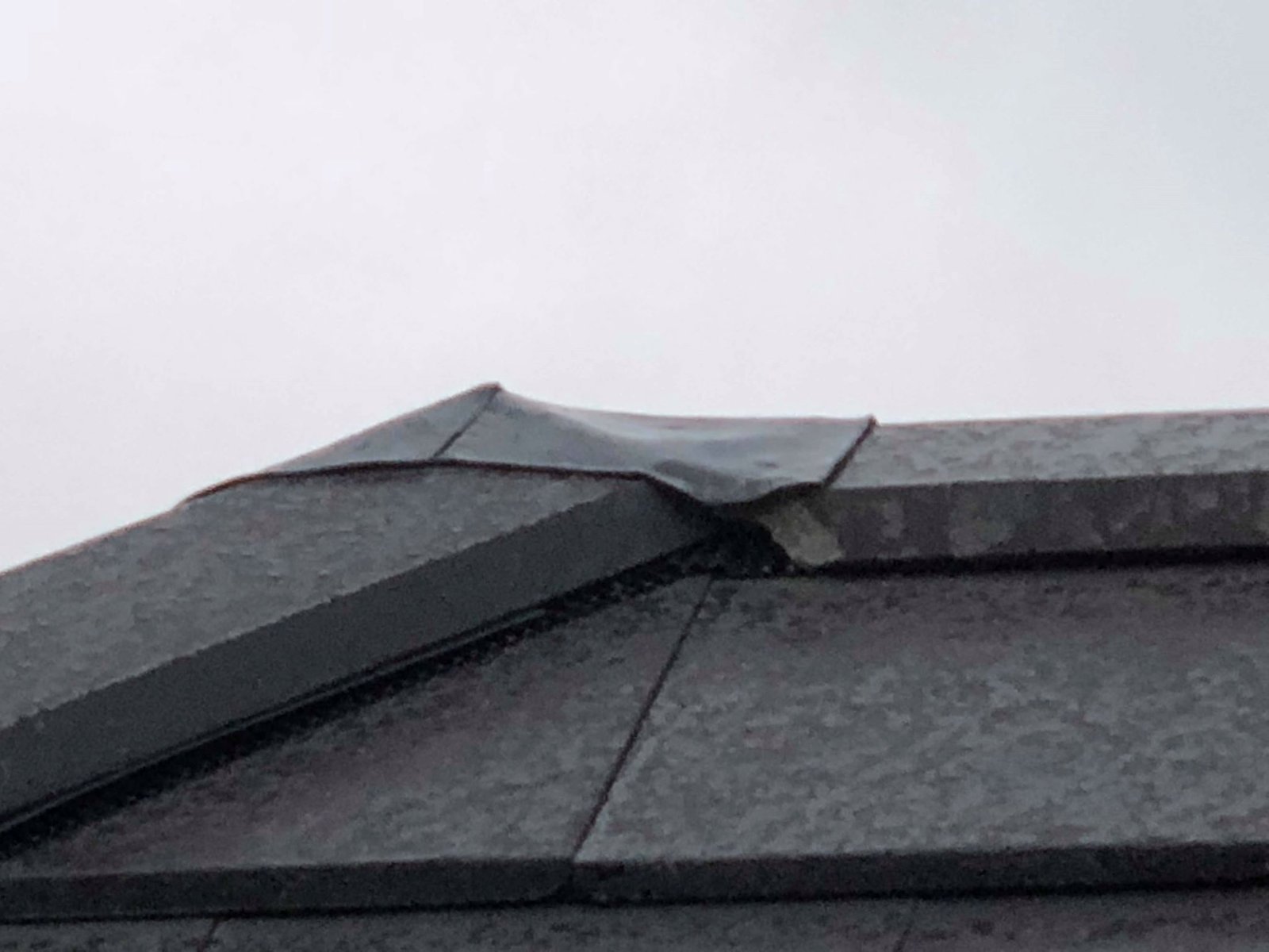

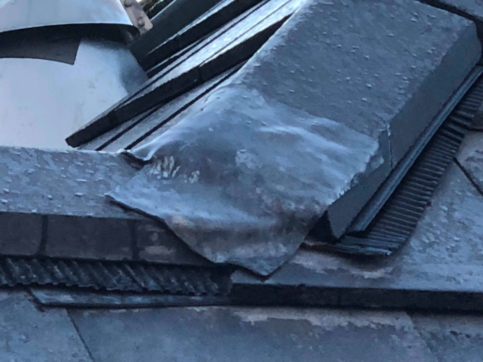

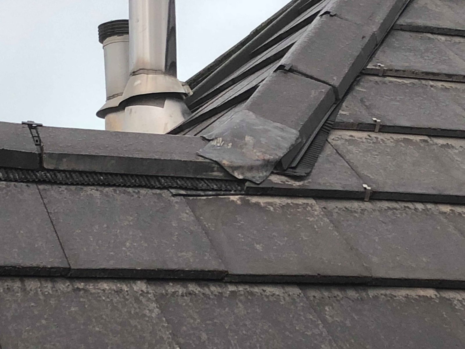

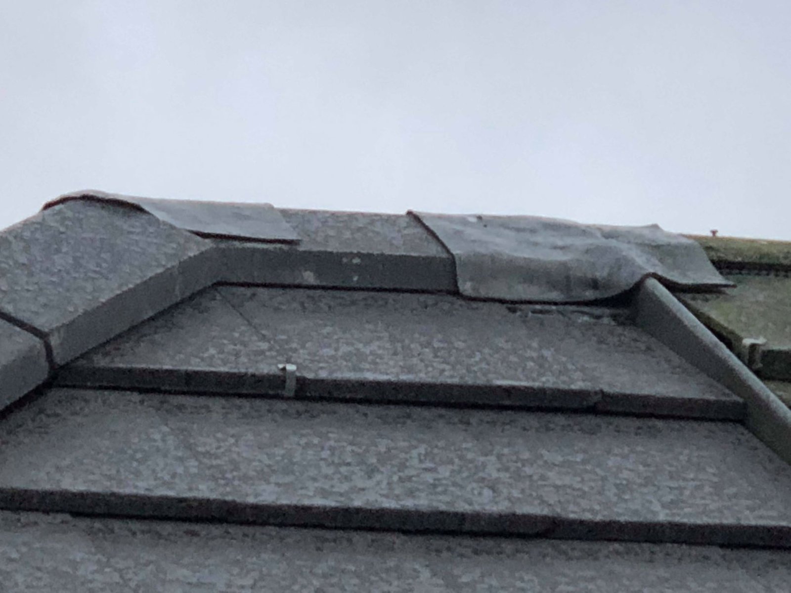

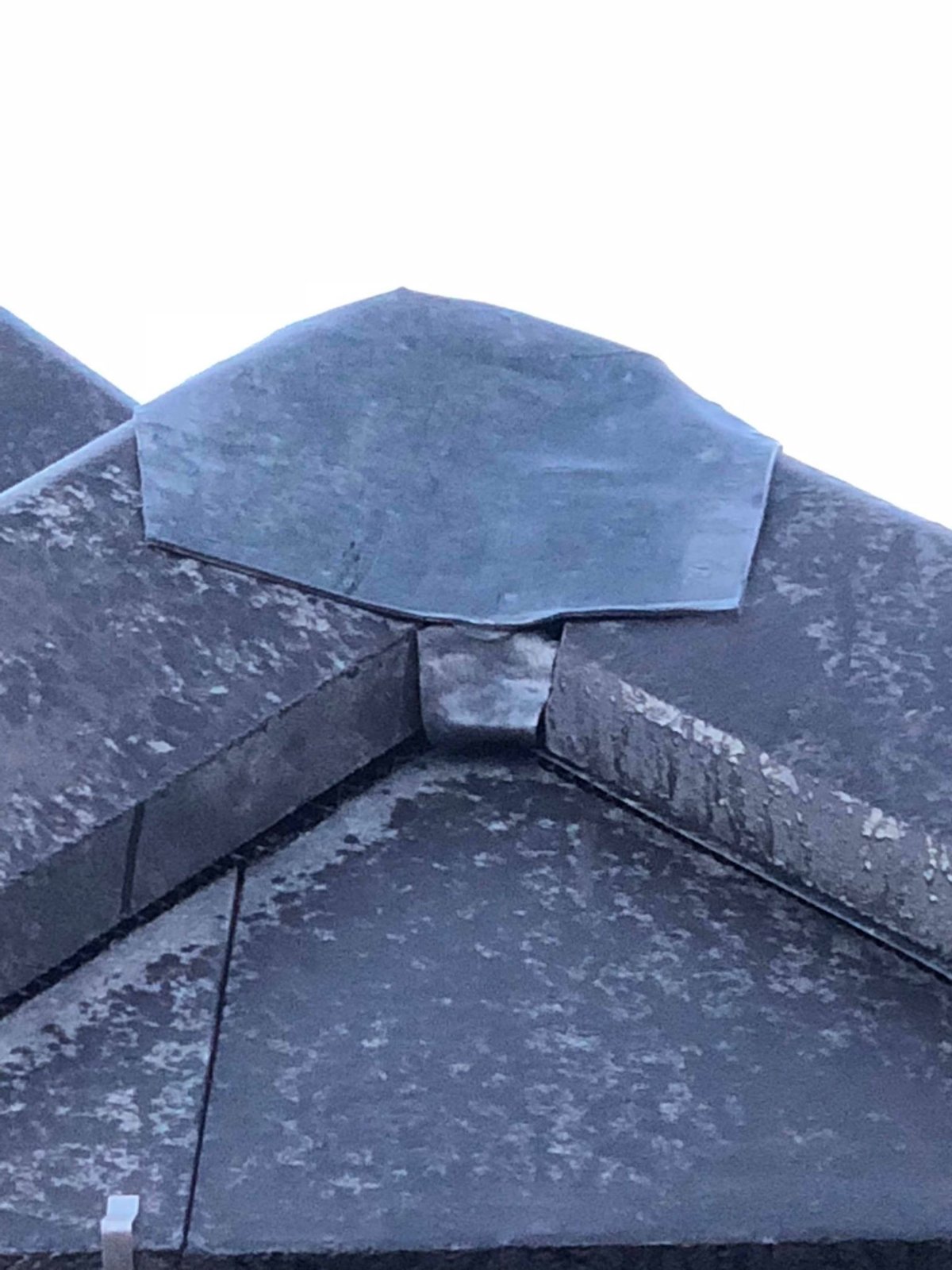

So work had continued this week and despite my concerns I was assured by the company that the methods used by the contractor were acceptable and they would warranty the work.
I've come home to find this today, apparently the job finished....??
28685480_10156001491115575_2470512420414554112_o.jpg 28782603_10156001492445575_7686634456332894208_o.jpg 28782628_10156001491540575_3192859171515006976_o.jpg 28795078_10156001491100575_6036702218155982848_o.jpg 28795244_10156001492755575_6056818011019411456_o (1).jpg 28796001_10156001493145575_2350079724958515200_o.jpg 28870811_10156001491990575_1355246891251531776_o.jpg 28871773_10156001491795575_3802671341304283136_o.jpg 28872758_10156001491525575_1897454111138250752_o.jpg 28870811_10156001491990575_1355246891251531776_o.jpg
Can anyone comment on this, looks awful to me but im no roofer, I need something to go back top them with and any advice on how to handle this best would be hugely appreciated :(
The Lead work is terrible , and I doubt the rest is much better if properly inspected.
