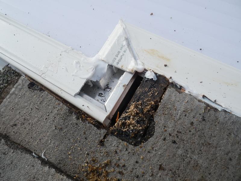

I have just installed a conservatory and, as the photos below show, we have a dodgy joint of the roof with an existing flat roof. The latter has that bituminous felt and the photos show gaps and a first attempt to put silicone in the joint, which I doubt will be enough. Should we add roof felt across the joint, glued to both the conservatory and flat roof ends? The photos show a piece of felt that we kept from the portion of the flat roof that we removed to install the conservatory. Also the conservatory roof slopes down whilst the flat roof does not have a slope.

It can be done neatly with some torch on cap sheet/felt, stuck to the plastic trim and onto existing shed roof.

It is my own roof. I was not going to use the torch thing on the UPVC of the conservatory, for obvious reasons. So, to answer my own question, I bought felt and used the type that you can fix with an adhesive as sold by B&Q

You should have engineered an upstand where the two roofs meet, one higher than the other, then a proper flashing could have been installed, anything else is a bodge. So you'll have to bodge it as cotswoldbuilders has suggested, nowt else can be done now.
