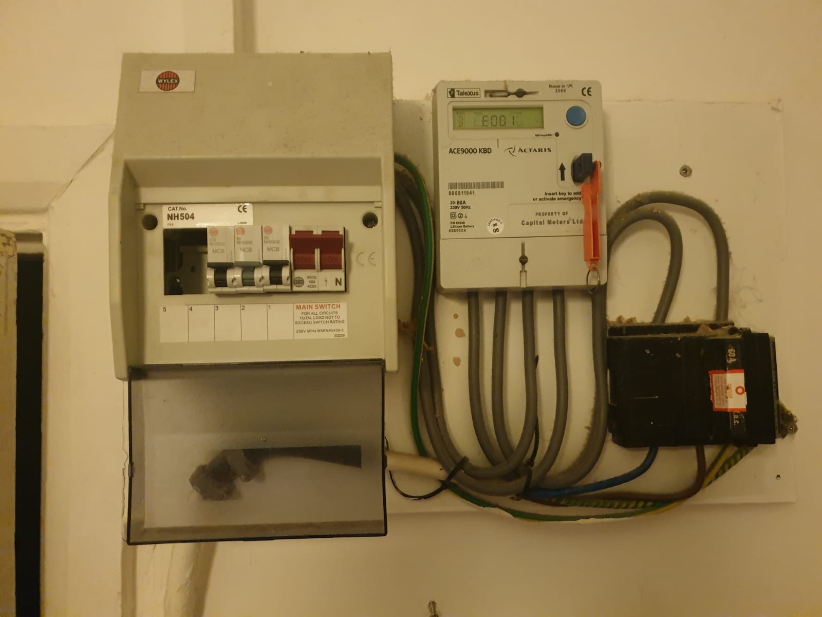

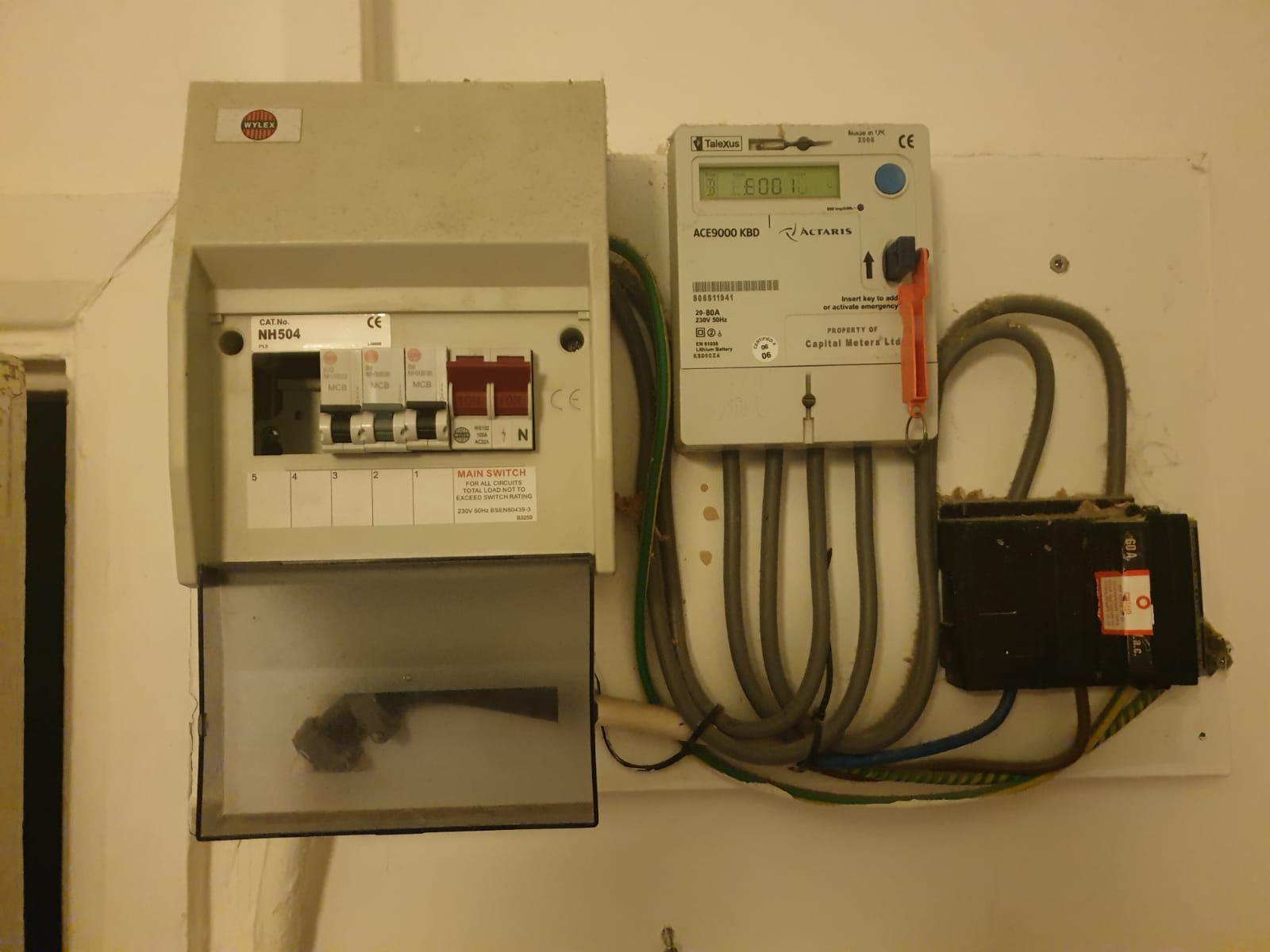

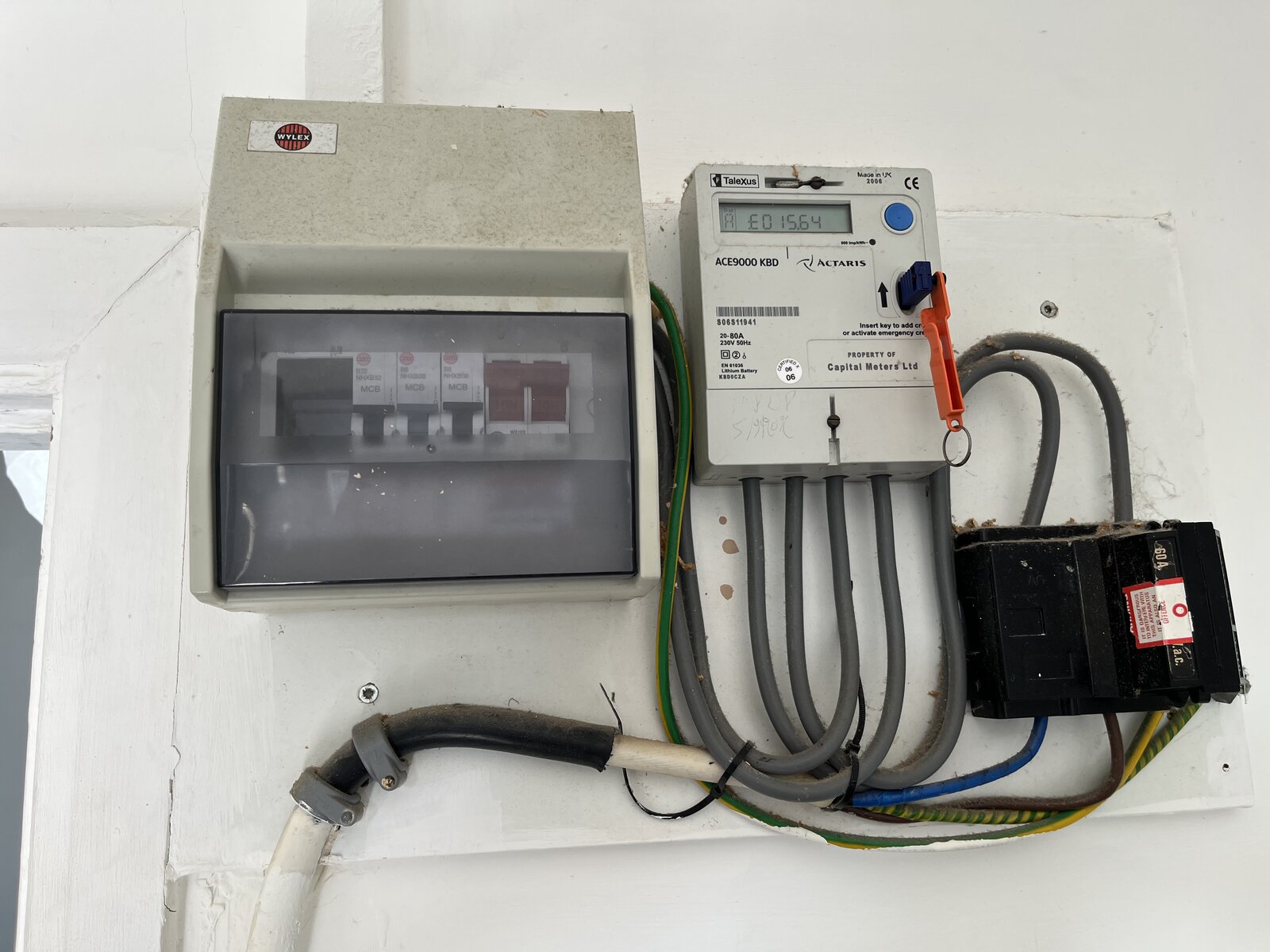

Basically my mate wants to add a electric cooker in the property. (House converted in to 2 flats). All gas is getting removed and he wants to put in an electric cooker.
Would he be able to install a cooker ? And what size would work best?
I have included pictures below
Just to note These are previous photos he had, I know about the empty slots in the consumer unit and they have already been filled with blanks.

No he wouldn't be able to install a new cooker. May I suggest he has the electrician run an additional cable for a cooker when he rewires both flats. It's 30 odd years old with no RCD protection. With no gas supply, an electric hob and oven is going to be a dedicated circuit for the cooker. You won't be plugging it in using a 13A plug and socket like some ovens use.

No, his ELECTRICIAN needs to run a big fat CABLE from the NEW consumer unit (fuse box) with supplied RCD or RCBO. The electrician will tell or supply the correct size of cable depending on cooker size, distance from 'fuse box' and other factors such as insulation around said cable. Both of these flats will need the same and usually will have separate meters also.

EDIT: Just noticed, you only have a 60A service fuse, so the other flat will have it's own separate meter for each flat. No gas supply will mean you have electric showers. You won't be running 2 showers and 2 electric cookers PLUS everything else from that 1 supply without issues for 2 properties.
Incoming supply requires improvement, as it looks like SWA with the armour not connected, bedding exposed and single insulated conductors with tape on some of them.
Consumer unit has no RCDs for anything. May be possible to add an RCBO for a cooker, but many other things need to be confirmed first.
