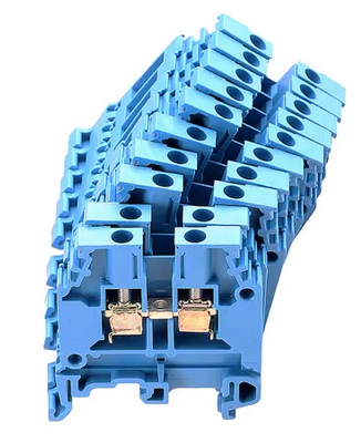

In commercial I have made up many panels, in the main using DIN rail, and terminals like these 1653983358711.pnghave link bars to connect them together and form a terminal block. Although could be used in some CU's it would take up space normally used for MCB's or RCBO's so not a normal practice.

Either a larger neutral bar or an additional one. The new or replacement neutral bar must be obtained from the manufacturer of the consumer unit, and be designed to fit into it.
