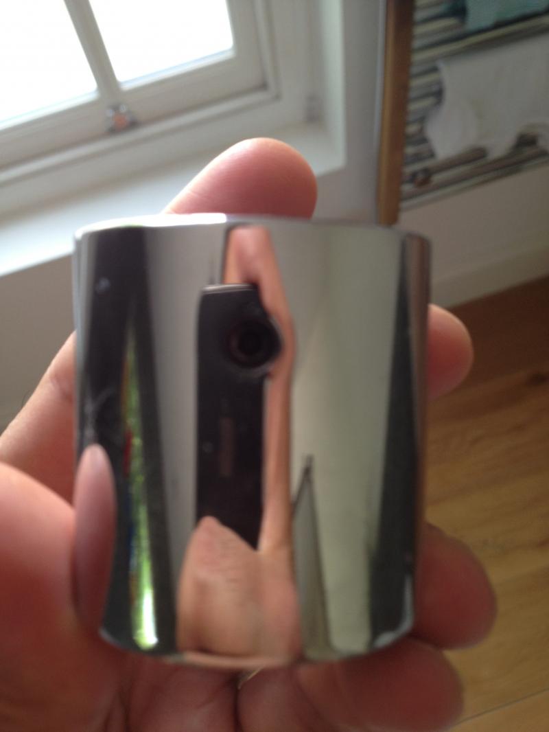

In my bath there is a tap that's connected using a pin, that pin is missing and I'm not sure what's it called or what to search for online.
It looks like a very small octagon shaped pin, probably around few cm long that can be screwed in using proper hex key. I've attached photos which I hope would help someone resolve that mystery for me
Thanks!
It a bit difficult to see, but it looks like an ordinary hexagon allen grub screw (screw without a head).
I don't get the octagonal bit though?

Thanks, sorry meant hexagon :)
Looking on images on eBay I think you are right that's the one I need but how can I tell the diameter I need it is very hard to measure...

Ok so I got the hex set and I can fit the 3mm in (4 is too big already).
Given the responses above I'm assuming I need M4 but when.I search online some say that 3mm key actually works with M5 not M4...

We are talking about the hex key size that fits into the hole, I havn't bought the grab screws yet as unsure on the size (M4 or M5)...
Correction: I just unscrewed the other tap that has the exact same hex screw using 2.5mm hex key. So, I suppose I need the M3 one as these don't come in half sizes right?
As a general rule, and these need not be specific - a 2mm allen key fits a 4mm grub screw, and a 2.5mm allen key fits a 5mm grub screw.
