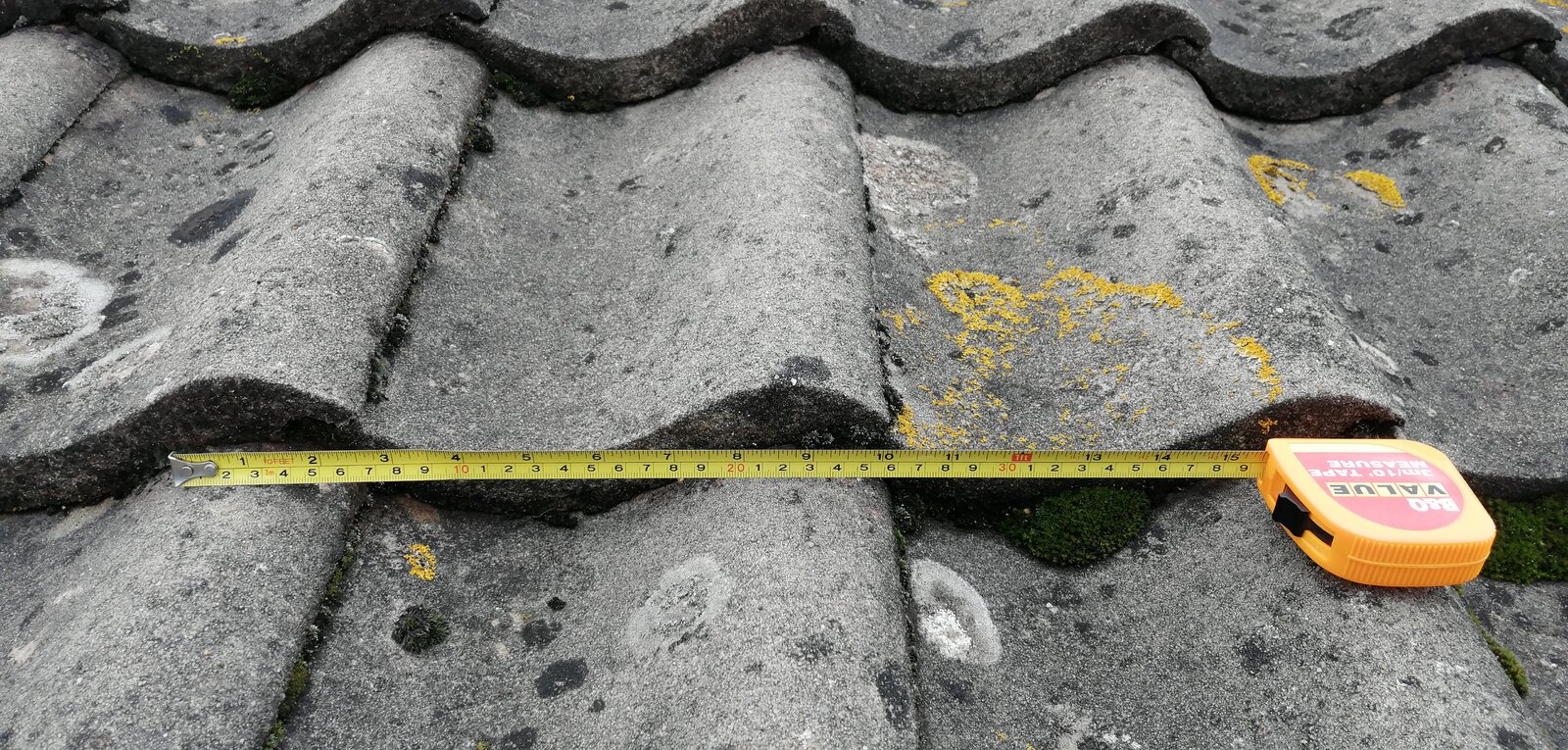

Need help identifying roof tiles

I need to order some roof tiles but have no idea what I'm looking for. Would anyone have any idea what I need to be ordering please? Pic attached

Concrete pan tile
Fenland or anglia come to mind
If all else fails push two tiles next to each other up remove the tile underneath these and there may be a manufacturer's name on the back of the tile.
Thank you will give that a go, based on what I've googled thanks to your information Redland 52 seems to be the one. But I'll do what you instructed on the weekend weather permitting and report back.
